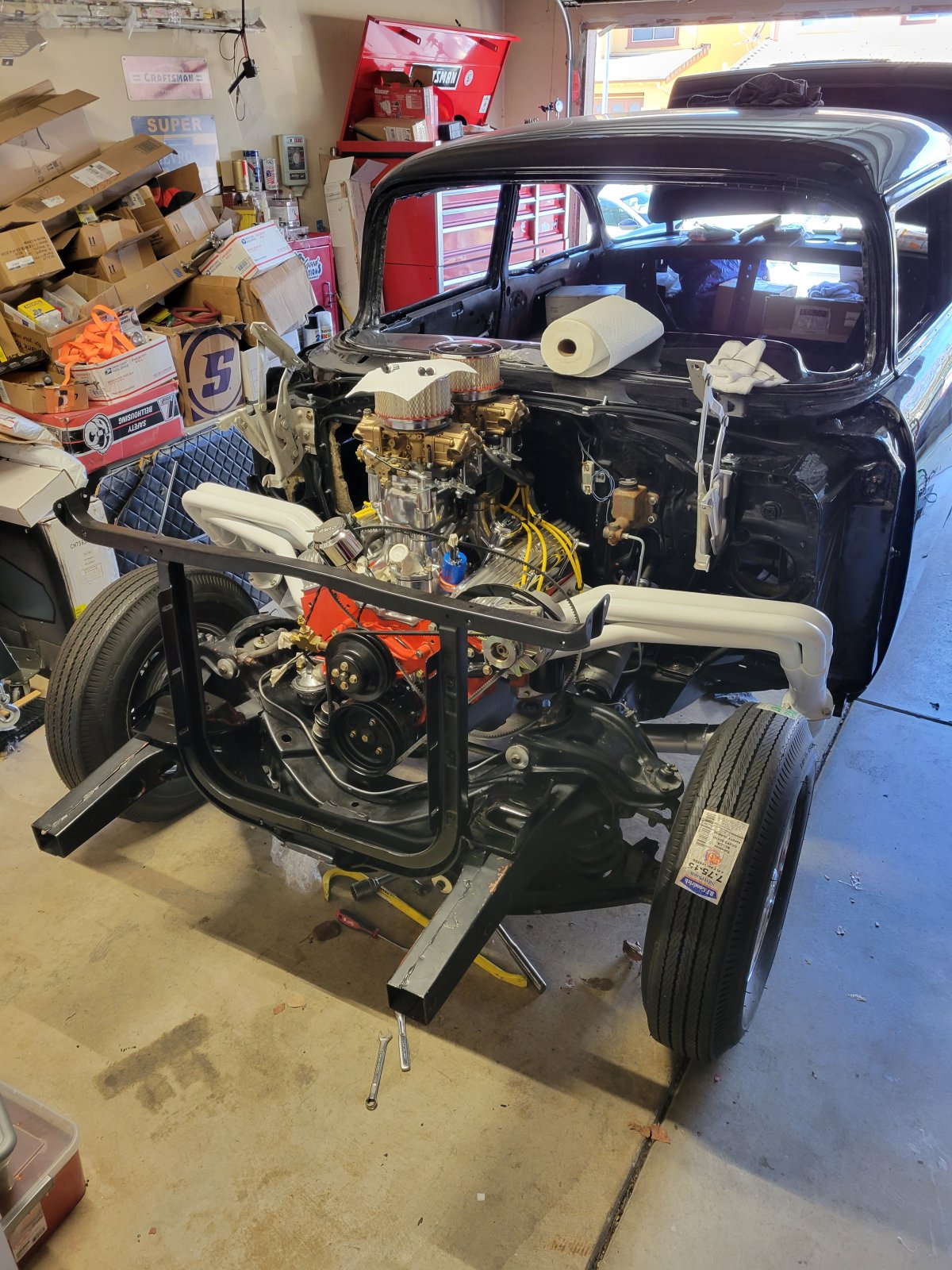

    For my home made tri-power I took the easy way after rebuilding the carbs with VHT Metal Tint #288.
    anthony myrick likes this.

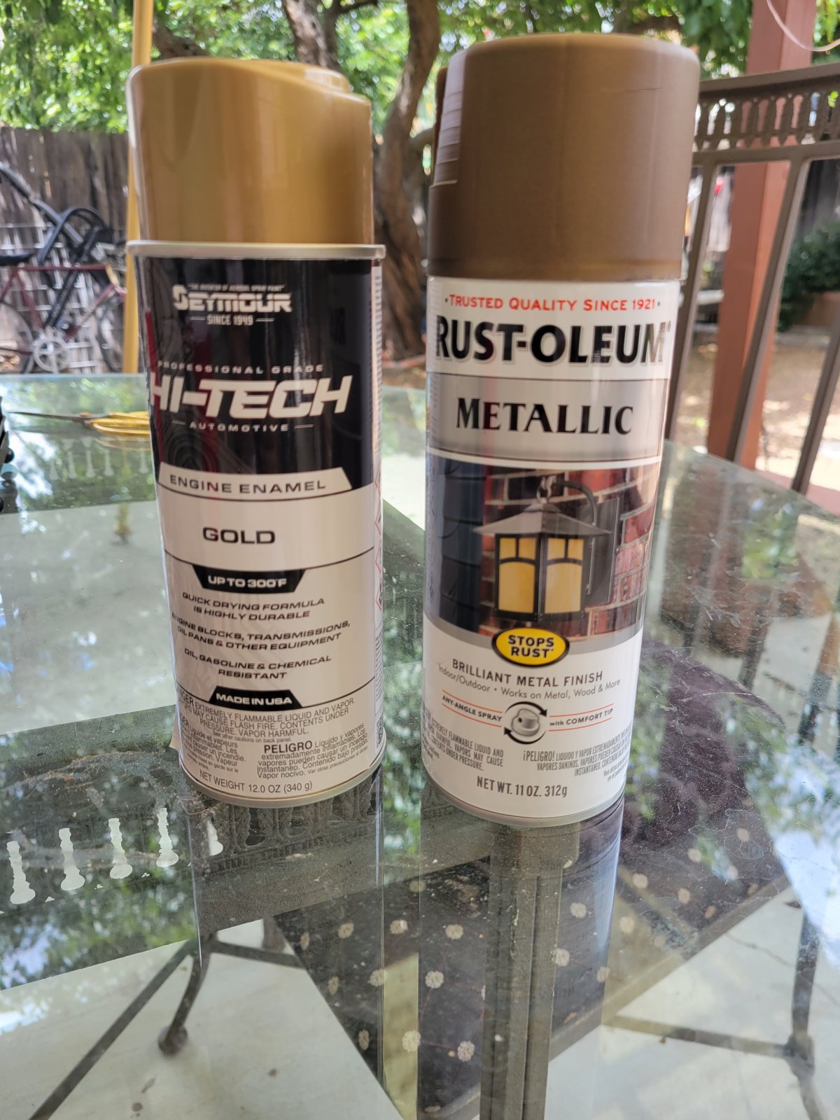

  5. I used these 2 colors, should have fogged in some green too, 20220605_142845.jpg 20230122_111020.jpg looks ok to me
    BOSTONCAMARO, Deuces and Blues4U like this.
  6. Thanks, I have done similar, fading, fogging of color to get the right look. I will do the same for my carb project, have done gas tanks, brake boosters in a similar fashion.
    Great pics, thanks for posting!

    Those carbs came out fantastic. How did you use both colors at once? Was one a base coat and another a topcoat?
