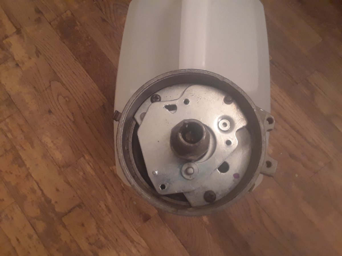

    Johnny, the points plate pivots on a single pin in these, instead of rotating like we Ford fans wish it would. So the point gap varies from the static setting when it does. I about fell over when I saw it happen on my dwell meter last summer. With some creative fine tuning on the actuator arm, and limiting vacuum advance as much as one can stand, it can be minimized somewhat. Just a really screwy design.

    This needs some explaining. What I mean is. How can dwell change be good?

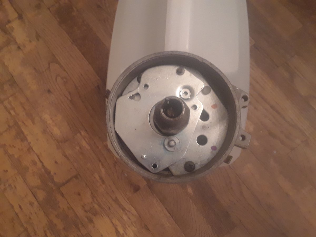

    Well hell, after that midnite run I'm gonna post mine too. The pivot point is at 6 oclock right under the cam. :) A worn plate will aggravate the issue, but a new one will not eliminate it. 20190215_223508.jpg 20190215_223546.jpg 20190215_223522.jpg

    The acceptable limit is 6° of dwell variation when distributor is put through the paces on a distributor machine, at least the spec in the manual.
    More likely these days are faults in the distributor shaft - end play, most distributors are going to be loosey goosey by now with well worn bushings. It's easy to check (if the advance mechanism or distributor cam is removed) by wiggling the distributor shaft end, basically no play is allowed. Put the point block arm on a lobe and watch. The point gap changes, it's toast.
    This can be seen with an ignition scope too, the bushings wear in an egg shape pattern, and the display will shimmy around like an out of balance washing machine.

  13. New breaker plates seem surprisingly available, at least for some model distributors. And for the most part they don't seem horribly spendy.
    https://www.bing.com/search?q=distr...-25&sk=&cvid=08974ECE5A674DF99847F88C68FC365C
    The plates that pivot concentric with the distributor shaft usually rotated on a separate bearing or at least a bushing to keep their movement smooth and centered in the housing. And when they moved it didn't affect the dwell unless they were badly worn.
    The plates that pivoted on an offset pin also moved the points further from or nearer to the center-line of the cam, which affected dwell even when new. This made it more critical to accurately set the point gap, or dwell, to allow for this small amount of built in "drift". And of course changes in dwell also causes changes in ignition timing.
