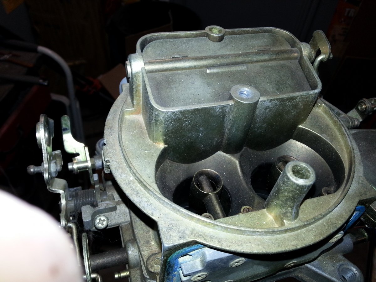

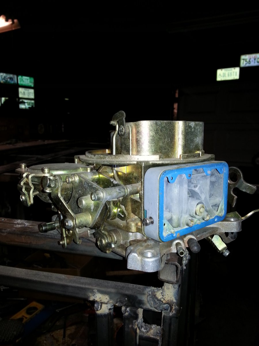

    I bought a used carb it's like a Holley 4160 or 4150 it has no Holley markings or ID numbers it's a dual pumper with a fuel block on one side and a metering plate on the other! Can anyone give me some information on this carb?

    Your pictures don't show the tell tale stuff.The boosters installed are old style. Are the float bowls center hung? Is the fuel feed connected to both float bowls or just the primary with a connecter tube to the secondary bowl? There should be a list number and possible date code stamped on the front of the choke air horn. It has a manual choke and vacuum controlled secondaries.

    That looks like one of those Chinese Knock Off carbs that were going around a while back. can't remember for sure, but I think it was ProComp who was bringing them in

    yep Proform knock off , A Holley would have numbers cast into the side of the venturi box

    Its a 650ish Holley 4160, vacuum secondary that has been 'upgraded' with newer bowls and dual feed - it is not a double pumper. The floats are 'center-hung', fuel crossover tube eliminated.
    This carb might have been one of the Holley 4160 that originally came without an adjustable needle & seat, you had to bend the float arm. A pita to get right. The bowls on it now have adjustable needle & seats and sight gl***.
    For a rebuild kit you'll have to get a high quality 4160 kit from AED, and others, so you'll have the N&S and the right gaskets, if you get a kit according to the carb numbers found on the right of the choke tower you'll get the stuff intended for how the carb used to be before the new bowls.
