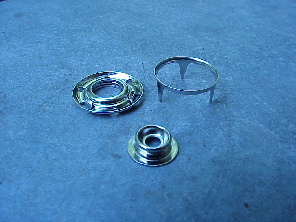

    I usually hold them down with the sill plate. If they need to open I bind a slice under the seat and use Velcro. If there isn't a sill plate I bind the edge and use Velcro. You can also get carpet snaps like these

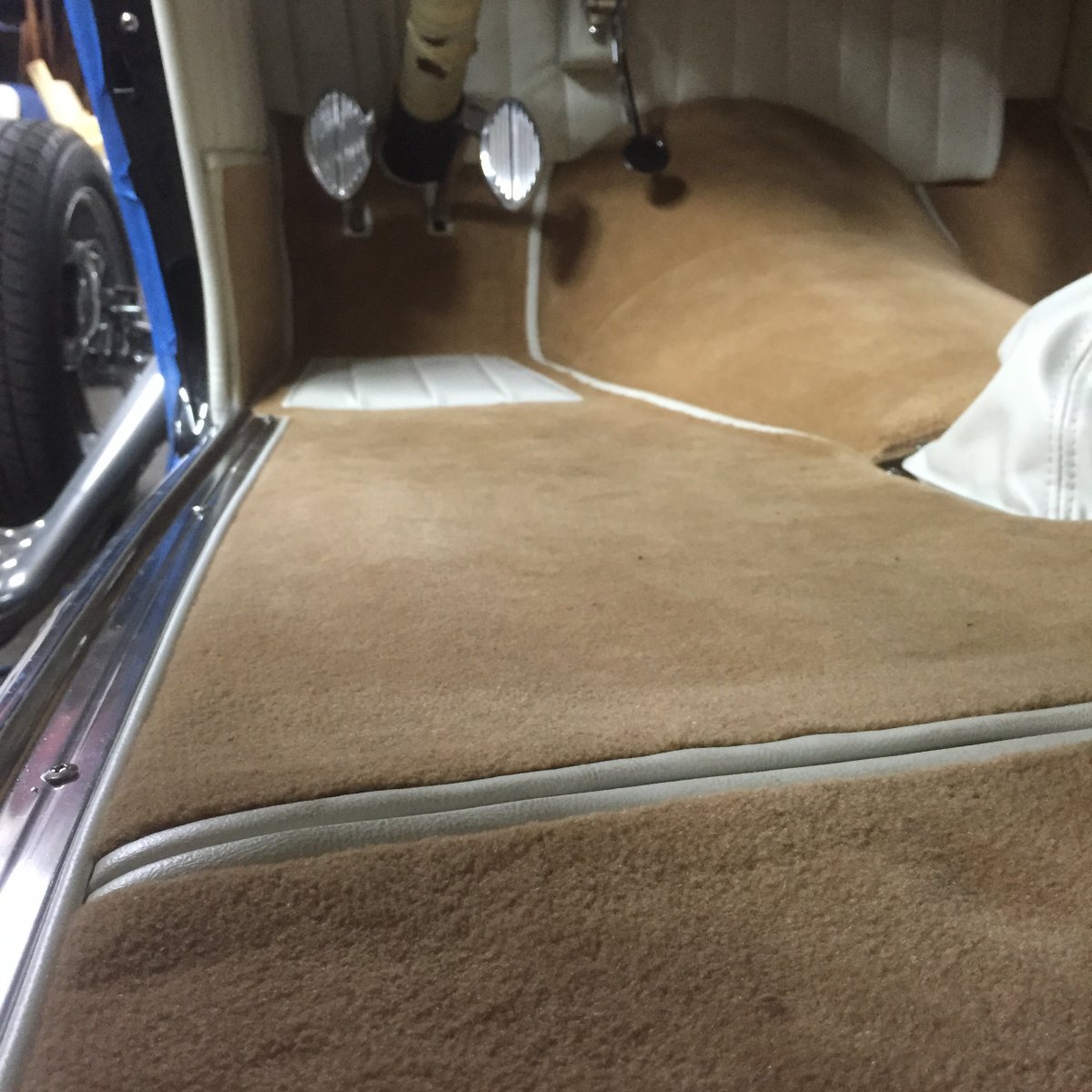

    I did mine. Couple of things. To make carpet patterns get some clear plastic sheeting. Lay it out, and you can see the floor thru it. Mark it with felt tip . Also mark seat mounting holes, belt mounts, shifter hole, etc. I used snap, similar to the ones above for driver mats. Needs to come out for master cylinder access. You can't get carpet under a 32 sill plate, so it will have to be glued or snaps.

    Greg, thanks for the pics of your interior and thanks for the suggestions re the clear plastic sheeting. I wouldn't be opposed to using some spray glue on the edges.
