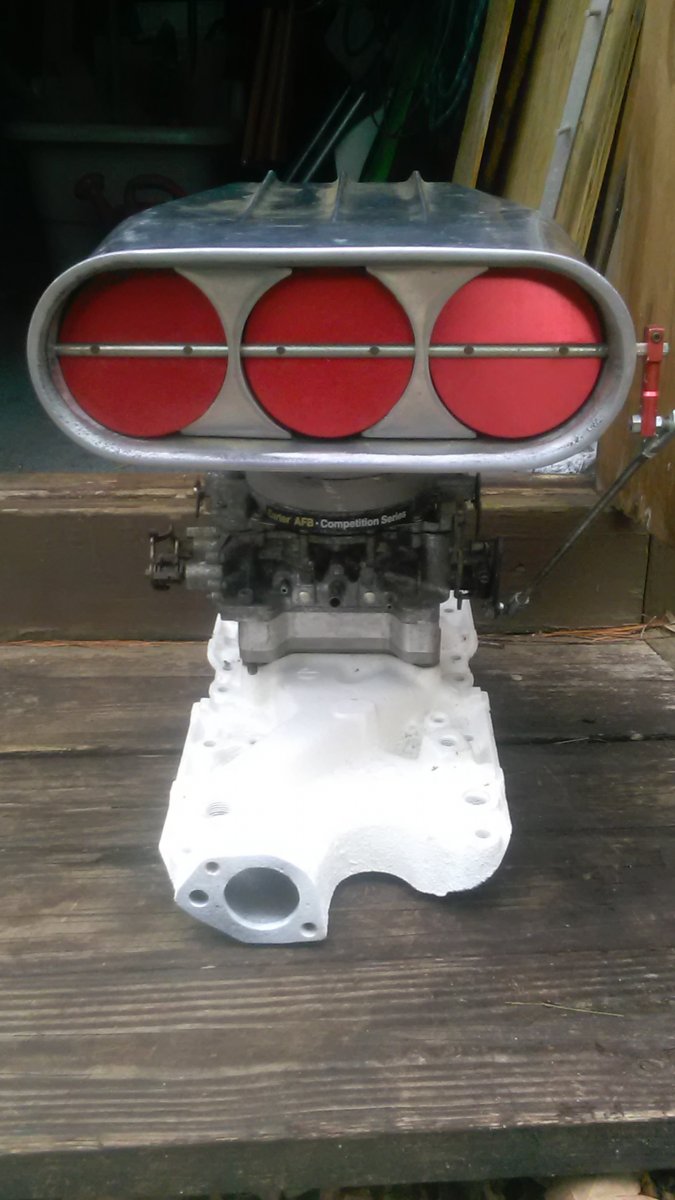

    Question on an older Carter Comp Series carb. I need to know if this is a full-time vac port on the front of the carb (see arrow). Thanks.

  2. Blow air into it, and if it comes out below the throttle blades it's manifold vacuum; above would be ported vacuum. If you're looking for a place to connect your vacuum advance, you want manifold vacuum...

    That vac port does not work at idle. I ended up installing a 1/2" spacer & added a nipple to it

    Interesting picture!
    The OP states that he has an older Carter competition series carb; and indeed the stamped number APPEARS to be 4758s, which is the number for a 500 CFM carb with a MANUAL choke. The picture clearly shows an automatic choke housing???

    Good eye.
    I've since removed it & installed the original manual choke linkage & shaft
    Here's the front carb.
    and the pair together....
    The 500's were a little small on my 455 Olds though.
    http://59chevypickup.webs.com/photos/undefined/0004a.jpg
    Hopefully they will be ok with my new tunnel ram 355 SBC

    TJ - for a strong street 455 Olds, try a pair of the 4759s 625 CFM. As you probably know, Carter did not release a "no choke" version of the 625, as they did with the 500 and 750 sizes. However, it is very easy to remove the choke and plug the holes with aluminum drive plugs; or do as I have done on my very strong Ford 390, use chokes on both. For street application, I really believe chokes on both are preferable to only the choke on the rear.
    I ran the cable to the rear carb, and cut a piece of 1/16 steel rod to run from the rear to the front. Both chokes, like both carburetors, run simultaneously (no progressive linkage).

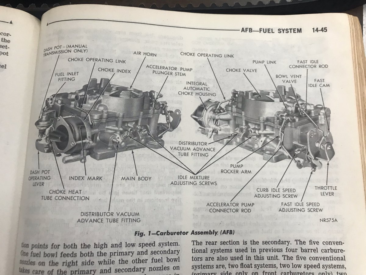

    Actually ( this is gonna start a s##t storm ) the 1969 mopar shop manual states that "tube fitting" is ported vacuum and is for distributor advance on the 2-4 426 hemi, 383 4 barrel, and 440 4 barrel.
