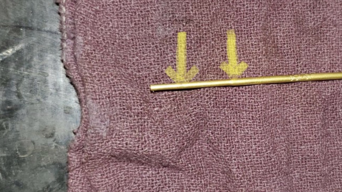

  8. These rods are pretty fat looking (.062 .068) and I'm kind of reluctant to put them back in 20200815_095027.jpg
    bchctybob likes this.
  9. I've never seen rods as stubby as the ones pictured above, so I'm going to guess at 1 of these more typical profiles to put back in instead. 20200815_095940.jpg
    bchctybob and rbrewer like this.
  10. 6sally6
    Joined: Feb 16, 2014
    Posts: 2,921
    6sally6
    Yeah.......I would swap those metering rods out for a set of your other ones. I agree.......(I'm no guru fer sure but) those look like someone ground the ends off flat!
    Try different springs(prolly lighter ones) especially if it has a fairly snotty cam.
    Twist in a bunch of initial timing too....just to get it to idle higher, and try tuning from there.
    Let us know what happens.....

  11. swade41
    Joined: Apr 6, 2004
    Posts: 14,491
    swade41
    from Buffalo,NY
    Do you think the tip of that metering rod is broke off inside there ?
    Did you ever close the throttle blade gap to get it back into the idle circuit ?
    If you go on Edelbrock's website they have a tuning section, you can print out the tuning manual, figure out what size your carbs are and cross reference it to the Edelbrock to get a base jet, metering rod and spring.
    Always pull the metering rods before taking the top of the carb off and always put them in last, leaving them in while you take the top on and off will bend the rods and also break the tips off like those ones you show.
    ClayMart and rbrewer like this.

    Never seen metering rods that were pointy on the ends. I mean on the very ends. From what I remember the tapered part of the rod is what controls the flow. Right? Lippy

  15. The 1st and smaller step is part responsible for controlling flow on the main metering circuit, and the 2nd slightly thicker step controls fuel on the idle circuit when high vacuum pulls that needle deeper into the jet.
  16. Fordors
    Joined: Sep 22, 2016
    Posts: 6,508
    Fordors
    3500B11E-926F-4FE9-B71A-39E1BC0FA5DD.jpeg The photo you posted shows a rod numbered as 16-124 (shown as correct for the 3804S and 3361S) and those have a step of .069 to .0635 and your measurements are very close to those numbers. I see two steps on the rod where I indicated on the photo. Nothing is broken or modified on those rods.
    In reading the thread it sounds like your jets are correct for the primary and secondary sides and your metering rods are the right number so the only other problem area would be the venturi clusters and @ carbking has addressed that. He gave the part numbers and it looks as though yours have inadvertently been switched between the carbs.
    Put the clusters where they belong, back off on the curb idle screw, and get the idle mixture screws set to a preliminary setting, I bet you will be able to get that thing to idle.
