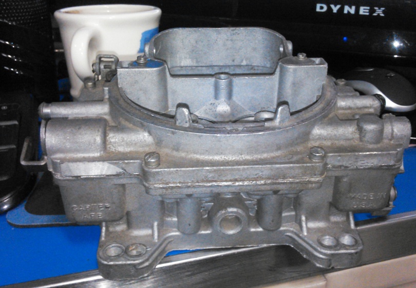

    Trying to find out some info on a Carter AFB I picked up this weekend. It has no stampings I can find, no drilled vacuum ports and the fuel inlet appears to be on the driver's side. There is no choke but there is not even linkage for it. As you can see in the photo the driver side has the inlet with filter casting but the passenger side doesn't. For some reason the accelerator pump linkage is pushing the primaries open. Any ideas what it came off? NCM_0121 (2).jpg NCM_0122.jpg NCM_0125.jpg NCM_0123.jpg

    Secondary from a buick nailhead dual quad setup looks similar

    Look for four numbers on the flange under the accelerator pump. With no choke, one would think it was a factory secondary on a two - four set up.

    someone stuck some screws in the holes for the choke actuator shaft....which means (to me) that it is a choke model carb, that someone removed the choke from, so it's an incomplete carb.

    Yeah thats what I thought on the lack of choke, whoever did it removed all the brackes and linkage also.

    Curious about the driver side inlet.

    only numbers any where on the outside are casting numbers only.

    primary butterflies are numbered 2-253 10deg and secondaries are 2-196 15deg, body has a casting#1673 and top has casting# 1593.

    Looks like a primary carb, with a secondary top. It has idle / mixture screws on the bottom, but no choke on top.

  12. It is for a '64 Max Wedge cross ram. It should have a choke in it. And that's one of the hardest pieces to find. I have a pair and a half. I would like to have it if you would like to sell it. P.M. me. Thanks, Gene.

    Large air horn rules out a lot of GMs. I think it was manual choke I don'r see a vacuum port where the auto choke would have mounted.
