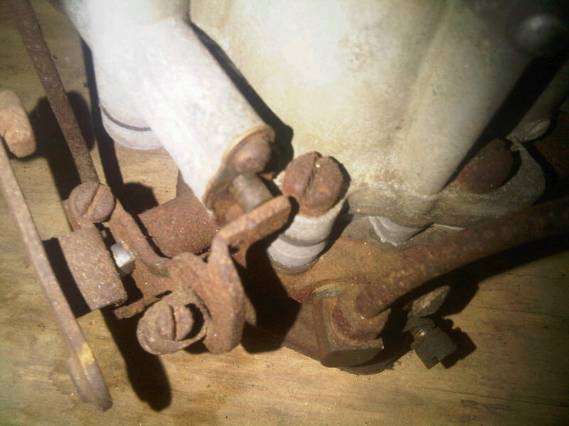

    I finally got my carb installed and tuned, everything works fine accept its leaking bad onto the exhaust manifold.
    The car is a '53 Desoto. The engine is a 251 L-head with the M6 semi-auto tranny.
    Its leaking out of the plunger in the first picture. There is no gasket of any sort going to this. It seems like it is acting as a drain, perhaps the float isn't set right? I'v got to get this fixed before the car bursts into flames.

    Fuel leaking from the plunger would indicate the fuel level in the bowl is too high. Possible causes:
    (A) Defective fuel valve
    (B) Defective float
    (C) Improper float setting
    (D) Too much fuel pressure coming into the carburetor
    Jon.

    You can check the float level just by pulling the top off the carb. No need to remove the whole thing.
    That lever should be the arm that actuates the accelerator pump. It goes up and over, so it sees 'dry'. When you have the top of the carb off - still with fuel in there - see where it is coming from (how the fuel is getting to the vertical channel the linkage goes through). If you remove your accelerator pump. there is a check ball under it - don't lose it.
    If your accelerator pump circuit is plugged, then when you depress the accelerator the fuel is escaping out the top and flowing out. You can tell if the acc pump circuit is working - just look down the carb as you open the throttle butterfly.
    These are simple carbs. Don't be afraid of it. It is just a regular B&B with a couple of electrical switches thrown in - a full throttle switch for kickdown and an open throttle switch for the ignition interrupter. And you can reuse the old gaskets, no problem.

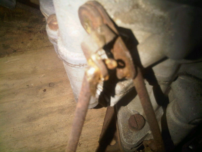

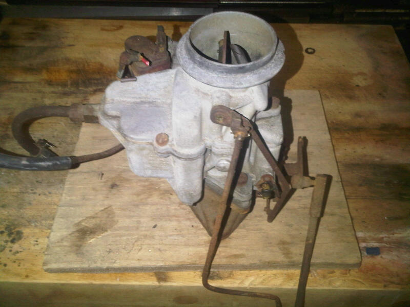

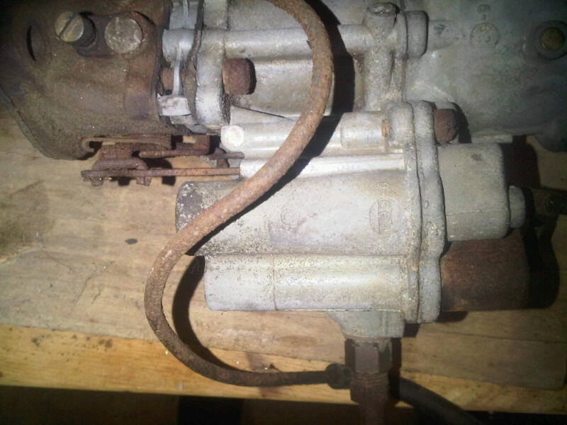

    Here are a few photos of a carb I pulled off the shelf. It clearly is a Carter carb. I was under the impression that this carb came from a MoPar with a Gyromatic transmission.
    It does not have a dashpot. It does have two electrical switches. One is a full throttle switch and the other is a idle switch. Is what we are calling the dashpot the idle switch?
    Or, maybe this is a carb from a vehicle with an OD transmission.
    I once had a 50 Dodge with the M6 and it did not have a dashpot as best as I can recall. Maybe the earlier cars did not?
    In any event, here are also some photos of the underneath and side so that the OP can see where the accelerator pump flat linkage goes up inside. Also, a close-up of where you would attach your manual choke cable.
