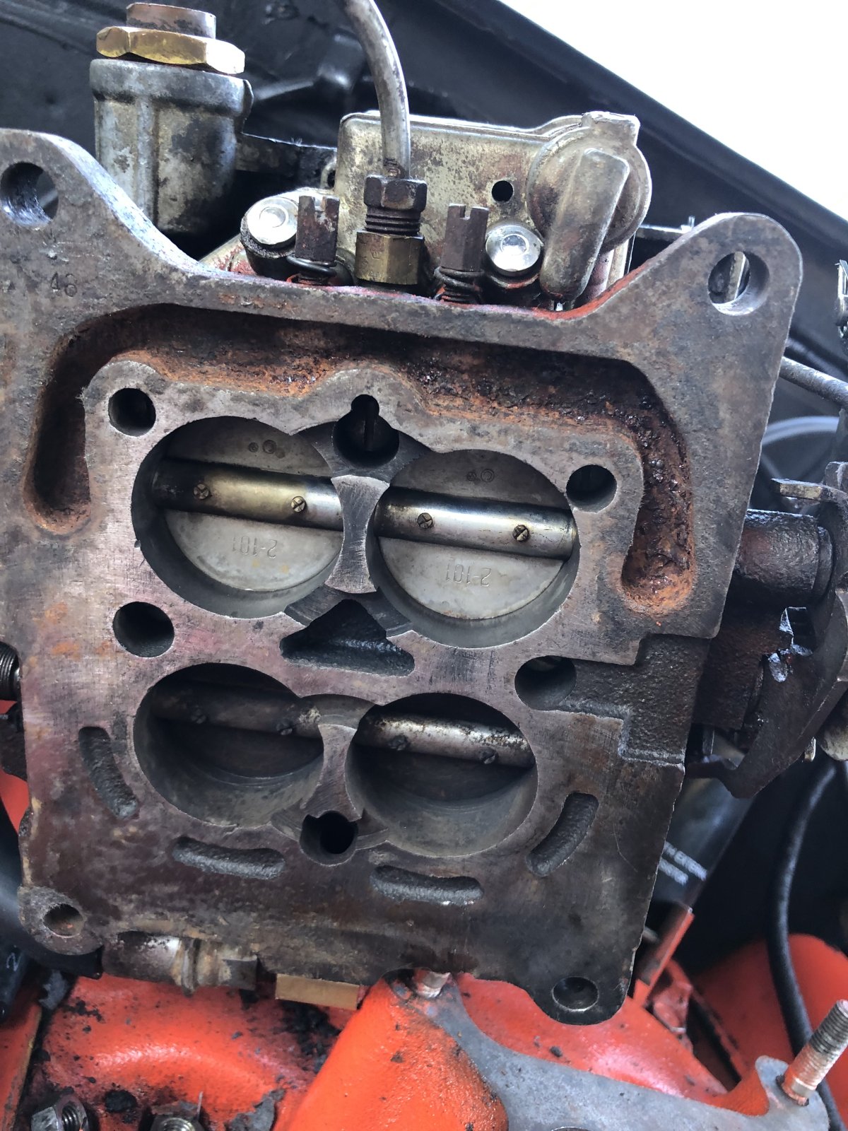

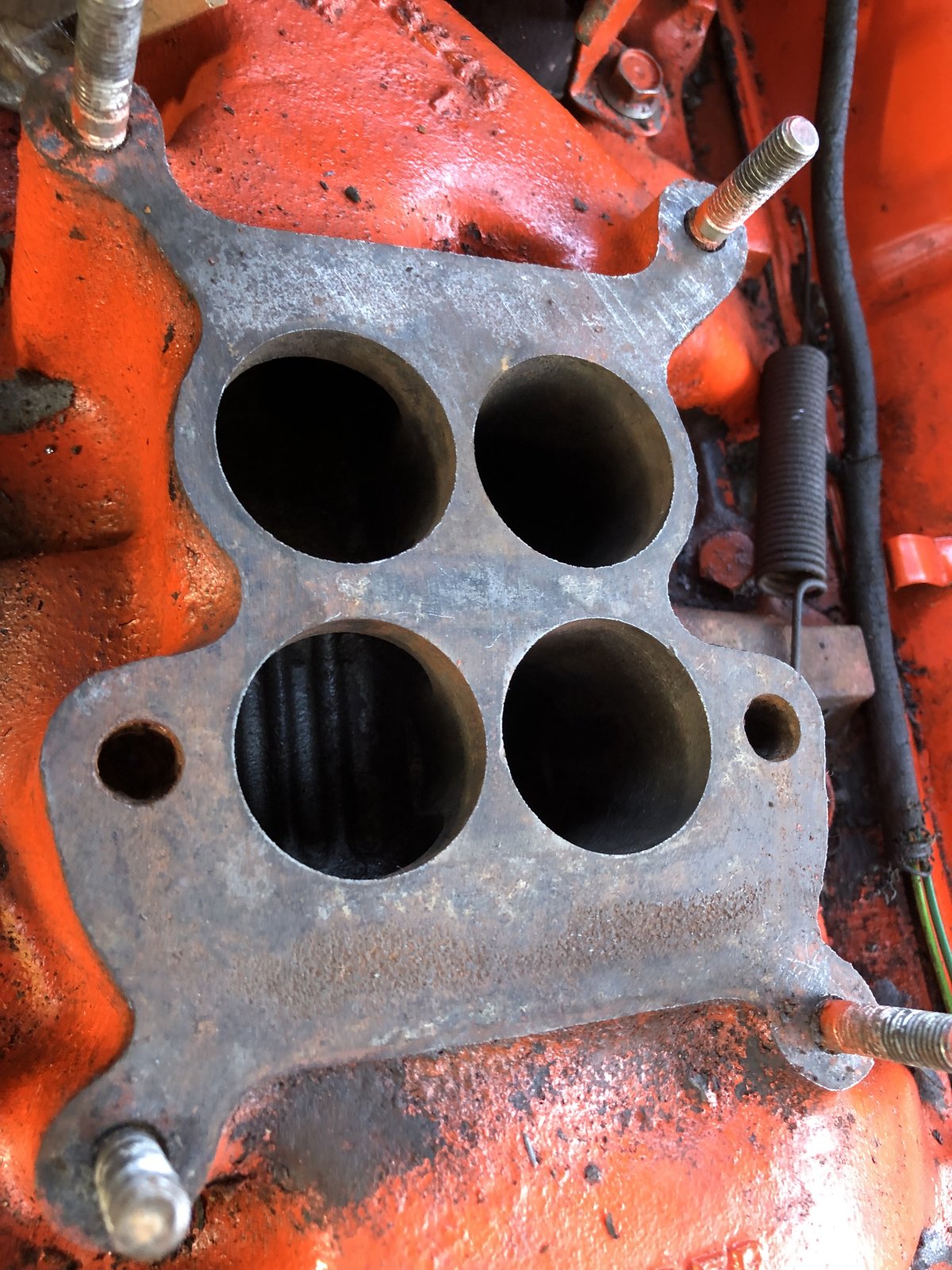

    Hey guys I’ve got a ‘63 impala 327 with this Carter WCB 1672 4 barrel carb. I’m having a hard time finding the correct mounting gasket. Any ideas or suggestions would be great.

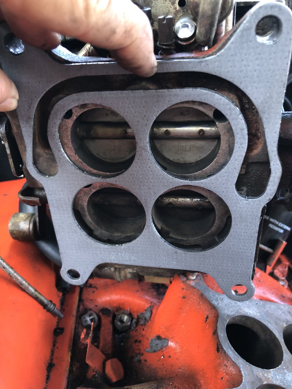

  5. Eth727
    Joined: Jun 20, 2024
    Posts: 310
    Eth727
    I have this already

    Is that normal that the '63 carb has a cast iron base?

    The WCFB used by Chevrolet in 1963 does have a cast iron base.
    The correct gasket:
    Carter 1A-130
    GM 3743282
    The pictured gasket appears to be a modified 1A-119 (AFB) but the hole on the right side is too low; maybe the hole was cut out trying to make the gasket fit something other than the original application.

    Hey guys so yeah my car is a ‘63 impala w/327. I don’t know if the carb or intake is stock but it does work. Maybe one of you guys know more than I do. I ended up buying a felpro gasket maker kit for $11. It has a bunch of different types of materials to make your owner gasket. I made a template with masking tape and cut it out with a exacto knife.
