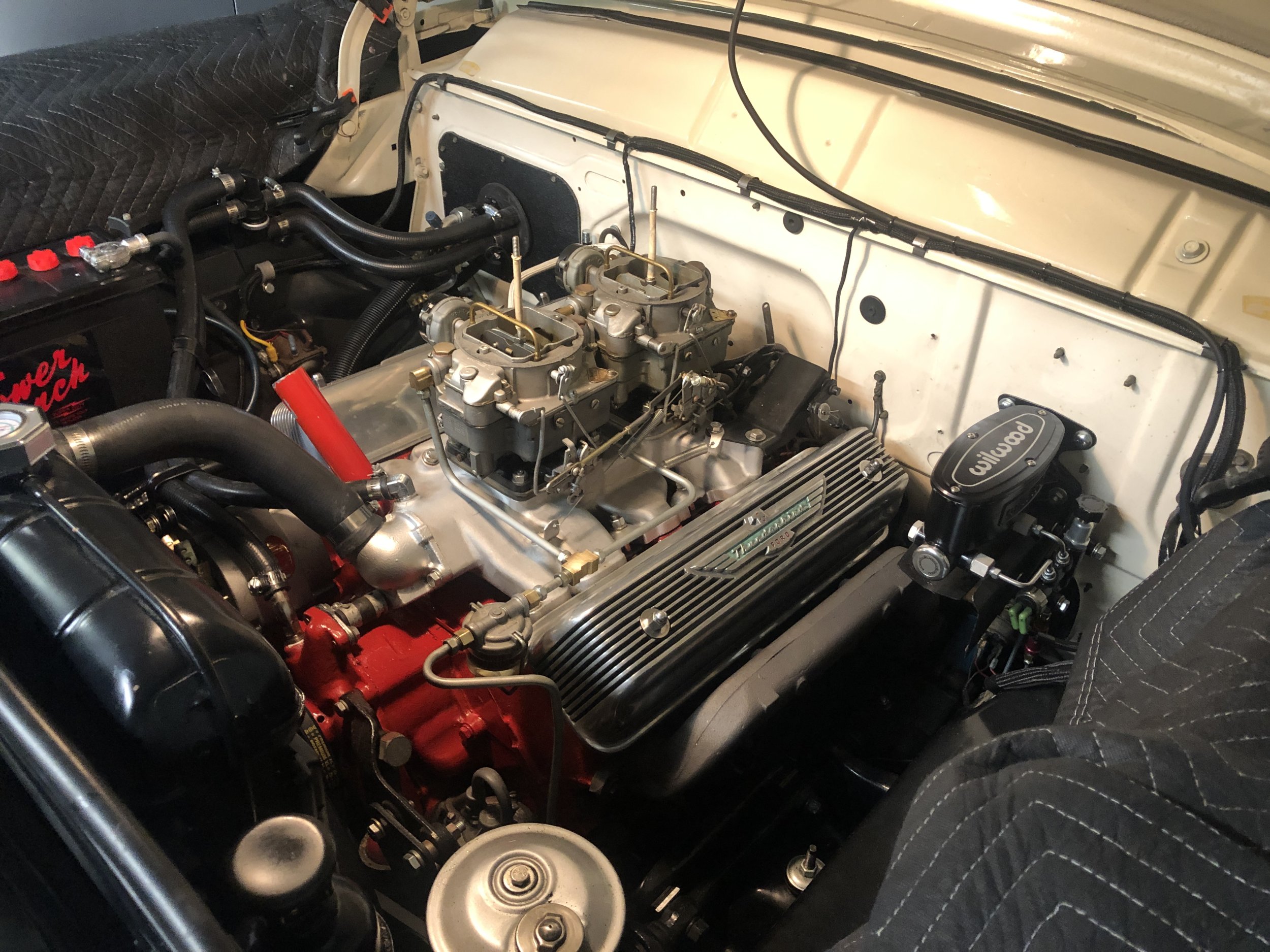

  5. jimmy six
    Joined: Mar 21, 2006
    Posts: 17,230
    jimmy six
    I like them…they are tunable and work great. IMO they need an insulator plate below them because of today’s fuel blend. IMG_4522.jpeg

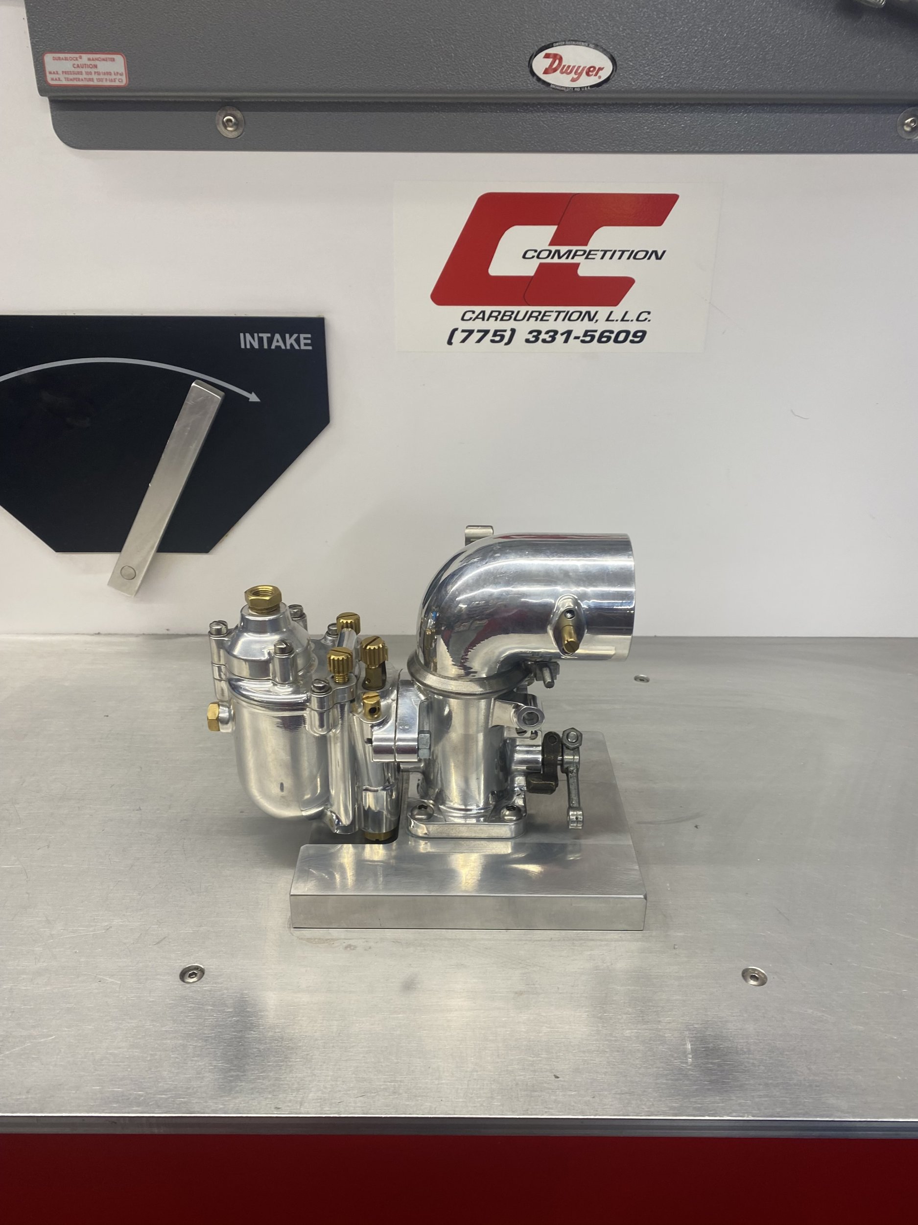

  8. Kevin Pharis
    Joined: Aug 22, 2020
    Posts: 739
    Kevin Pharis
    from Califunny
    I sent the WCFB on my Avanti to a fella that did a beautiful job cleaning it up with new plating and such, but sumthin bout it ain’t right tho. Have plans to send it to Bob at Compe***ion Carburetion in Reno for a tune up. He’s got me straightened out before

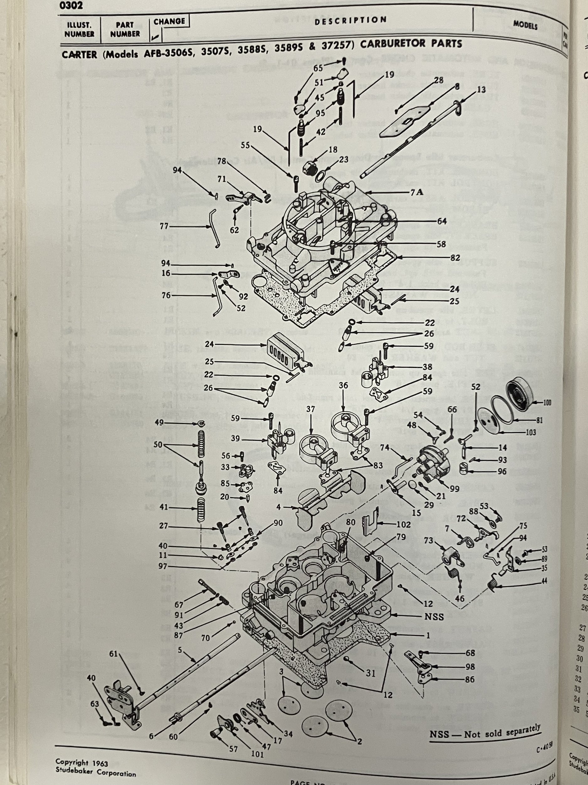

  12. PackardV8
    Joined: Jun 7, 2007
    Posts: 1,328
    PackardV8
    Odd, as all Avanti were originally equipped with the Carter AFB.
    jack vines
    bchctybob and 2OLD2FAST like this.
  13. Kevin Pharis
    Posts: 739
    Kevin Pharis
    from Califunny
    Correct again Jack! Had to go out and check what was on the neglected ol girl. Either way, it’s off for a tune up soon
