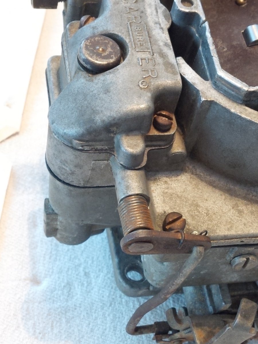

  15. Dose anyone make these springs for the throttle linkage?
    dana barlow likes this.
  16. carbking
    Joined: Dec 20, 2008
