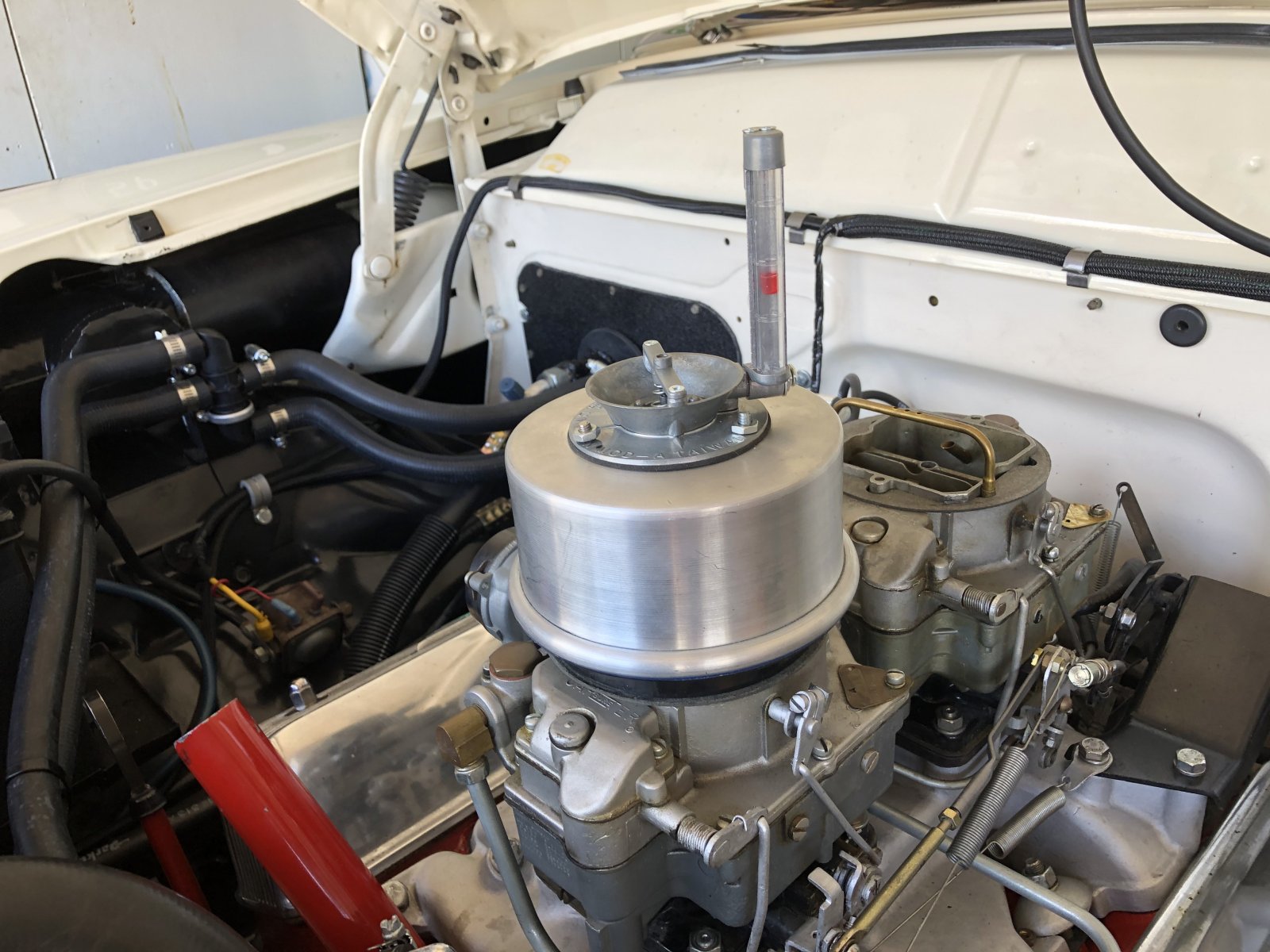

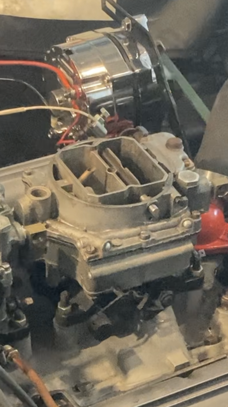

    The ****erflies on the carburetors are shut, the fuel pump is regulated to 4 psi. The gasket seals hood and the linkage is off of the carburetor now. We held the carburetor linkage shut with a spring but still no dice. The carburetor in question is shown in the pictures below. The tag is gone from the carburetor so I’m not sure exactly what model it is. The intake is a stock 1957 Chevy dual quad.
    Thanks,
