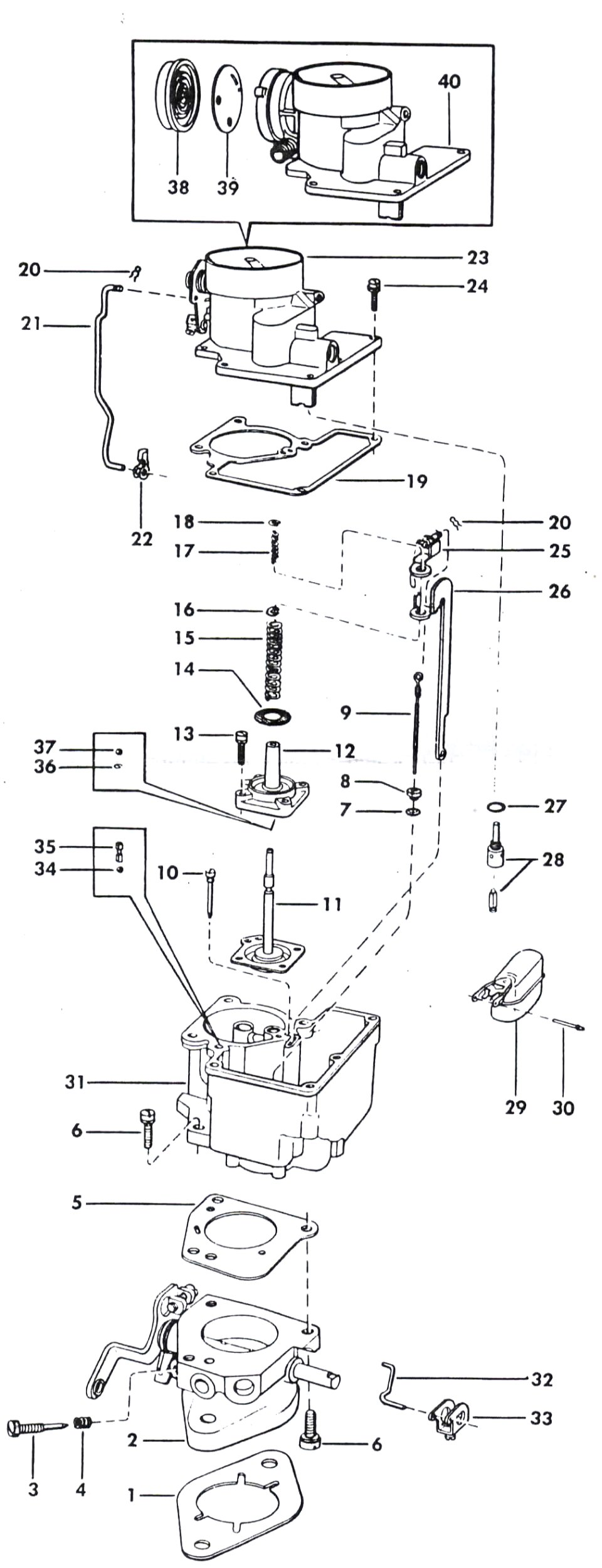

    Using a gravity feed system and still over filling the carb bowl tells me something is way off. If the gas tank is two feet above the carb the pressure would be 0.64 psi I don’t believe that is any where near enough pressure to lift the seat.
    Is the gasket #27 in place?, also when setting the float level did you have the top #23 upside down, the float level needs to be set with the top upside down.
    From @carbking
    https://www.thecarburetorshop.com/Service_Carter_YF.pdf
    Dan
    Budget36 and tractorguy like this.

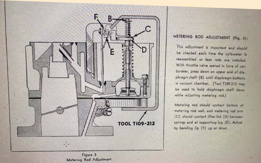

  24. carbking
    Joined: Dec 20, 2008
    Posts: 3,943
    carbking
    Metering rod and jet are correct.
    Check the adjustment
    And 10-4 on the compression test !
    Jon
