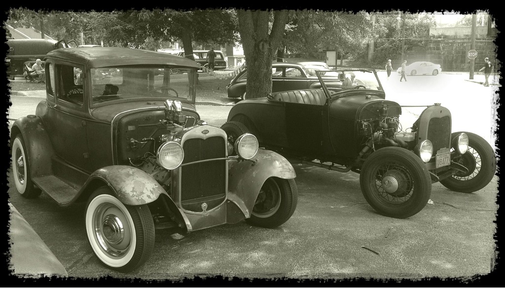

    I just saw in one of of your first posts that you got your Stantions and top from Nick Spragg, Those where on a 28-29 Roadster i had a few years ago! Nick got it from the guy i sold it to and then he sold off some of the parts. Pretty cool that they made it back on a wicked Roadster again!
    This is what it looked like when i had it
  19. Carter
    Joined: Mar 18, 2006
    Posts: 1,542
    Carter
    That is cool. Some of these parts get around, eh?
