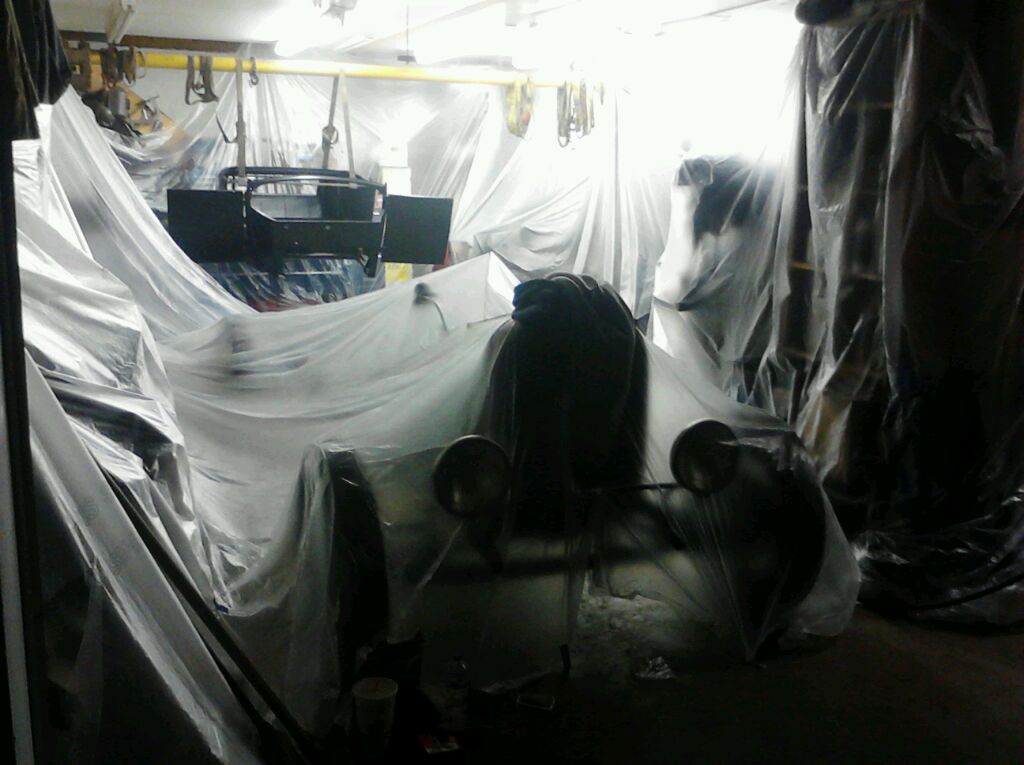

    I shot some epoxy primer over the body for now just to protect it until I do body work this winter. Shot some gloss black single stage urethane on the bottom of the body and the firewall.
    And I guess that about brings it up to current. I have video of starting the engine up for its first time in over 20 years. Just need to figure out how to get it off of my wife's phone and figure out why I look so pissed off in the video. I blame it on a lack of sleep.
    After getting the body set on it became obvious the headlights were too far forward, so I moved them back a bit.
    I will get some pictures up later tonight.

    Ok, well looks like one of the pictures worked.
    The before I moved the headlights back picture is on my phone, but here is the after.
    Also got a horn mounted up. I picked it up at an auction a few weeks ago.
    It is visible just below the rad. shell on the driver's side.
    I just used a piece of the k-member that got cut out to hang the horn.
