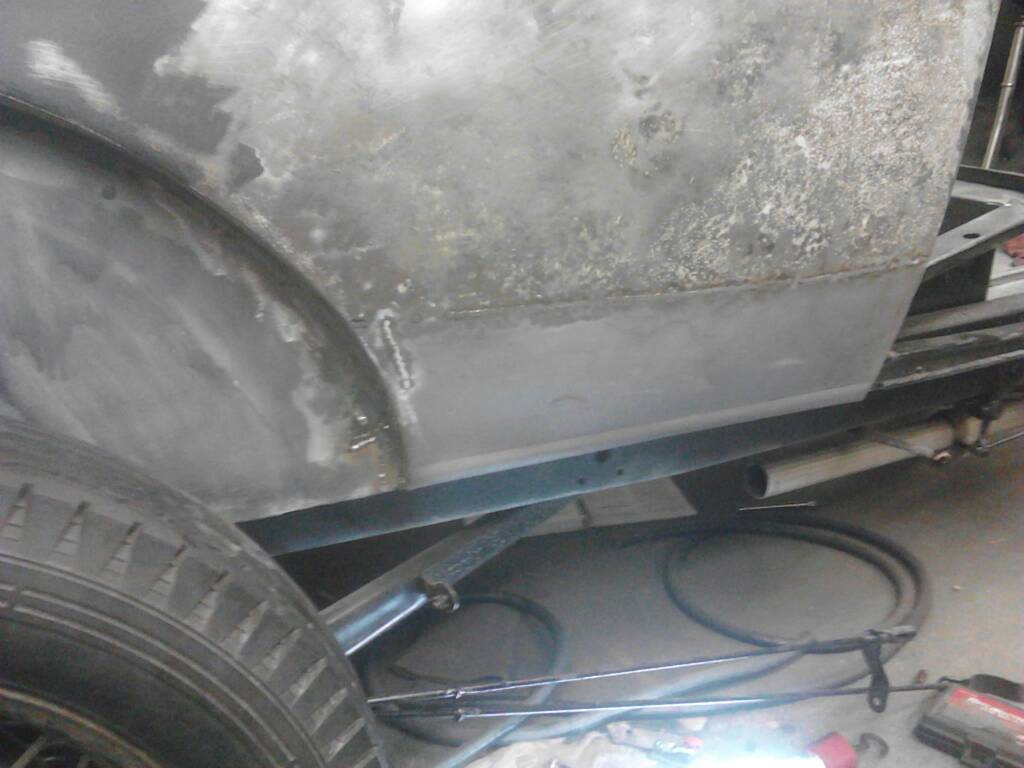

    I got the left side patches all done before my surgery. Still some hammer work to do yet, but it's getting better. These 1/4's are wavy. The old 1/4 patch panels were overlapped and brazed on. Then the wheel well panels had about 75 spot welds where they were overlapped as well.

    Thanks, Ben. Welding is done as of last night. Still have some metal work to do, then prime, and start body work, but welding is done and as soon as I finish hammer work, the quarter wood can go in, then the seat. After that, install battery and add gasoline, turn the key, pull start cable and hopefully first drive soon after.

    Couple pictures.
    P***enger quarter welding done and gauge panel swapped.
