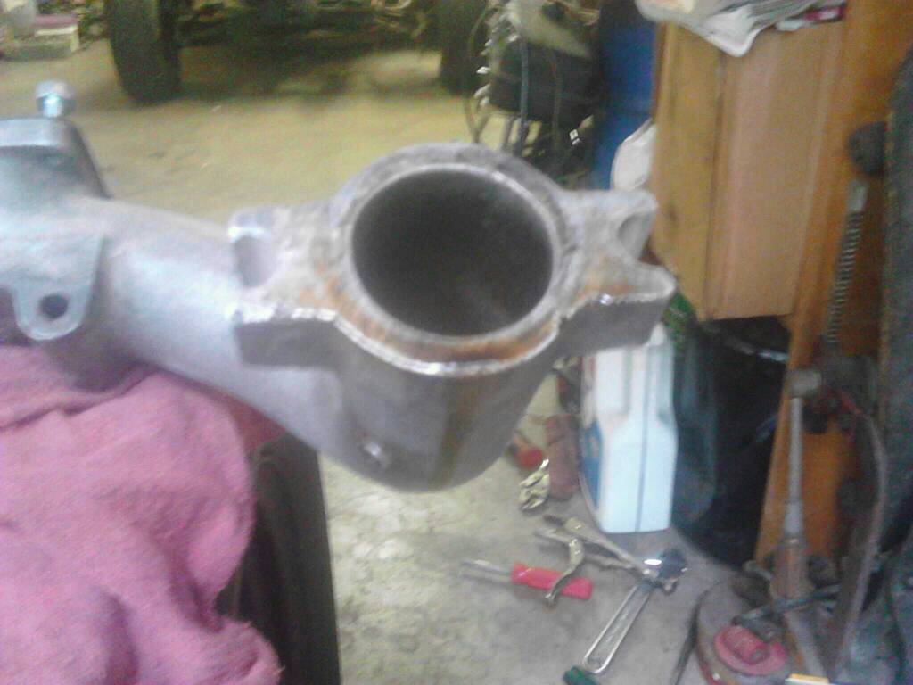

    So, I've been trying to get this thing running well with little success. The idle was erratic, but I kind of expected that as there is some slop at the throttle shaft on the Winfield carb. It was also running rich. Pulled the plugs and they were black and sooty. So I pulled the intake and carb this morning and oil/gas mix ran out of the intake ports as soon as the intake came off.
  13. Carter
    Joined: Mar 18, 2006
    Posts: 1,542
    Carter
    Intake
