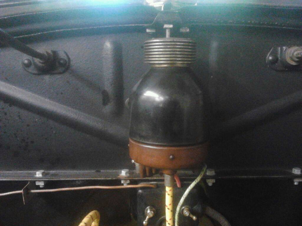

    Went for first drive out of neighborhood yesterday. 55 mile round trip to beaver car show. Everything seemed good, transmission made some odd noises intermittently. I drained the 600W out of trans when I got home, it was very foamy. Switched trans and diff lube to Lucas 85W-140 today.
    Swapped the post war coil out also for a pre 1939 Echlin and Echlin Bear. Have a short video from the drive to post later.
