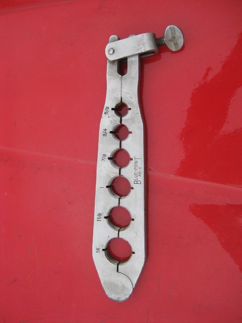

    One of these might help, it restores threads from the inside out. Really, you need to replace the axle, 50 lb torque aint gonna work. 4B24C3FE-14B3-46D1-B010-1FFBFB5F6B1A.jpeg
    19Eddy30, Steve Reddy and Budget36 like this.

    used one of those thread files already to clean up the threads before I ***embled the rear. Thanks
