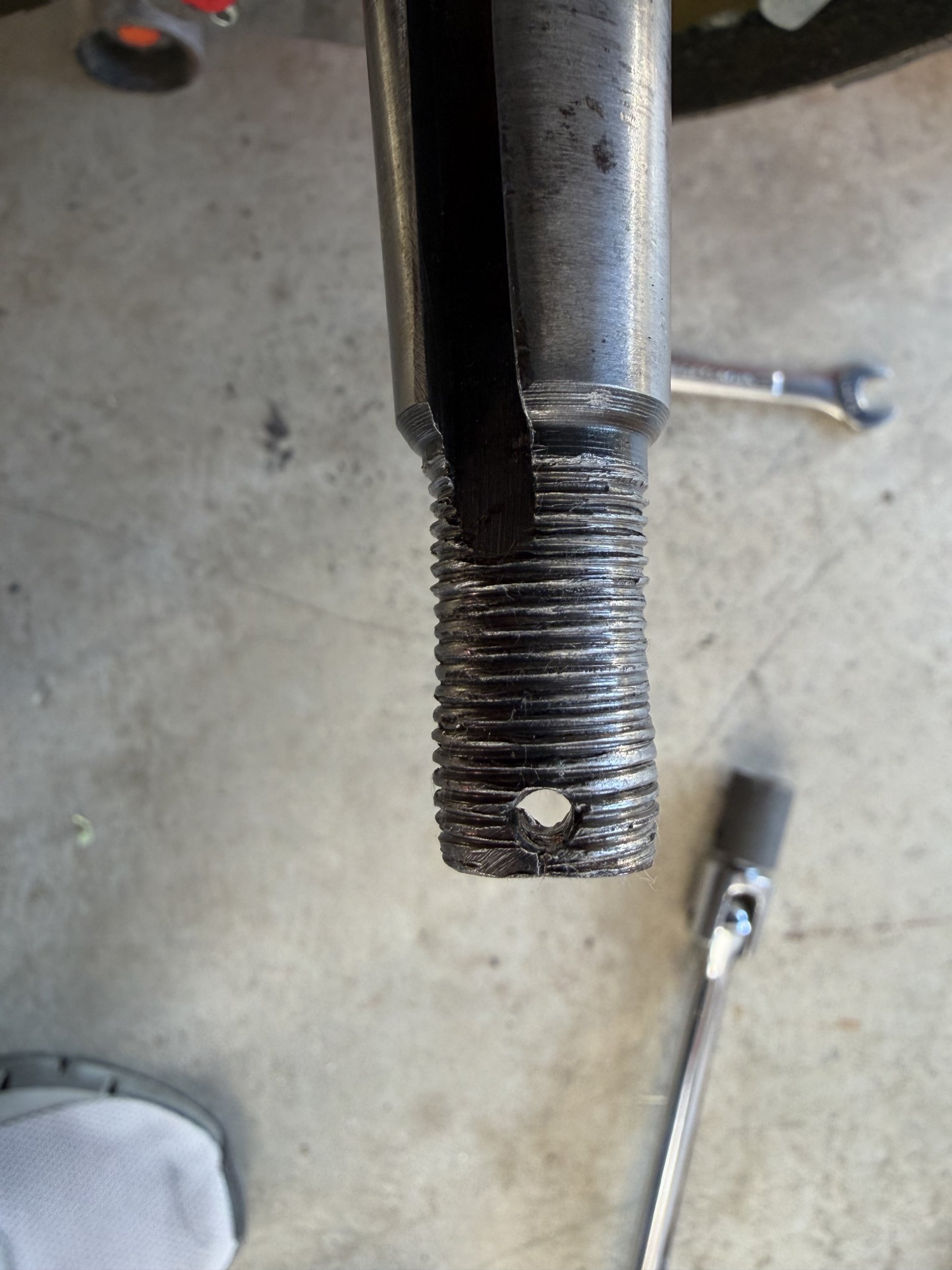

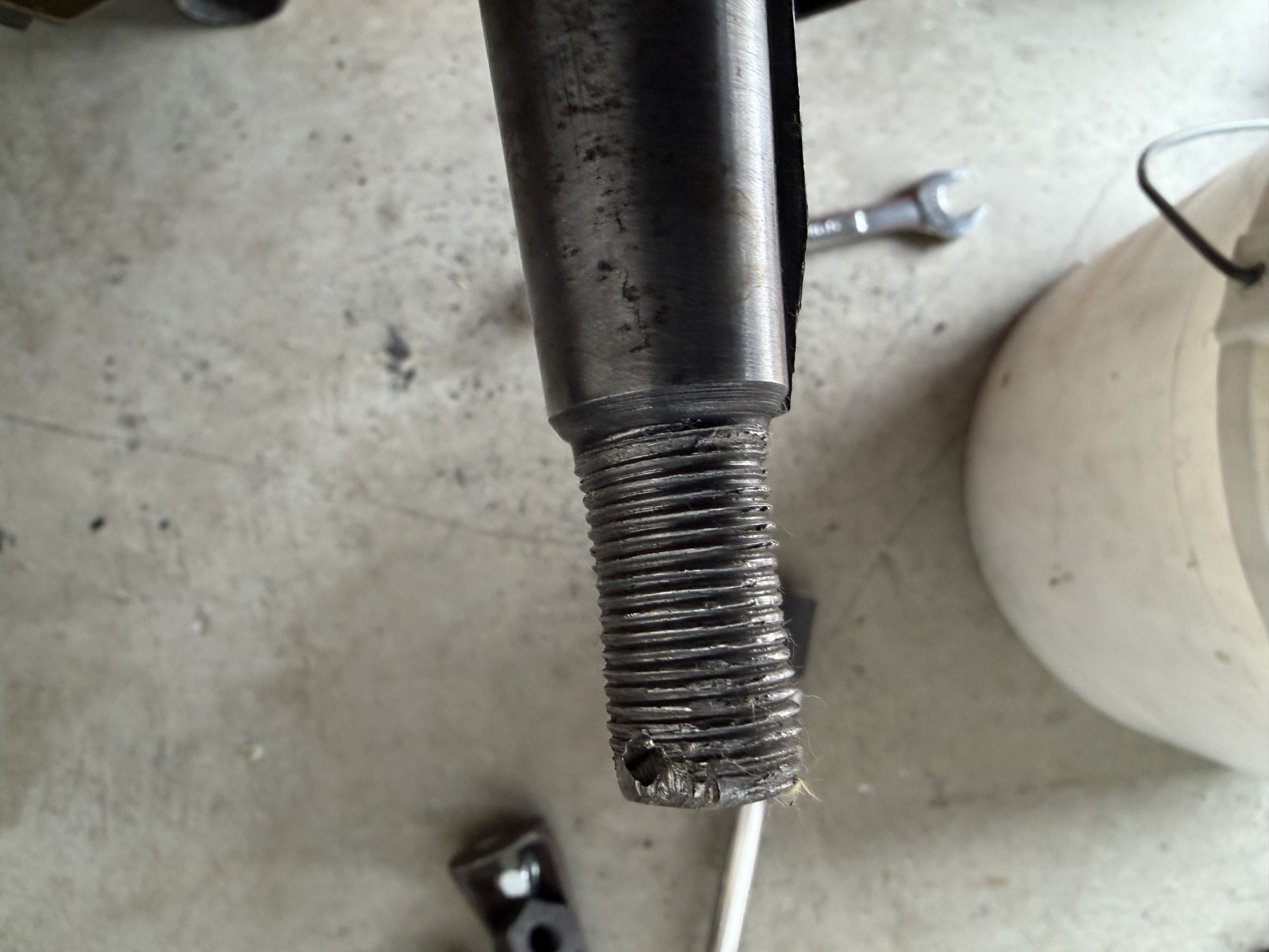

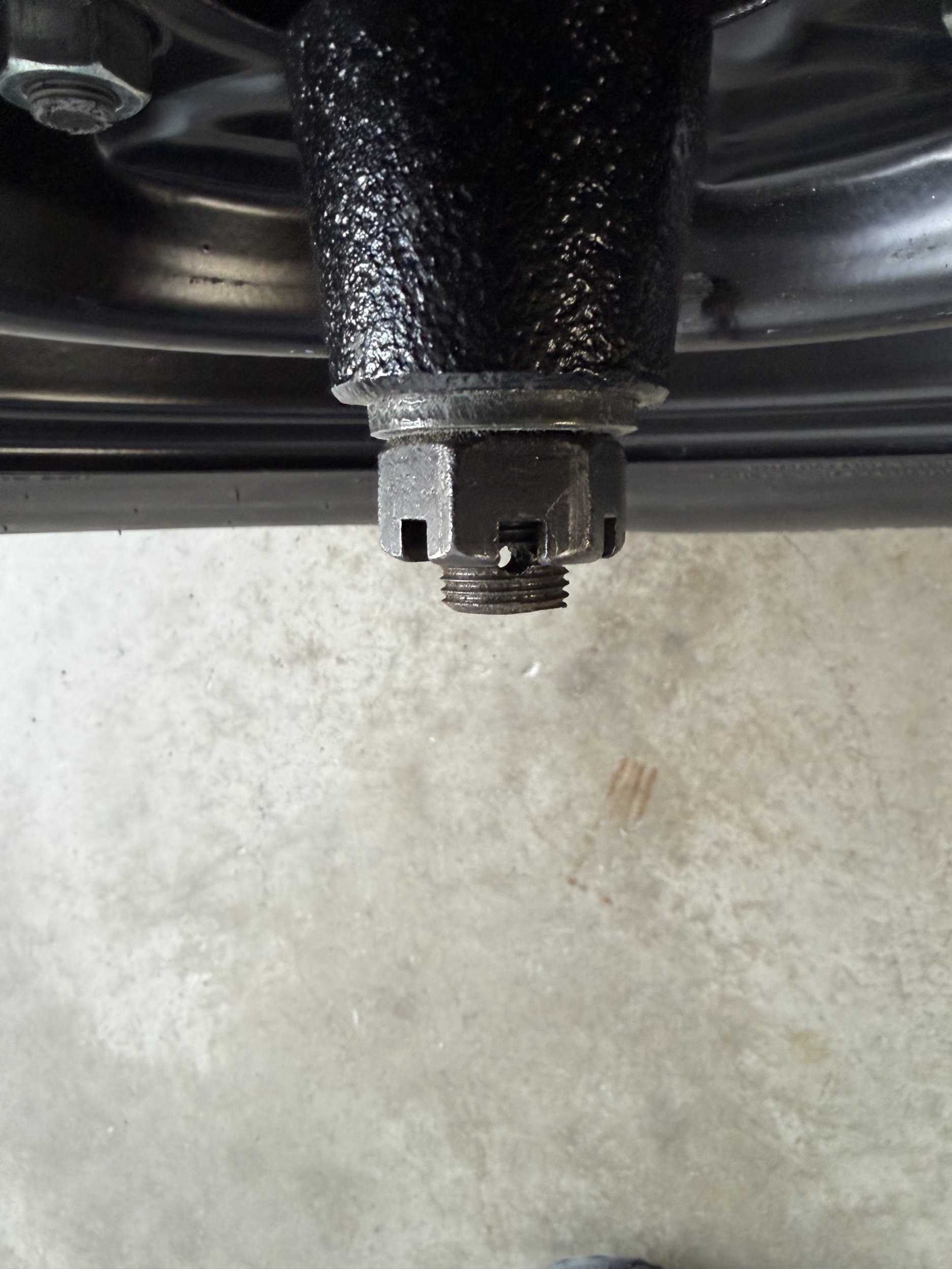

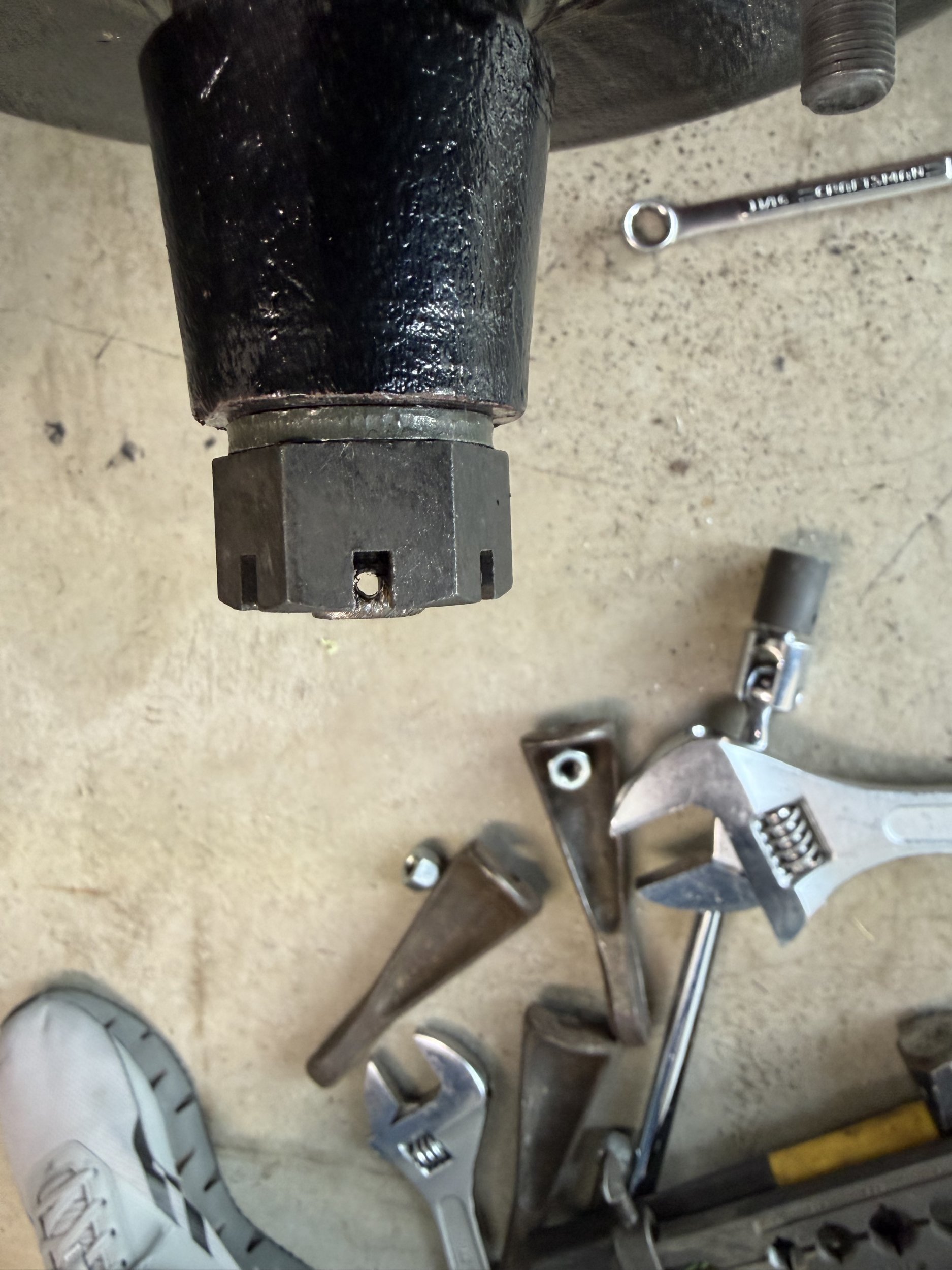

  5. tarheelrodr
    Joined: Feb 6, 2007
    Posts: 243
    tarheelrodr
    Well gents I think I got it licked. A buddy loaned me his thread file to clean up the threads and he gave a pair of new OEM axle nuts. Man these nuts are heavy duty. They are 1/4” wider than the repro ones I got from Third Gen Auto. In fact they cover all the exposed threads on end of the axle. I feel much more confident that hub will stay put.
    pics show threads after filing them, old nut, new nut
  6. Johnny Gee
    Joined: Dec 3, 2009
    Posts: 15,002
    Johnny Gee
    from Downey, Ca
    So the actual suspect (yes axle threads are worn a bit) was the “nut”. :)

  7. 3blapcam
    Joined: Jul 15, 2004
    Posts: 750
    3blapcam
    I'm glad you're confident with that repair... because I wouldn't be. o_O
