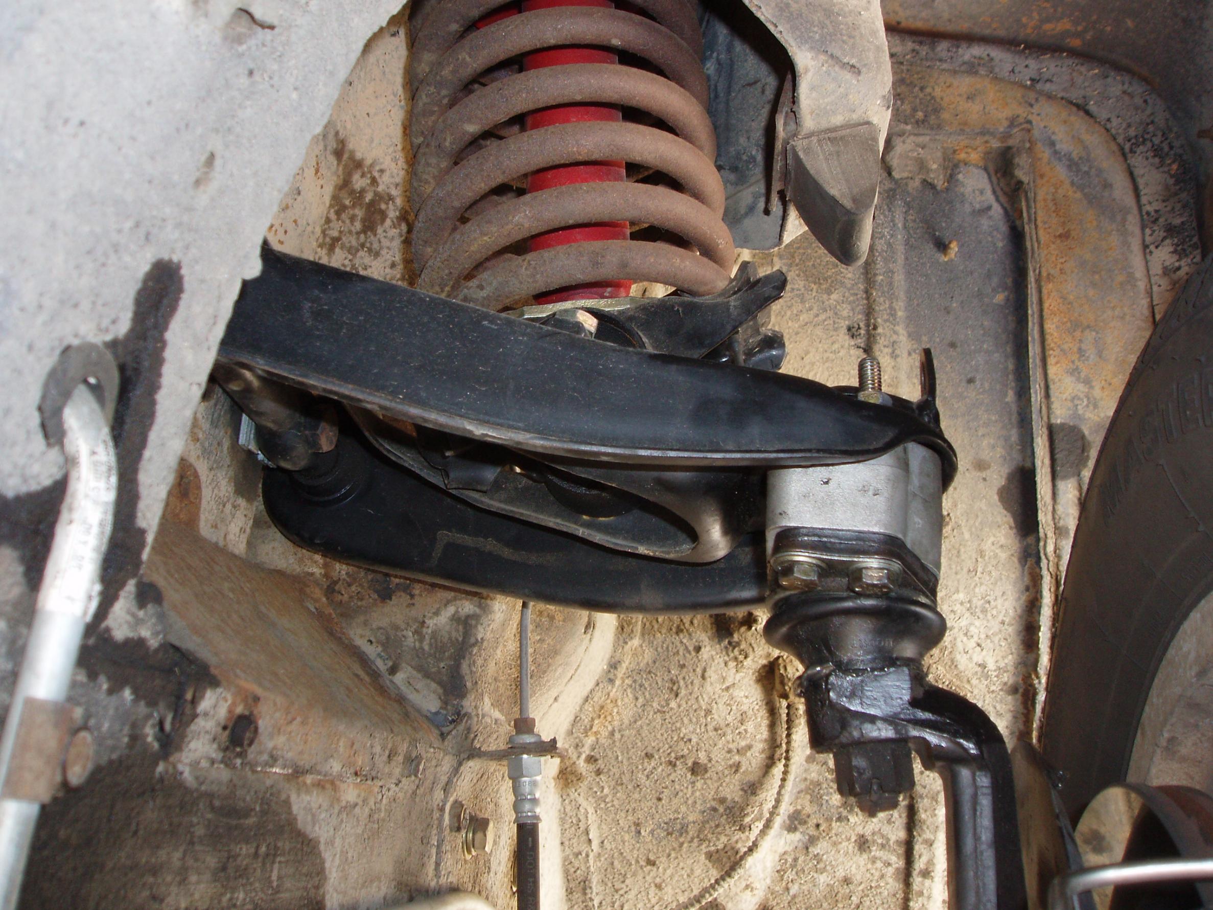

    Thanks for the input so far. I guess I should have added pictures to the original post.
    I am aware of the "C" type ball joint spacers that I think some people are imagining here. I am refering to a spacer that fits between the ball joint and A frame.

    With the C type between the balljoint and the knuckle yes...but with the type that goes between the arm and the balljoint housing...no.
    All pivot points stay in the same relationship to each other.
    The key is that the balljoint goes with the spindle.
    Draw it out on paper....
    You ARE lifting the car so it changes from stock, but it would be exactly the same if you just added taller springs to lift the car the same amount.
    All that said....I'm just discussing what I'm seeing here and I'm not saying these should be used for the street.
    I'm simply saying that the type Frankenfords is talking about is the lesser of two evils. The C style I wouldn't even consider for the reasons I mentioned earlier.
    If forced to use Frankenfords style on the street for some reason, I would prefer shorter ones and would likely add a steel plate reinforcement to the area between the spacer and balljoint that would tie into the control arm to prevent stress cracks over time.
