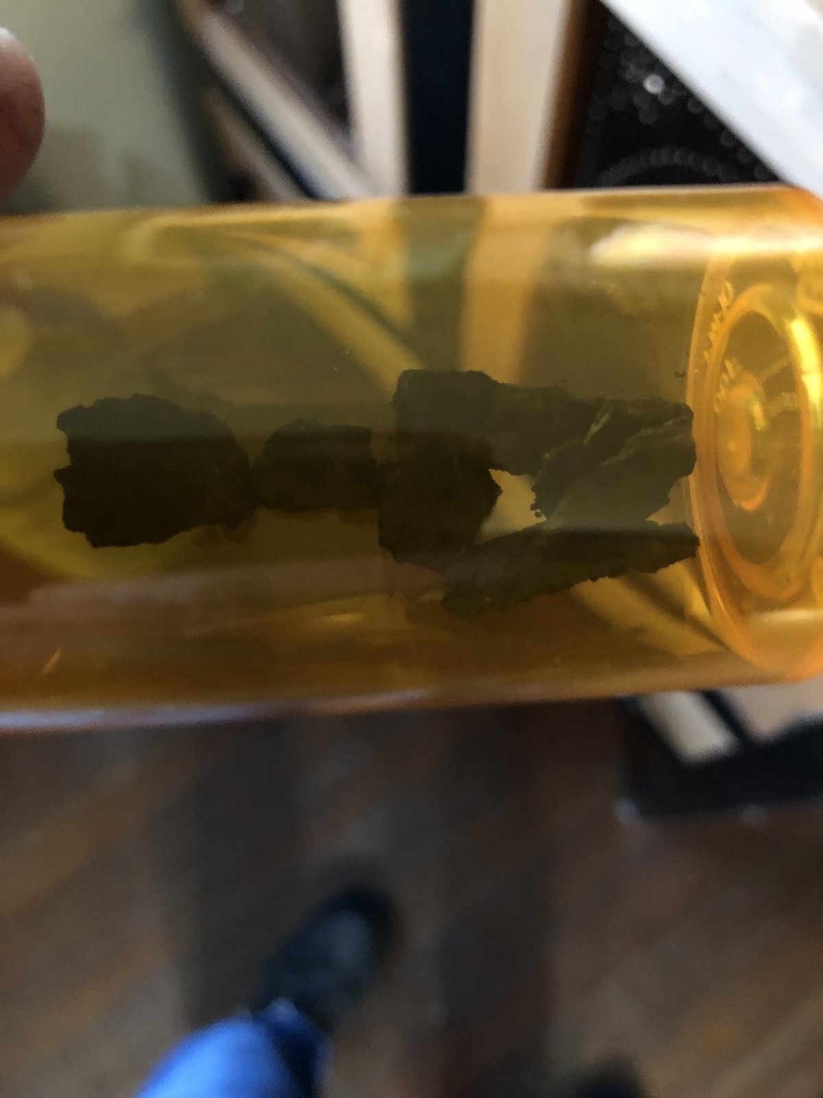

    Yup. Me again. While tearing the head off for the stuck valve and scraping the old intake gaskets off, I noticed some good size pieces of deteriorated cast iron coming from inside the intake. Not water areas either. I’m going to try to get inside and get what I can out but what is worst case scenario if a piece flakes off and gets somewhere it shouldn’t? Thanks in advance. Dan

    Mgtstumpy. It looks like old burnt casting from the middle tube only

    Is that carbon from the exhaust crossover?

    73RR. I can get a magnet to stick to it so I don’t think it’s just carbon. Am I screwed?

    Egads is the exhaust crossover the middle tube on the intake? Cause that’s the culprit

    Yes. Very common to find that in the crossover.

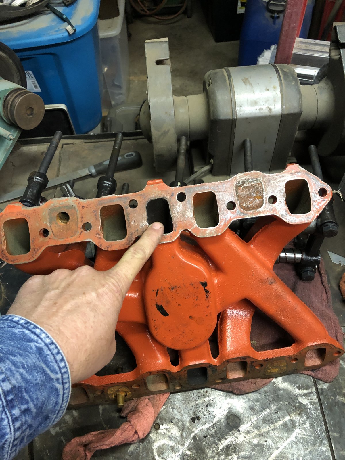

    A photo of the intake showing where it came from would be a bigger help.

    Mr48chev. Here you go

    I've spent way too much time over the years with a hammer and small chisel getting carbon out of those crossovers. It shouldn't be magnetic though.
    The only thing that happens if that passage is plugged is that the engine can be rather fussy until it warms up completely. That passage warms up the intake to atomize the fuel better with a cold engine. once the engine is up to operating temp and the intake is close to the same temp as the rest of the engine it isn't an issue. If you have headers or exhaust without a heat riser all bets are off anyhow as you have to have a heat riser on one side to get the exhaust to flow though the crossover to the other side.

    Scrape out what you can, bolt it back together and run it. It is sticking to the magnet because some of the components of that "carbon" are ferrous metals, of which there are trace amounts in gasoline. Here's one sentence from a National Library of Medicine study titled "Content of metals in emissions from gasoline, diesel, and alternative mixed biofuels".
    "The highest metal contents in emissions from diesel and gasoline fuels were found for Fe, Zn, and Cu."
    Fe is iron (and a great Ford engine) which is why that crap sticks to a magnet. There are likely also microscopic particles from ring and cylinder wall wear.

  23. Dan,
    Like the guys said,,,clean what you can out,,,and you should be good to go .
    It almost looks like some casting flash left over from when it was new .
    From what I can see in the pics,,,,the intake looks clean in the ports and throttle bores.

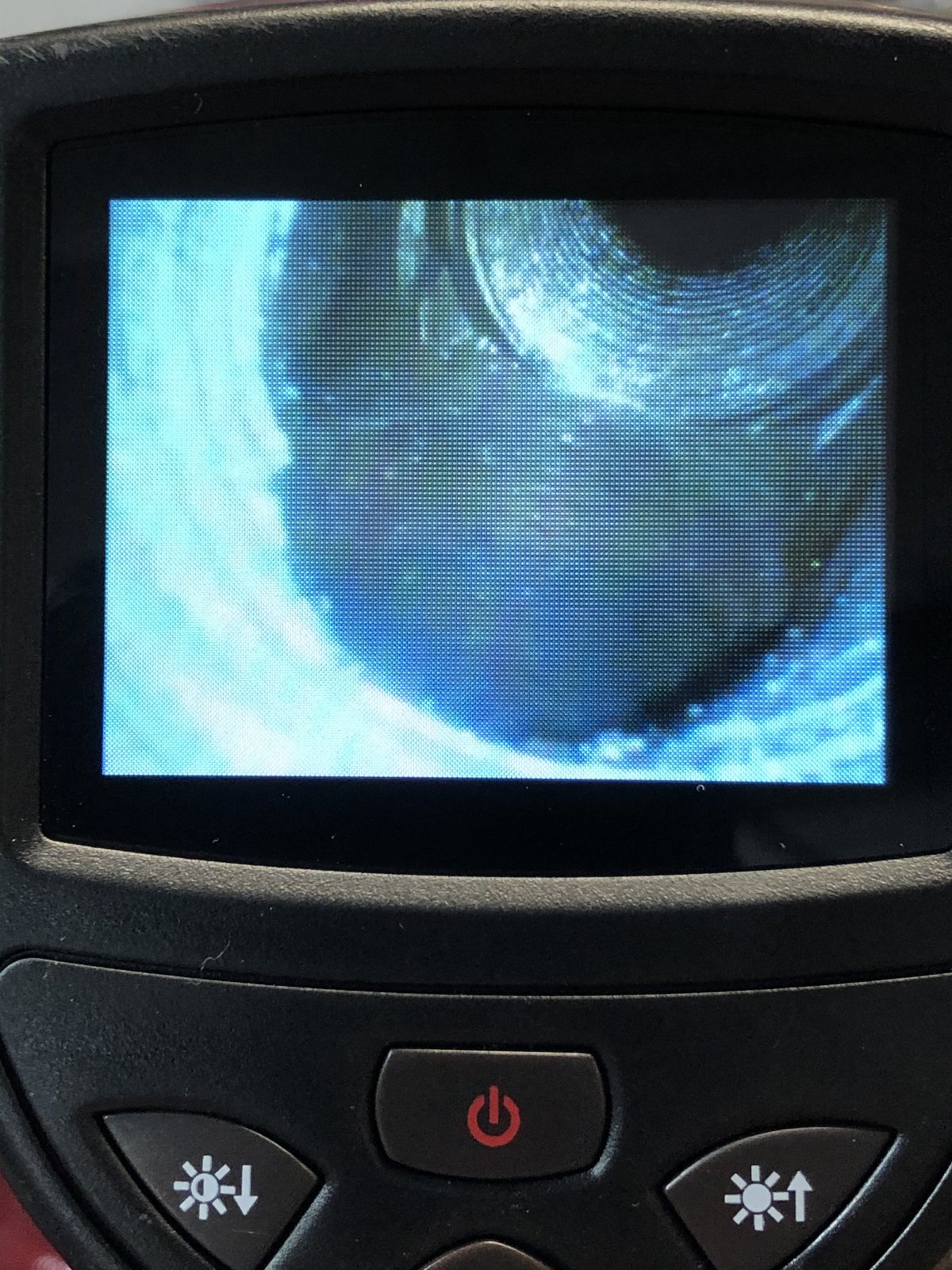

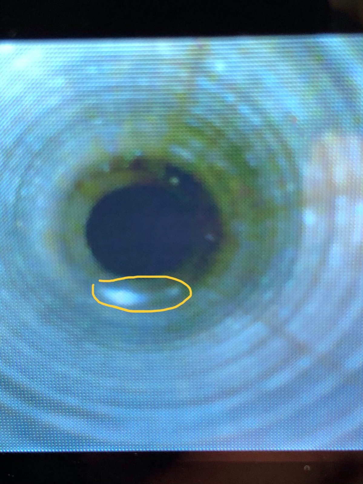

  24. Dan ,
    Here are a couple of examples from my scope .
    I was examining the oil galley tube in my Flathead.
    These pics were taken with my phone from the screen on the scope ,,,they were much clearer in person and not blue in color .
    I had snaked the scope about half way down into the tube on the second pic .
    Tommy
    E5A1AC8F-BF7C-4693-90AD-78AD80C8B48A.jpeg 557D14A7-5D87-445A-9417-28390881264C.jpeg
    Dan Yager likes this.
