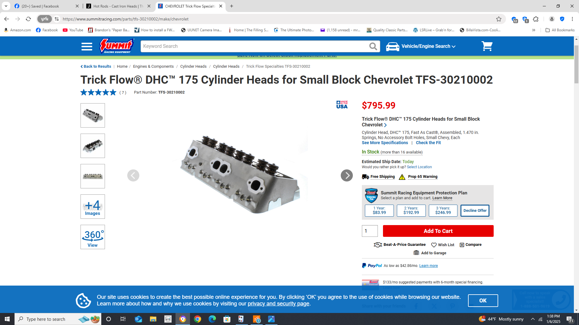

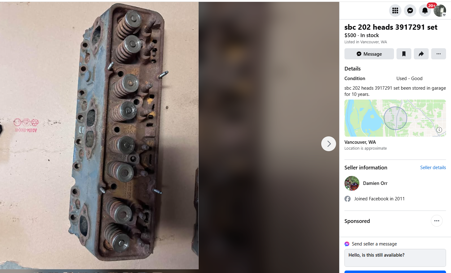

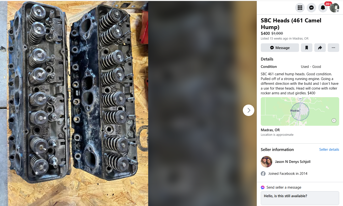

  20. Mr48chev
    Joined: Dec 28, 2007
    Posts: 36,191
    Mr48chev
    As for Camel hump heads it might come down to the numbers and if you have a decent set of iron 202 heads to rebuild according to these asking prices. 1600 for a pair of ready to bolt on as cast heads from Summit or 4 or 500 from one of these guys if they don't take what you wave under their noses plus a hefty machine shop bill. Screenshot (1858).png Screenshot (1859).png Screenshot (1860).png
