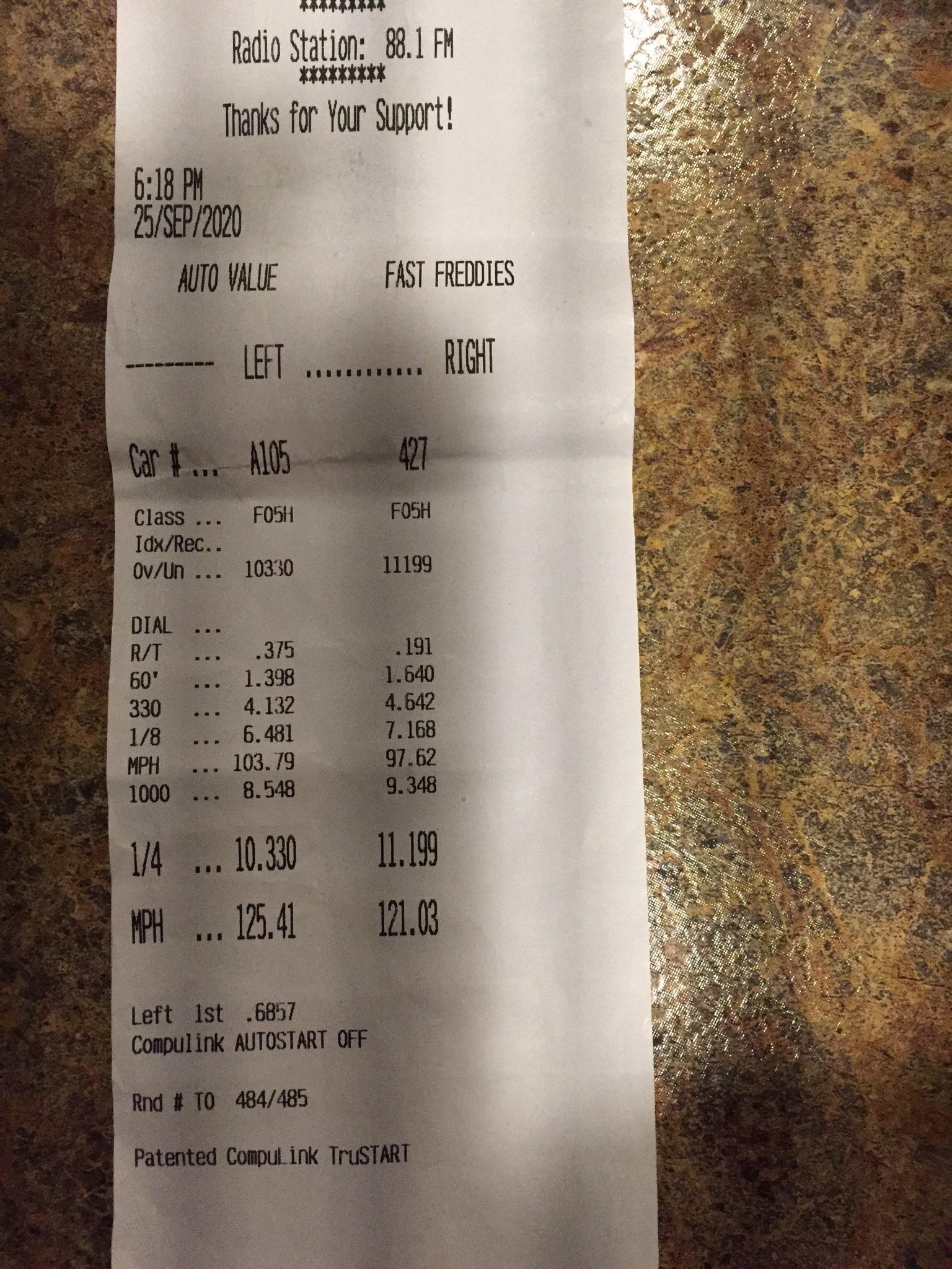

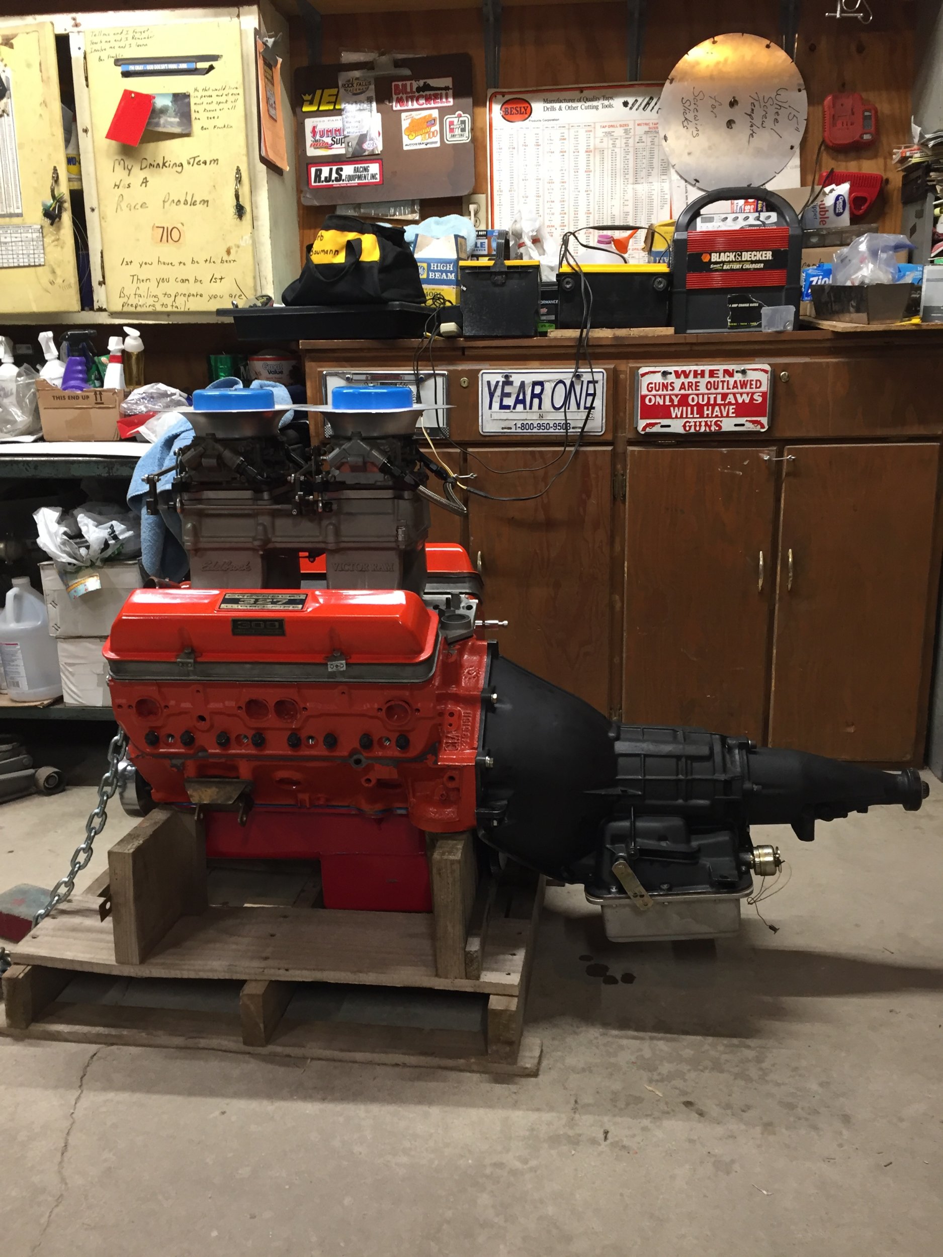

  15. Tickety Boo
    Joined: Feb 2, 2015
    Posts: 1,930
    Tickety Boo
    from Wisconsin
    Built a mostly swap meet parts sbc 434 engine for my O.T. 3200 lb. drag car in 2005, used the top-proline New Zealand 220 cast iron heads because they fit my budget and were advertised as flowing 272 cfm. @ .600 lift.
    Raced these heads until 2019 with a best E.T. of 10.81.
    In-between racing at the Meltdown drags 2018 visiting the Compe***on Products trailer and looking at their new stuff, I noticed a new brand of heads, "Power Products", aluminum 220s on the table with 2.080 valves and were advertised to flow 300+ cfm.
    Purchased them for less than $1500.00, that included the extra cost of a fluff job to get 308 cfm.
    I've been happy with them so far, with only changing to the new heads got a 00.48 quicker E.T. of 10.33
    I also painted them fast orange ;) Engines been waiting for its new Hamb friendly home about 3 years now, hoping to have it running this summer.
    Deuces, Chavezk21, MUNCIE and 3 others like this.
