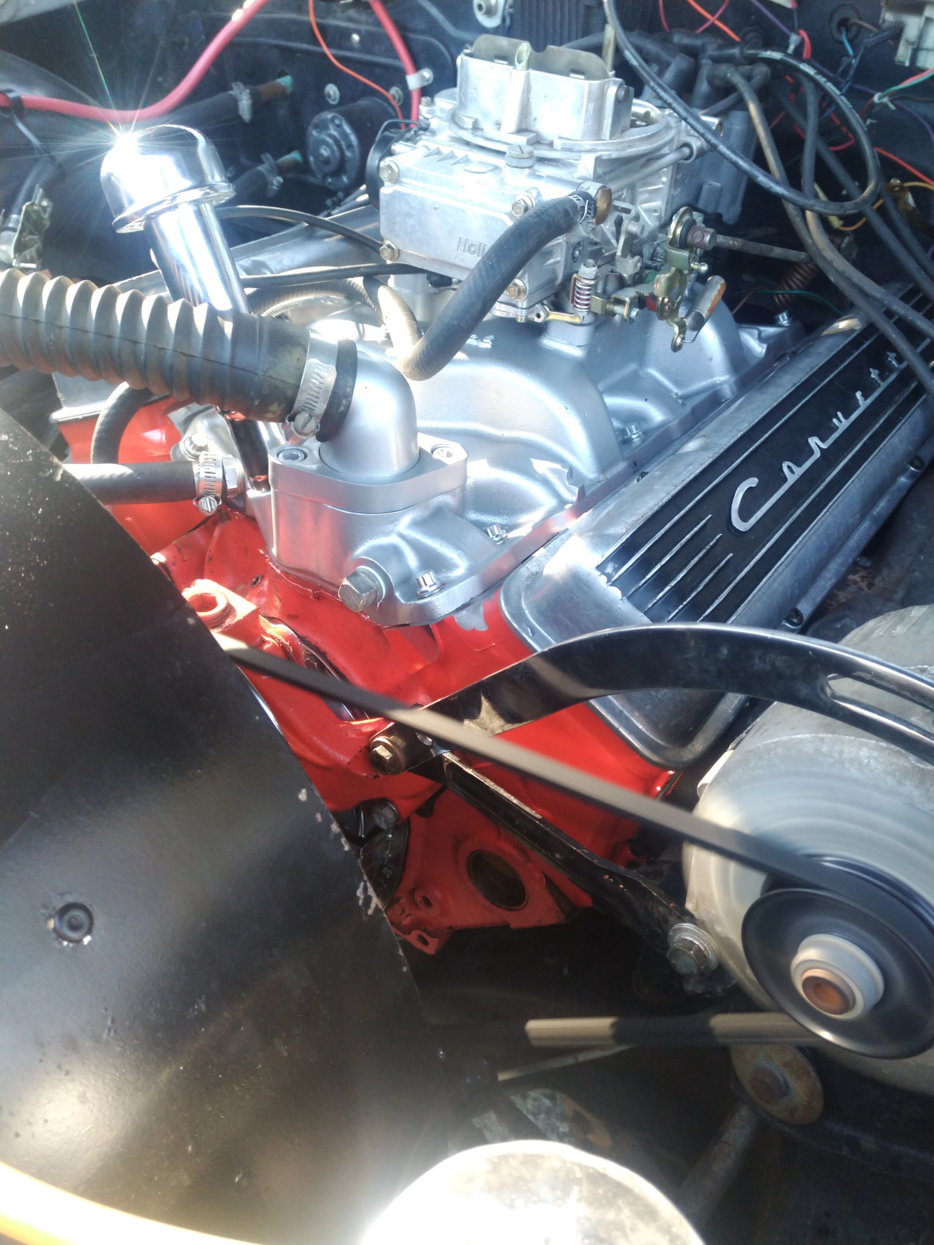

    IMG_20250209_145205.jpg IMG_20250125_123828.jpg IMG_20250209_131510.jpg IMG_20250209_133044.jpg Speedway double humps vs oe. I had to grind slightly in the exhaust manifolds to clear the valve cover. It's back up and running which was the goal and looks close enough to how I started

    No good pics. It is 66, ,67 Chevy truck manifolds and brackets 1967 manifold in my case. Mounts to the front of the manifold, not the side, with a bracket that bolts to the manifold and water pump for the bottom bolt IMG_20250209_144846.jpg

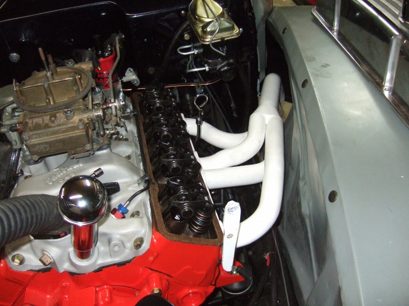

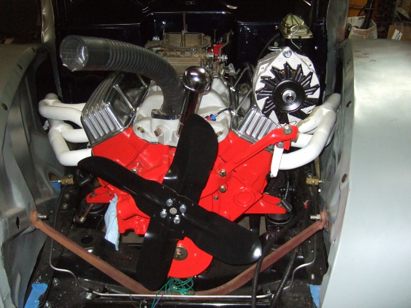

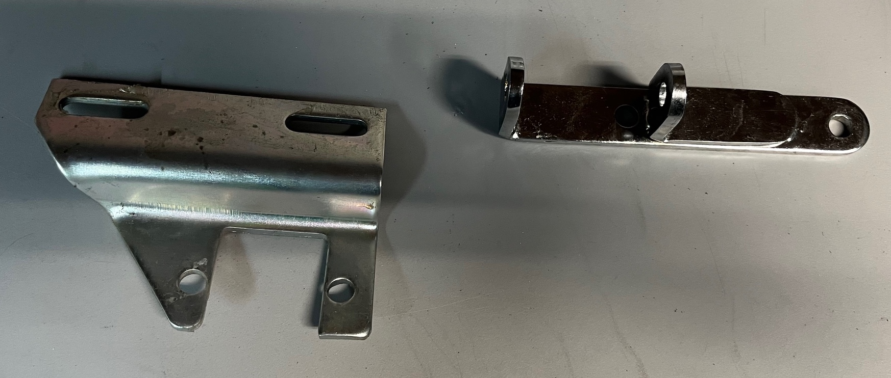

    here are a couple of pictures of my alternator setup in my '40. It uses a stock Chevy mount and adjustment strap. I welded a part onto the drivers side header ( which I built).
    These 2 pieces can be used with manifolds or headers , but do not move the alt. up enough to clear the valve cover. They were used a lot in the '60s and maybe '70s. They are not very elegant but could be modified pretty easily.

    He is using the same Chevy truck lower bracket as I have, with a homemade bracket to support the back with headers. Very nice. I will copy this when I put my headers on, as it provides superior support over the side mount header Mr Gasket bracket

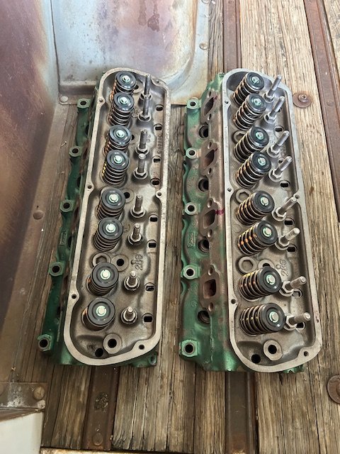

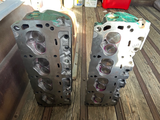

    Well I was looking at my (5D26-1965-Cast- SBF heads) that been on the shelf for too long now and it looks like the machine shop removed the thermactor humps along with smothing the 3 sides of the exhaust ports (except the bottom) about a 1/2. That was a nice surprise, I didn't realize it when I picked them up. Once I get my headers I will port match the gaskets and the intake side.
