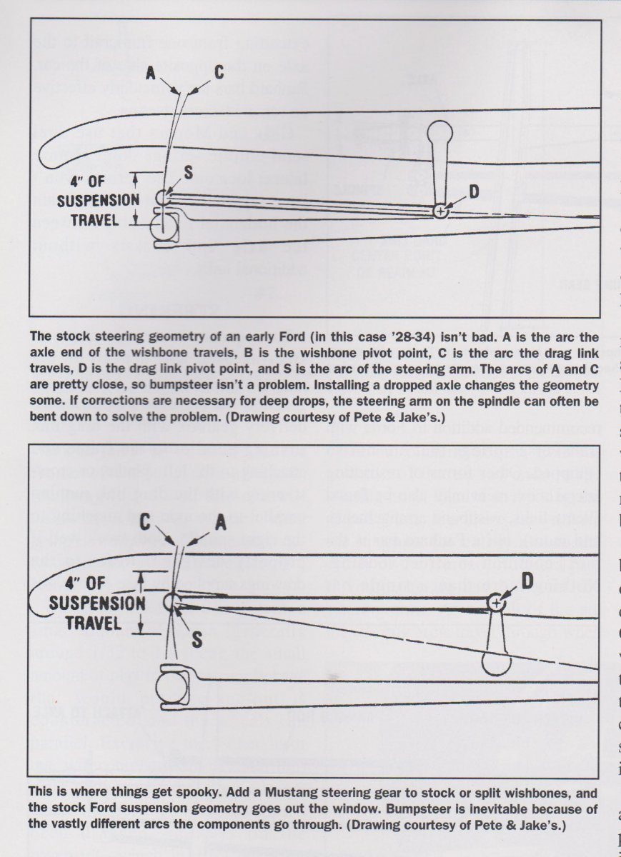

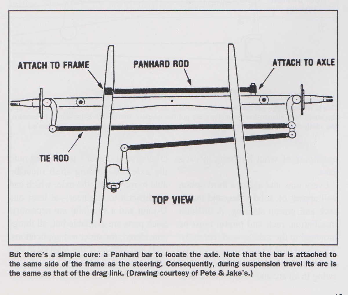

    Get a copy of the Pete & Jake Catalog and they have a section that details how the steering components interact and what causes problems like yours.
    Some examples:
    This isn't Pete&Jakes but it was the source for this info............Get their catalog and it should help you find your issue.
    pitman and dana barlow like this.

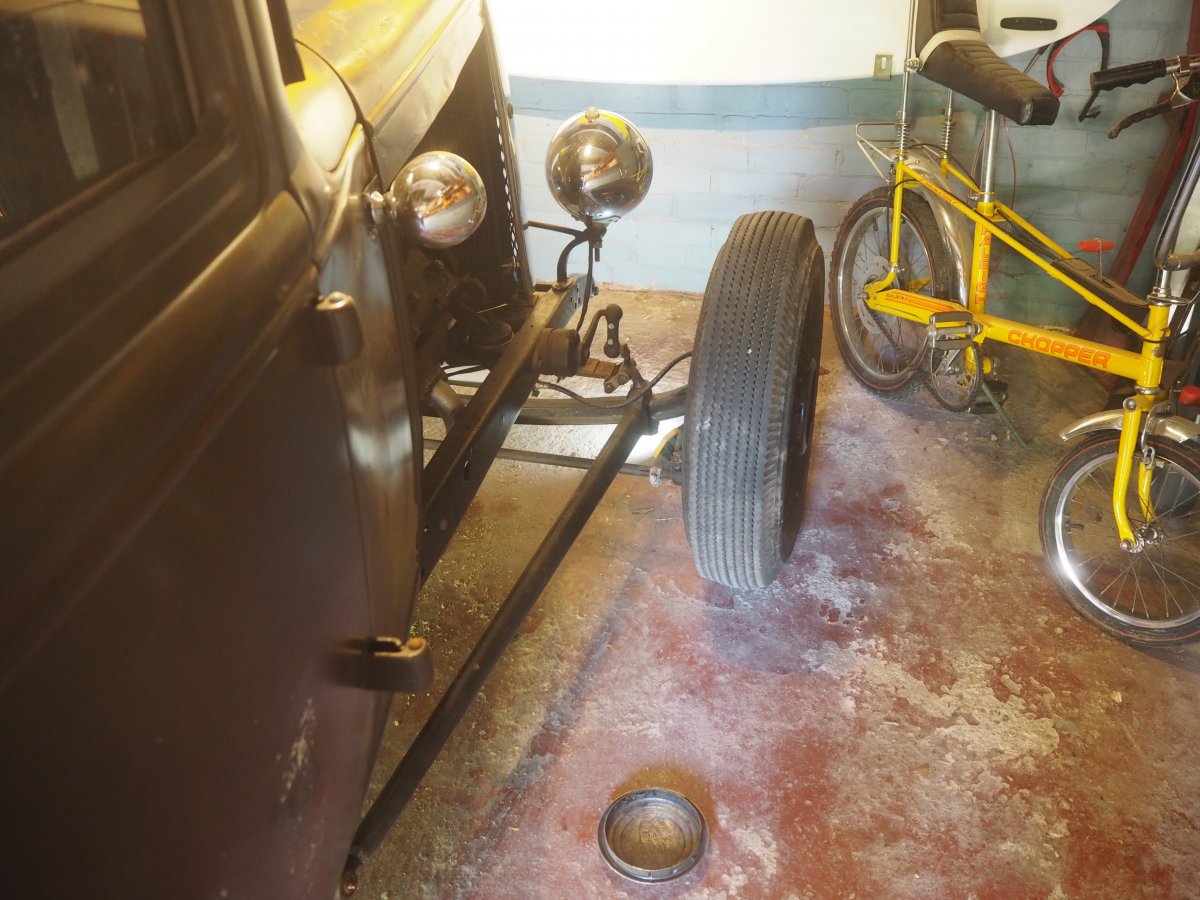

    I enclose a few more photos . My tyres are very curved in profile P1010036 (1).jpg P1010027.jpg P1010024.jpg

    Tire has too much PSI in photo,let some out/will need to play with it by feel,,but match both sides,adding a damper will help. Adding a panhard bar will help.

    Fantastic article I now understand bump steer
