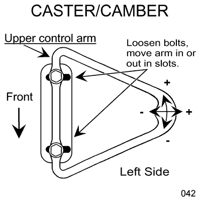

  9. Phil1934
    Joined: Jun 24, 2001
    Posts: 2,716
    Phil1934
    You angle the upper A arms back by sliding the rear bolt inward and the front bolt outward in the slots.
  10. FrozenMerc
    Joined: Sep 4, 2009
    Posts: 3,412
    FrozenMerc
    Per Phill's description. You won't be able to change just caster with out affecting the camber. Bring it to a shop. Any good alignment shop should have no problem handling this, especially if you bring the specs your shooting for in. I use the local Chrysler dealership for all my hot rod and custom car related alignment jobs. They are more than happy to do it, and the car normally ends up in the show room for an afternoon, generates lots of traffic for them.
