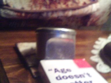

  2. Got the mold to work and the core. Still a bit crude but we are making progress. Used a baked sand core. The clam shell set up of the mold works well now. I need practice now. Here are my two babies sitting inthe window. Preheated the mold just before pour. Not too hot just enough so we could see it smoke here and there. Put a bit of mold sand in the bottom of the mold to help with realease and to stop leaks. Seemed to work and that will be machined anyway. The seam for the clam shell joint is minor and positive so the lathe can get rid of it . Gotta quit for a couple of days. Worn out.

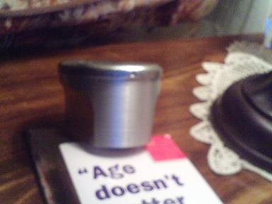

  5. I chucked it up in the lathe as cast and machined the lower skirt area. Monday i will turn it around and cut the top and ring grooves. Am I satisfied yet. Not quite . But I am a whole lot closer than I was a week ago and I have had a ball!
    Baked mold core.
    I mixed my green sand (the stuff I found here BTW) 1 part wheat flour and 20 parts sand. I mixed it well. I tempered (moistened) it with mol***es water which is 10 parts water to 1 part mol***es. I spread the sand flour mix out on a flat area and sprinkled the sand with the mol***es water till it it just got a little darker. I made a paper liner of the exact diameter and placed it in the first piston i made then packed in the above mixed combo. Not crazy tight but snug. Being in the paper which was taped together it slipped nicely out of the piston. I placed it in the bottom plate of my mold which has two holes in the bottom and shoved a bit till some of the sand protruded through the holes just a bit. I had asked MRS D about baking in her stove. She replied by showing me a toaster oven on sale in the weekend flyer. I found a cheaper one at CTC . $18. I put in the bottom plate with the core paper and all. in the oven and baked it at 300 degrees 2 X 15 minutes. Surprisingly the paper didnt burn. I carefully removed the paper and the core was now stuck on the plate to which is a bonus. The core is quite stable and after the pour and cooling I had to smash it.This is the first sand core I ever made . It was good but I know now I can do better. I am however going to finish this piston first as it is good.
    Don

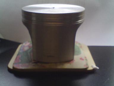

  23. Here is the piston with more machining. I have also located the ring grooves . Top ring MUST be .150" down to survive comfortably. I am making this a two ring. Why because I am only going 1/4 mile tops.
    This piston looks no different than out of the box ones to me. Would I use it? Yes I can honestly say i would. However I have a few mods I would like to do. First I have to grind a few bumps out of my steel mold and make some minor adjustments. I need to positively locate the core the same exactly for every piston so I will make a wood fixture for that. The mods needed are minor . The basic idea works. I will completley finish this piston over the next few days (I hope) and will post as it goes.
    BTW when making wooden patterns dont forget to make them too big and make any holes too small. The shrink rate is about 3/16 if an inch per foot of diameter. One book showed how to make a foundry ruler for aluminum by using a normal ruler as a guide and placing the new stick to be marked on an angle then transferring the numbers accross with a square. I did that when I made my flow bench only horizontaly so the idea will work I know.
