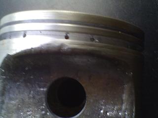

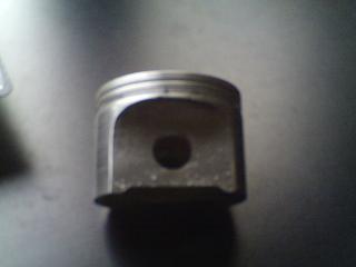

  1. Top ring groove is a milimeter or metric . I took the dimensions from a 5.7 piston. Same for the second ring. (from a 5.7) I dont think I would use the narrow oil ring again. Drilling the tiny drain holes is too tricky. I broke a drill off in there and fooled around for two hours with a needle getting it out. Besides with only a compression ring I think the 3/16 style oil ring would do better on smoke control.
    I learned a lot machining this piston. I need the core slightly higher so the holes for the oil ring come out into the core. A couple did but most I had to drill for.
    I lost a bit of lower dimension not clamping the mold to the base as it has a small leak. It is still good but not perfect. I MUST get in the mold with my die grinder and make it perfect. The imperfections while they would not affect performance are not acceptable to me. You can see in the shot of the oil drain holes where the weld was not trimmed well in the mold. That is easily fixed. You have to machine pistons a certain way so you can chuck them true and must leave the final work for the end like the inside skirt taper. Luckily I have remachined enough pistons to remember this but it was not always so.
    Final weight was 410 grams. I was surprised. Piston does not seem weak in any area to me I am confident it would perform.
    Re 400 pistons. The ones I had made for Christophe Schwartz;s Lemans practce car engine were made to my specs by Ross. I forget what they weighed (690?)but it was less than stockers for sure . They were forged and 9.6 to 1 comp. Last i heard that motor is still running with only a intake pan or tray needing to be replaced this year. That is 5 years of hard road racing. I am pleased with it.
    Anyway. I pushed this through. It was fun. I have learned a lot. Before the snow falls We will melt a bunch of old pistons and cast probably 8 cores to work on when we are bored during winter. First though I must find a 198 crank and see of I can stuff it in a 170 block somhow. Thanks everyone for the tips and encouragement. So is it possible to homecast cast pistons and come up with a useable product? I would say absolutley ,yes. Is it easy? nope! But it is fun

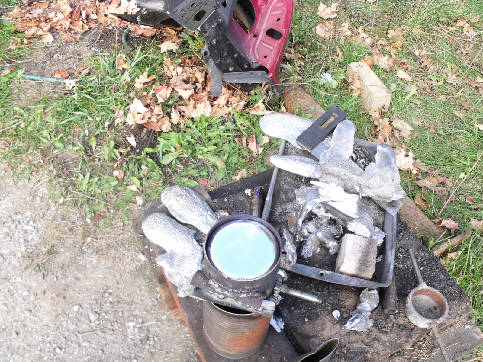

    Couple of shots from last weeks pour at Don's. Heading over this am, another session coming up. Don is trying another mold. Will get some pics.
    It's just 2 Old Farts having way too much fun!!!

    Anyway the sand mold was a disaster. Gotta use a baked core for the inner otherwise the steam just bubbles away. In fact we made some aluminum bubbles.

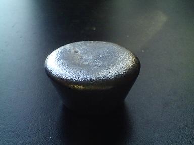

    Spent the whole morning after the illfated pour melting down 12 pistons that a friend donated. Vern was dosing off so he finally went home. It was too exciting for the old guy! I baked a couple of batches of muffins after he left. Used up a whole tank of propane but I want a good supply of ingots for winter.
    It is pretty messy melting old pistons. When I recast them as muffins I get rid of the **** and get a nice clean ingnot that fits in my melt pot nicely.

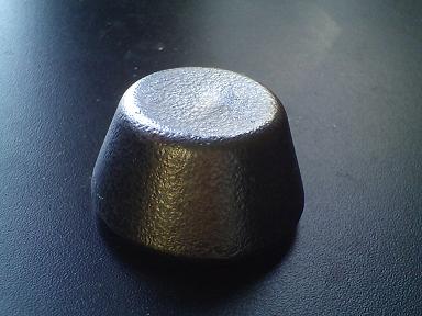

  10. I have come to some conclusions. Some may not be right but so far this is what I think.
    Sand casting . It is good for "one off" parts but the finish or surface is not that great. Even some professional casting I have had made required a lot of finish work like this manifold lid I had cast at a local foundry. I no longer have pics of it in its rough state but i was not impressed. It took a whole day to make it pretty. Still if I need a roughly shaped part for a project that i will be machining or cleaning up I would use it in a heartbeat. I had some injector bodies cast this year at a local foundry. They were not a whole lot different in finish.
    Sands . Oil bound sand works better than water bound. Steam (from water bound sand) is a real issue when casting hollow stuff. Drying out the sand mold with a heat lamp overnite might work. I may try that.
    Baked cores work well. I had no trouble with my baked core and it was easy to make. I shall make a wooden forming tool first before I do any more piston casting so all my cores will be indentical.
    I am really tempted to try a baked sand mold as well.
    The big trouble with a sand mold is it isnt reusable. You have to make a new one everytime. When I did the motorcycle adapter cast i was able to repair my oil bound sand mold and cast in it three times. I was lucky I think.
    Permanent Steel mold . is my favourite. Casting is dimensionally good everytime. I can chuck them in the lathe right out of the mold and the runout is minor. The very first cut you make is most important because it establishes the "Register " for all other machining operations. When modifying or machining these home cast pistons I cut the bottom of the skirt square first. After that I go to work on the diameter. Once I have those two operations at right angle to each other I can go ahead and machine to my hearts content knowing all will be well. I next cut the crown of the piston square (even if I will change that later ) because I can now mount it in my milling vise and not worry is it square or not.
    Someone mentioned spincasting. I was in Holland a few years ago (Visited with our NL Mopar Hamber) and went to a pewter factory. They were casting pewter in a spinning deal like a big wheel. The hot metal was forced hard into the molds by the centrifugal force. That would probably produce a very strong piston (using aluminum of course) compared to gravity casting which is what I used. However it is getting to comlicated for this old fart. Someone younger might want to try that.
    Clay Mold. I would like to try sometime baked clay molds. I believe they could be reusable and might give a better surface finish.
    I reserve the right to be wrong but this is what i think so far.

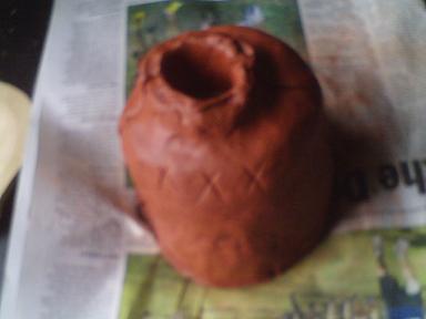

  14. I have the plaster too. I tried it years ago and had a big blow up while trying to cast some emblems for my MW car. I guess you are right . If I baked it it might be ok.
    Don
  15. Unkl Ian
    Joined: Mar 29, 2001
    Posts: 13,504
    Unkl Ian
    Real Clay will shrink as it dries. Not sure how much.
    Maybe do a test.
    You could build the piston up with masking tape first, then apply the clay.
    When firing clay,or investment plaster, it is usually heated slowly to 250 F ,
    to drive off the bound water. Then it can be heated faster.
  16. Thanks. Hopefully the cling wrap will absord the shrink. I didnt realize that it shrunk when it dried. The mold is a bit loose anyway . Maybe it will be ok because of those two deals. Oh well I will know in a couple of days. Thanks for the tip. Keep it under 250 for the first till the water or moisture is gone then turn up the heat. Ok. Thats the stuff i need to know.
    I missed crafting 101.
    Don

  19. I have no idea what Raku clay is. Apparently this is a natural clay that will air dry but can be treated like any other clay. I guess if it splits it splits. What i should be doing is finshing up my steel mold , fixing all the little spots in it and making a baked sand core molder. I guess i am kind a worn out for awhile and this is a nice distraction.
    Don
    BTW failure doesnt bother me. It is success that scares me!

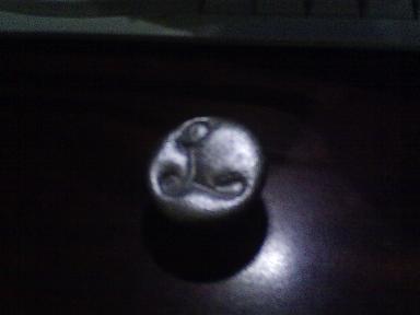

  22. Ok, I am learning . Thanks.
    I am exhausted. I spent the morning playing my homemade fiddle at the 1802 Station Jam and came home about 11. I have been baking alumnum muffins ever since. Baked all the aluminum melt I had from the donated pistons. Now have a bucket full of muffin shaped clean ingots. Even made my wife Linda special one with her intial cast in it. Gotta score a few points now and then! I took a picture of it and it is below.
    I was worried about the ceramic thing so i asked her if she had any old pottery cups she didnt like. Three seconds later i had one in my hand. I hid it behind my heavy wood pouring stand and poured it. I got almost half poured, no trouble then ker-bang. You were right! Now what . Maybe i will take your suggestion and make a small mold, fire it and then pour it to see how this clay reacts. I dont understand yet why that happens. The ceramic has seen for more heat than aluminum ever will . Anyway I will search further before risking a pour. Worst case senerio I can make styrofoam pistons and bury them in my sand and pour that way. Thanks for the graphite tip.
    Don
