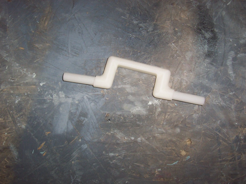

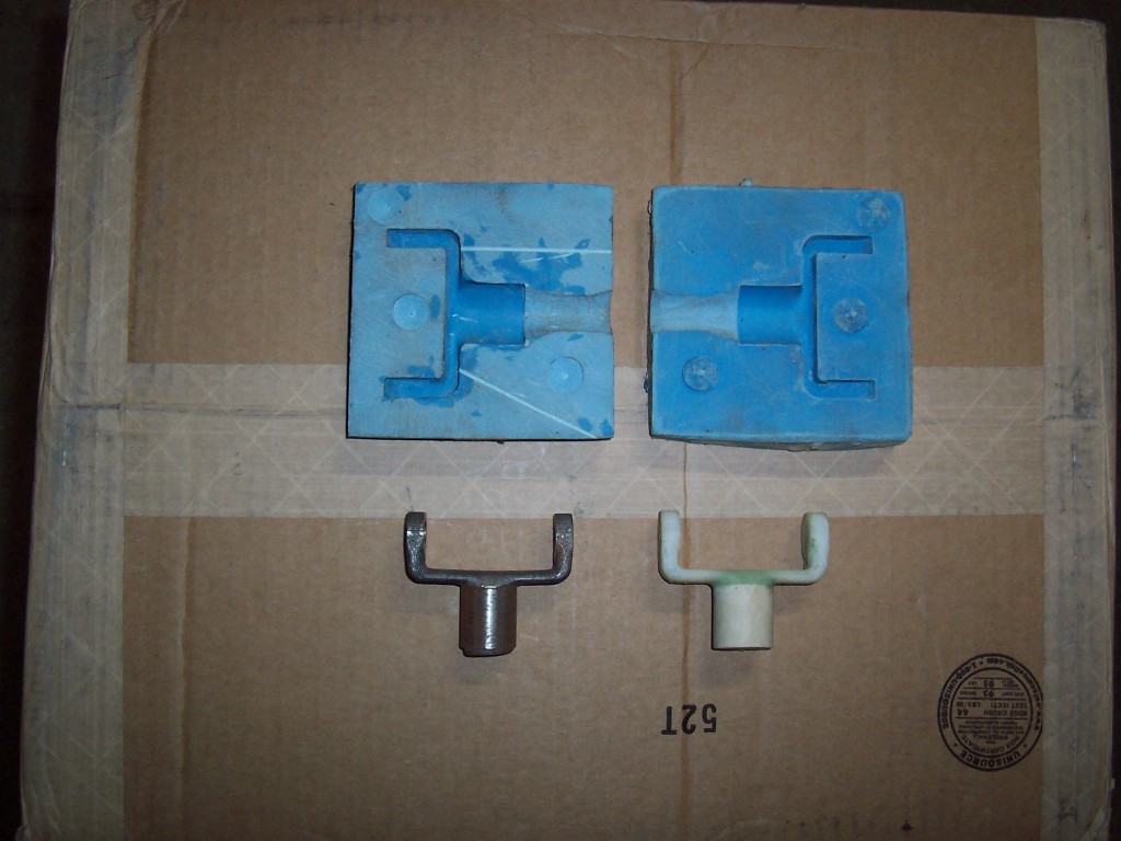

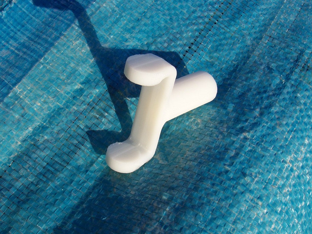

    3D printed model, mold and cast part.jpg 100_0261_resized.JPG 100_0342_resized.JPG My goal was to build replica frames for twin cylinder 1911 Excelsior Autocycles. The original frames were constructed of lengths of straight tubing brazed into castings.
    I had the castings on an original frame digitally measured, had 3D models produced in syrene from the measurements and had molds made of the models and then cast in 4140 Some molds had to be modified to compensate for shrinking, distortion etc.
    As Alchemy said earlier some smart person should develop 3D printer softwear that produces models with compensation for shrink etc.
