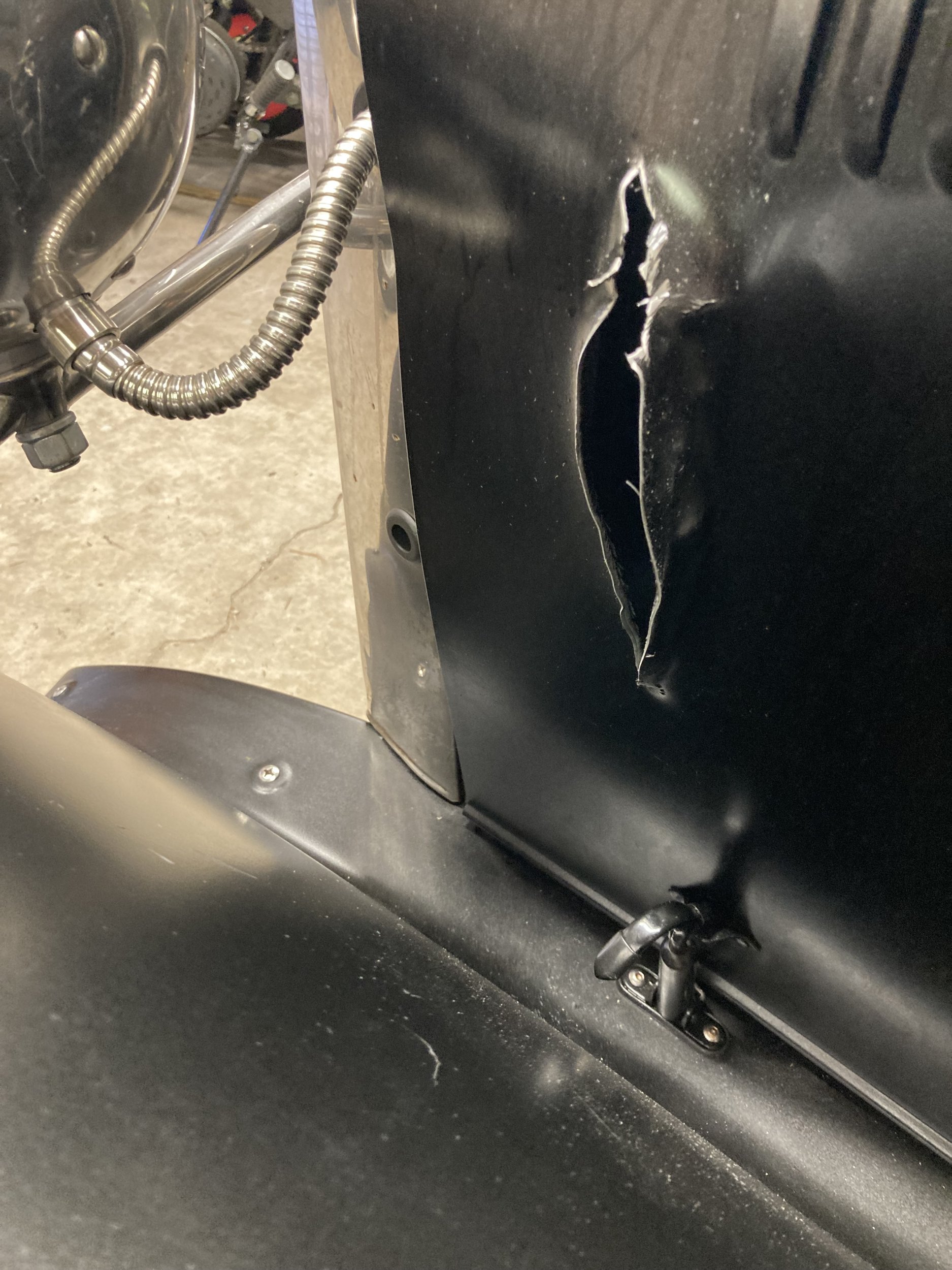

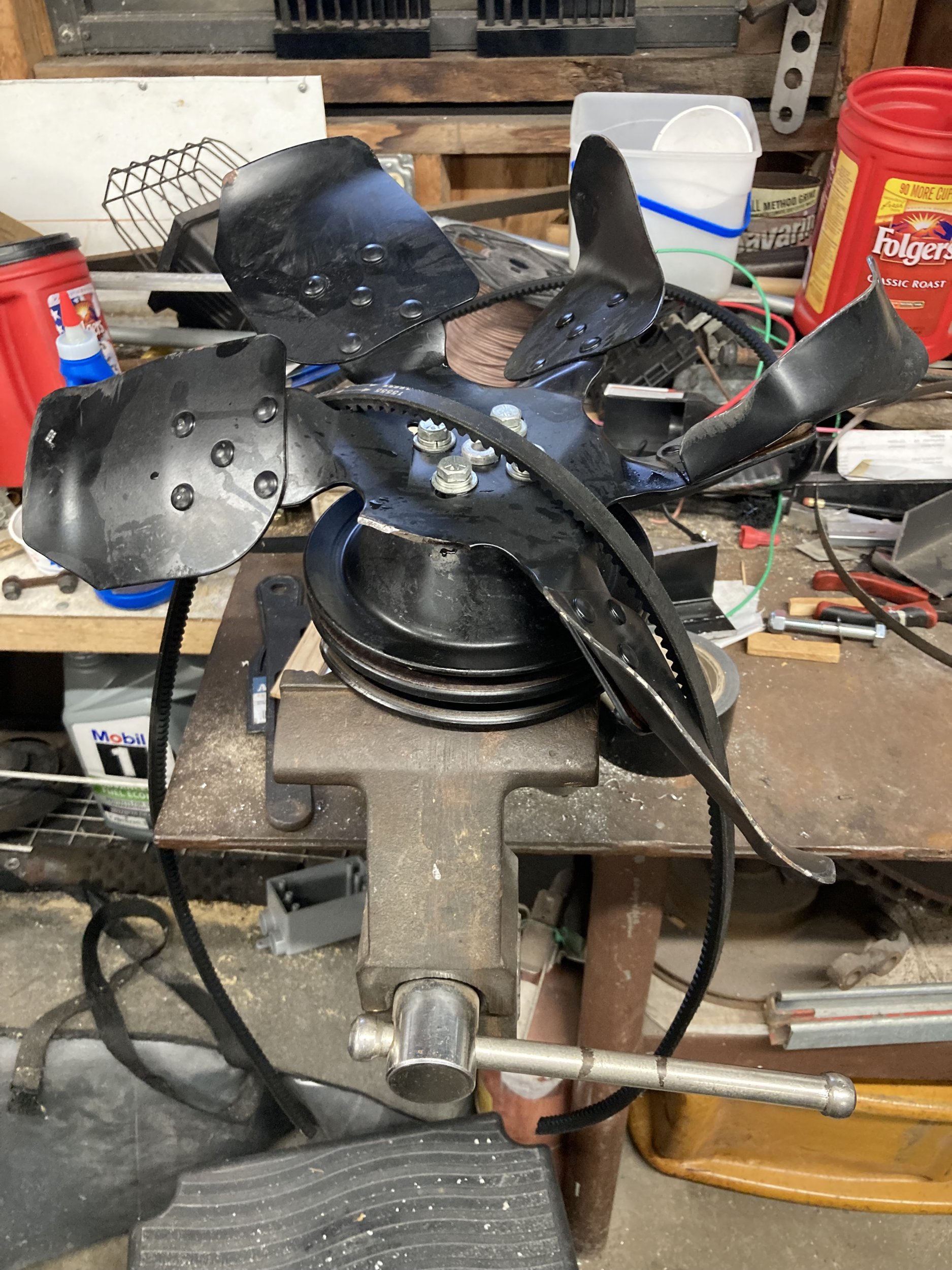

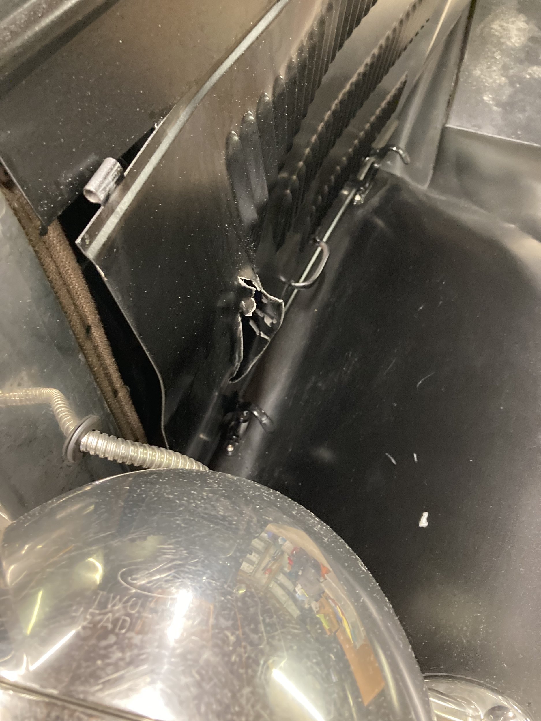

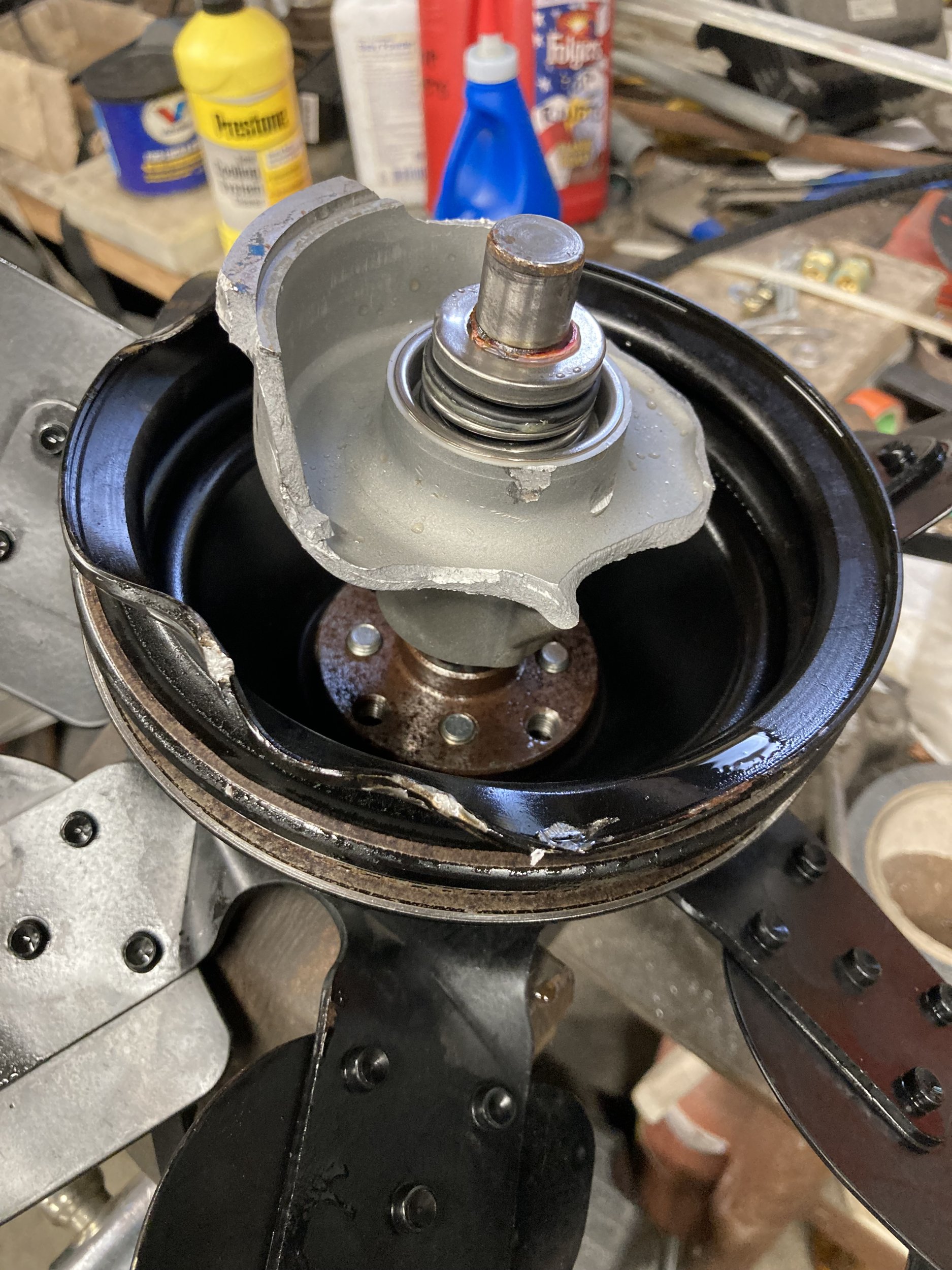

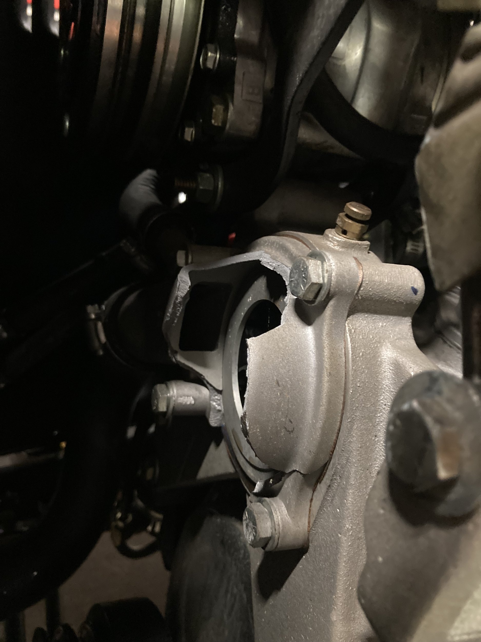

    Stepped on the gas yesterday and car went into p***ing gear. There was a loud bang and some metal came flying by. 1931 Ford with 350 Chevy. Zip’s water pump riser and FlowKooler aluminum water pump. It seems the pump disintegrated and sent the fan into the radiator and out the side of the hood. I have included some pictures. Destroyed my Walker radiator and my hood. About 4,000 trouble free miles on car including previous hard acceleration. Any thoughts?

    Here's an interesting thread that talks about the plate that is riveted to the Flow Kooler Impellor coming loose. Could that have happened to your pump? Can you post photos of the impellor? Open and scroll down.

    The casing couldn't handle the load from the rotating m***...

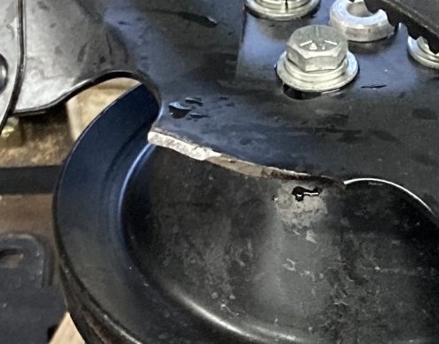

    The fan broke first, it had been cracked for a while. Look at the telltale pattern on the end where the blade used to be. The pump housing could not handle the imbalance, and it broke from the off center weight spinning that fast.

    WOW! That fatigue crack sure tells the story. Thanks for posting.

    ^Good catch Jim! Lots of m*** there and an imbalance would overstress that thin casing quite easily.

    Yep, Jim's correct. That blade's been broken long enough to show rust in the cracked part. The last half inch has been holding it.

    Squirrel is right, I had a fan blade let loose on my stock Model A and go through the hood, the rust where the blade let loose is a dead giveaway. Sorry it caused all the carnage when it failed, stress cracks are hard to see and almost impossible to find without removing the fan.

    Excess stresses, will ruin the bearings on a OEM water pump.
    This pump looks pretty light.

    The pricing on the Johnsons Walker rads is pretty scary too! Hopefully you'll just need a recore. Fixing the hoodsides will be an interesting job, not insurmountable though.

    I'd say that the consensus is correct, that was an already cracked fan coming apart. I'd say that isn't a new crack though.

    The missing fan blade was the first thing I noticed in the carnage left behind. I hadn’t looked at the fan closely after the fact. I was more concerned with getting the car home. This was a new steel Derale fan from Summit Racing, maybe 2 years old. I’m glad no one was hurt and that it didn’t let go on my trip to Louisville this summer. I can always replace parts. I did not want an electric fan on my car. I guess stuff happens. Thanks for all the replies. That’s why I asked. The only thing hurt will be my wallet.
