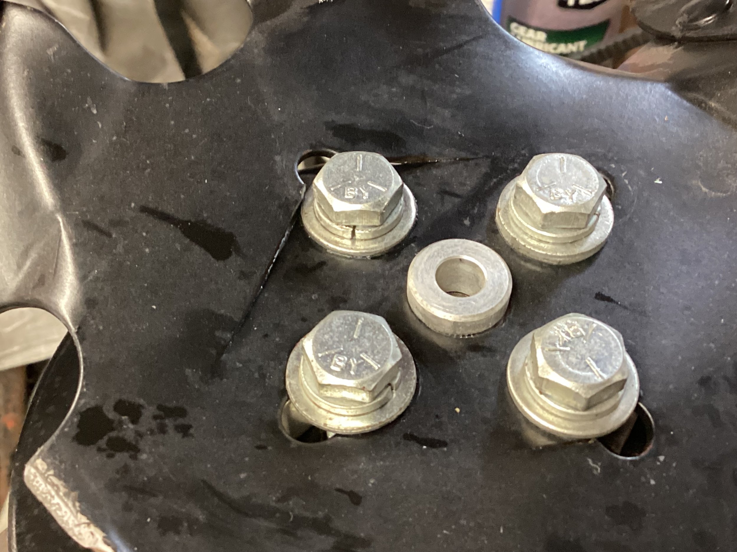

  10. ibspector
    Joined: Dec 4, 2010
    Posts: 14
    ibspector

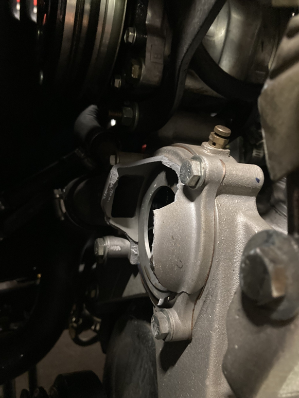

    I will do that. Fan is rated 6,000 rpm. I was nowhere close to that. Looking more closely it was metal fatigue for sure. I’m beyond the one year warranty and best that Derale will do is send me a new fan. All other damage is excluded from coverage. Thank you for identifying the cause of this.

    It would be interesting to closely inspect the other blades at the same point of failure on the hub to see if any show evidence of distress.

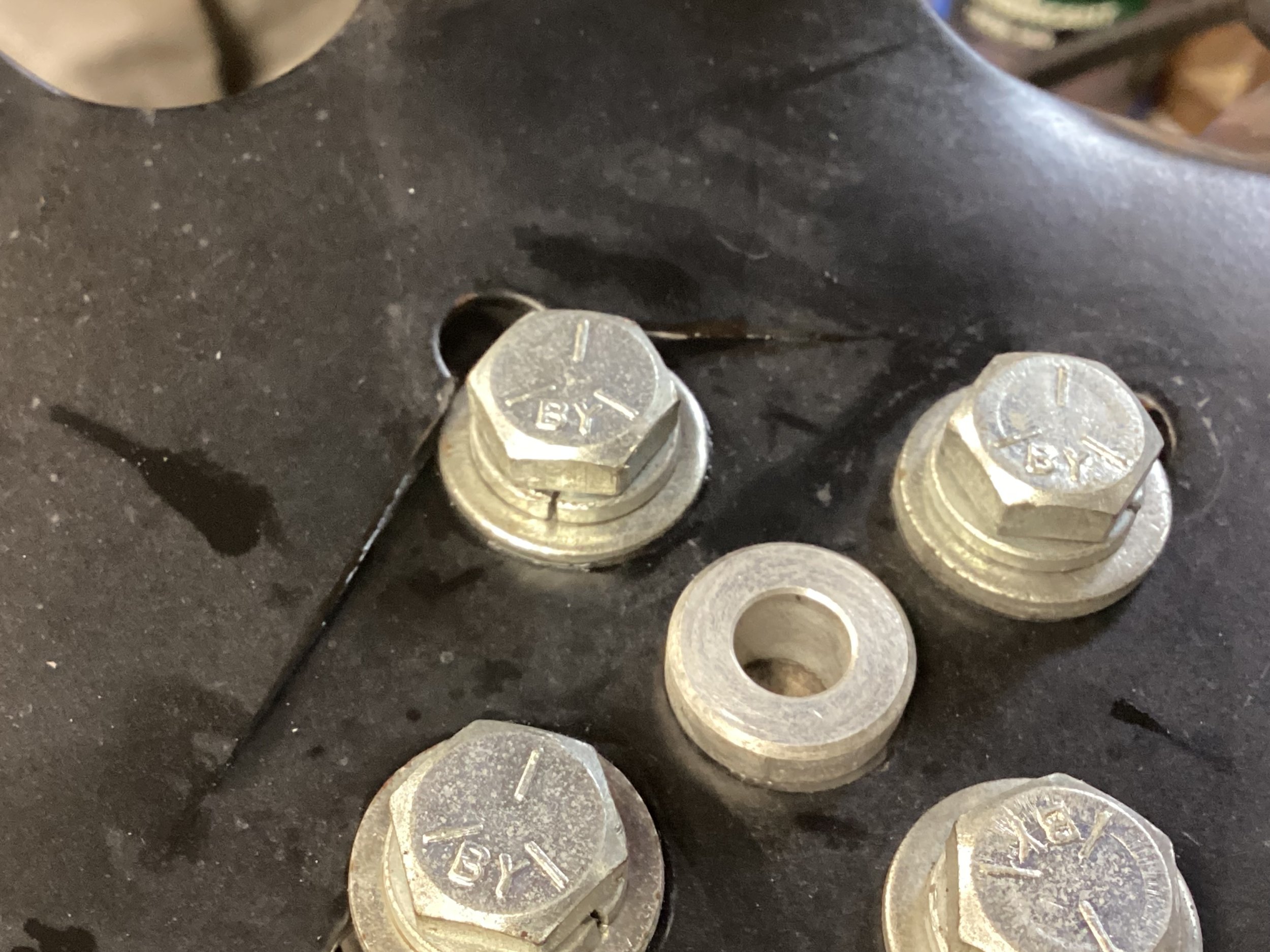

  14. ibspector

  15. ibspector
    Joined: Dec 4, 2010
    Posts: 14
    ibspector
    Thank you to all who took the time to reply. The fan certainly appears to be the culprit. I was in p***ing gear for maybe 2-3 seconds before this happened. We have about 4500 trouble free miles logged so far including a cross country trip to the Street Rod Nationals earlier this year. I’m grateful no one was hurt and at least it happened close to home. So I’m thinking mfg. defect and not my driving.

    So, not saying it could have been a fan blade breaking first, but could it have been a faulty casting on the removable plate at extreme temperatures and continued usage? In all of the years driving with a one piece cast water pump, on all old chevy cars or other hot rods, we never had any type of blow out. Leaks, yes, easily repaired and re***embly was a simple reverse process.
    Jnaki
    So, why was it a two piece water pump? And two pieces give off twice the accident prone actions as a one piece cast water pump. There are such things as a poor casting on the ***embly plant production line, so, this could have been one of those time. It just chose that moment to crack and the high pressure expanded the crack to a larger crack and a full big old hole. YRMV

    What would cause the metal to crack? If it was caused during manufacturing I think the crack would have been evident at installation. If it’s a metal problem and the crack happened over time the manufacturer might have several fans out that may fail. Recall? Is there any evidence of more cracks, can’t see in the pics.

    Dan, The metal cracks over a long period of time due to flexing of the fan blades. At first the crack is microscopic but, as the metal is constantly flexing, the microscopic crack enlarges, becomes visible and eventually fails. Even if the crack wasn't caused during manufacture constant flexing after installation can result in failure. You can see it happen when you crush a soda can and then bend it until it develops a crack and fails.

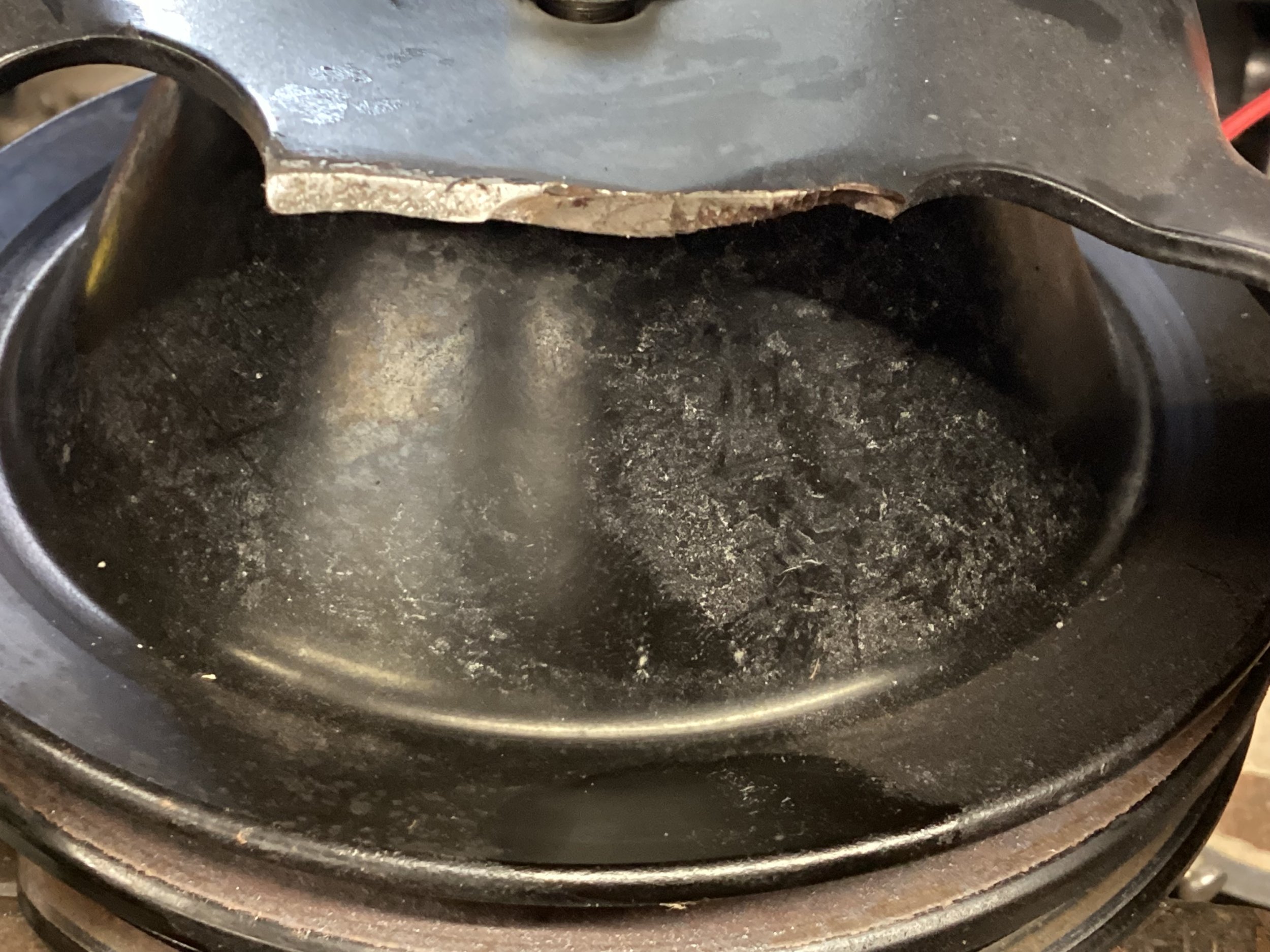

  27. That's a better pic. Clearly shows no paint on 1/3 of the break.

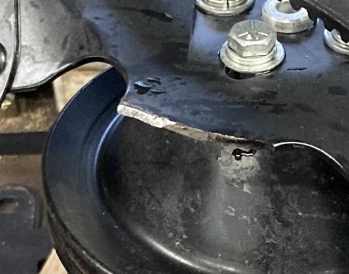

  28. ronnieroadster
    Joined: Sep 9, 2004
    Posts: 1,207
    ronnieroadster
    Agree with the broken off fan blade causing the problem. The off balance created by the missing blade would cause a big mess especially when the engine revs increased. In the last century I had a fan blade break on my Ford flathead V-8 that loud bang sure scared the hell out of me but I was lucky one of the lower radiator hose's gave up its life the blade dug into that hose the radiator was saved. From then on I always look carefully at any fan blades prior to using them.
    Ronnieroadster
    Tow Truck Tom and Sharpone like this.
  29. gene-koning
    Joined: Oct 28, 2016
    Posts: 6,231
    gene-koning
    I worked in factory maintenance for several years. Any time there was a machine failure that involved a crack, we had to do an inspection of the crack to determine if it was a one time event, or had been in the process for a long time.
    ALWAYS, when you look at the broken surface, you can identify if the break was sudden or not very quickly.
    If the entire length of the broken piece is bright and clean, it was an instant failure (in the original post, I suspect an inspection of the water pump's broken surfaces, will find the entire surface was clean and bright).
    However if part of the broken piece is bright and clean, but part of it is darker and more dirty looking, the failure has been in process for some time. The length of time can be very hard to determine because of the environment the broken piece resides in. The more dirty the environment, the shorter time frame for the crack to get dirty. Generally, the fan area of a car is considered a clean environment, unless there is a significant leak of some kind.
    When a crack starts, the dirt from the environment invades the new space in the metal. The dirt replaces the bright clean surface of the metal as the crack expands. As the crack grows longer (through flexing), the dirt still enters the first part of the crack, making it appear to be darker.
    When you look at the broken part, the darkest part of the broken surface was the starting point of the crack, the part that is still bright and clean was the last part holding before the total failure. Usually you can see the progression of the crack based on the darkness of the crack surface.
    Based on the pictures of the fan blade, the one side at the every edge the first 1/8" or so is very dark, that was where this crack started. The darkness grows lighter until you get about 3/4 across the surface, then that last 1/4 is very bright and clean looking. That was the last part to break. The entire rest of the crack has been flexing for some time.
    I also suspect that the cracks at the mounting bolts are probably pretty clean and are probably a result of the fan flexing from the missing, or in process of separating blade (or even caused by the water pump failure). It would be necessary to at least look more closely at those cracks though. If those cracks appear to be more dirty then the crack at the blade, the fan could have started flexing there and caused the missing blade to come into contact with something that caused its failure to start. based on my 1st look at the mounting bolt cracks, it looks pretty clean, leading me to believe it was a result of the blade departing.
