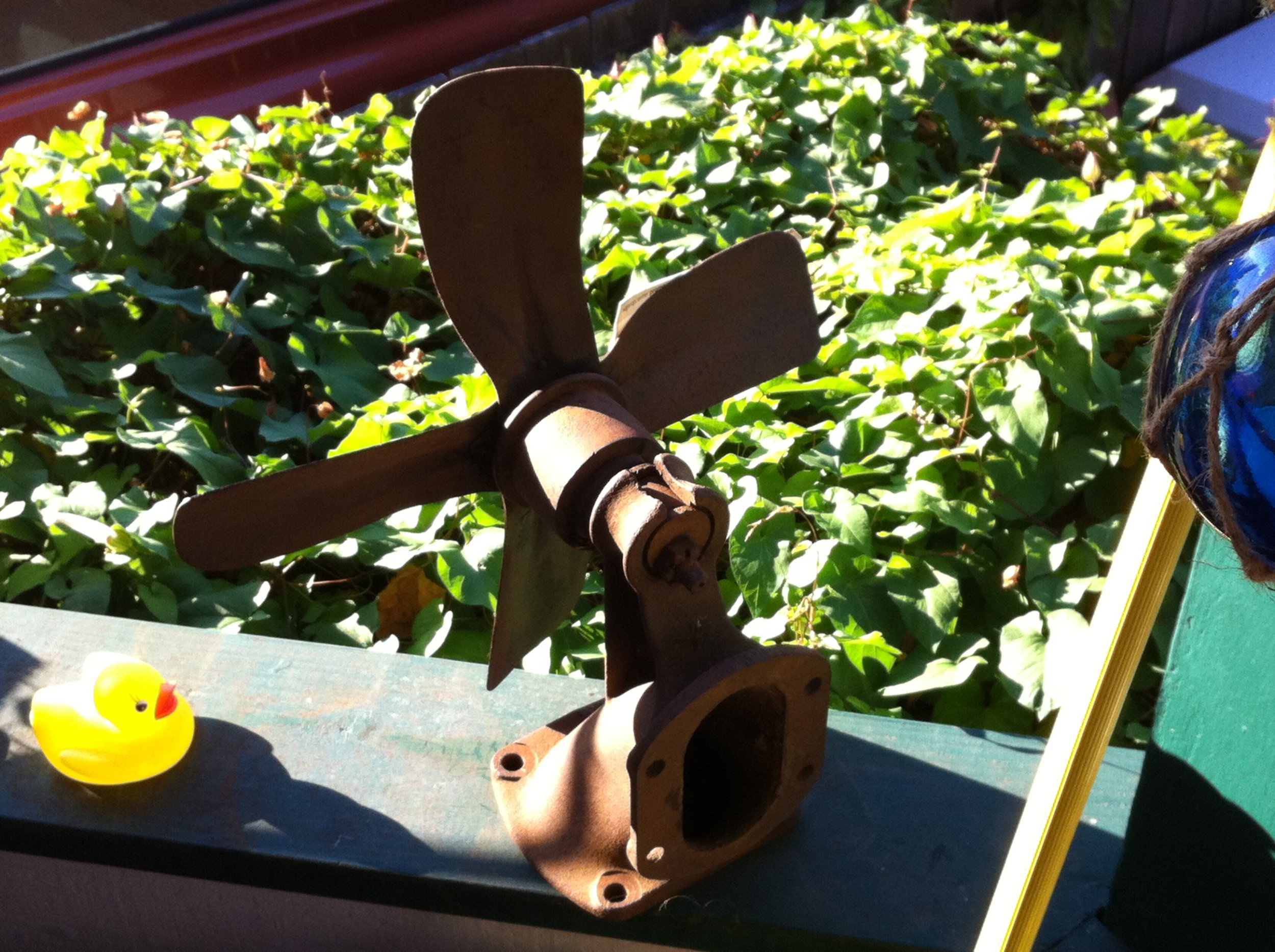

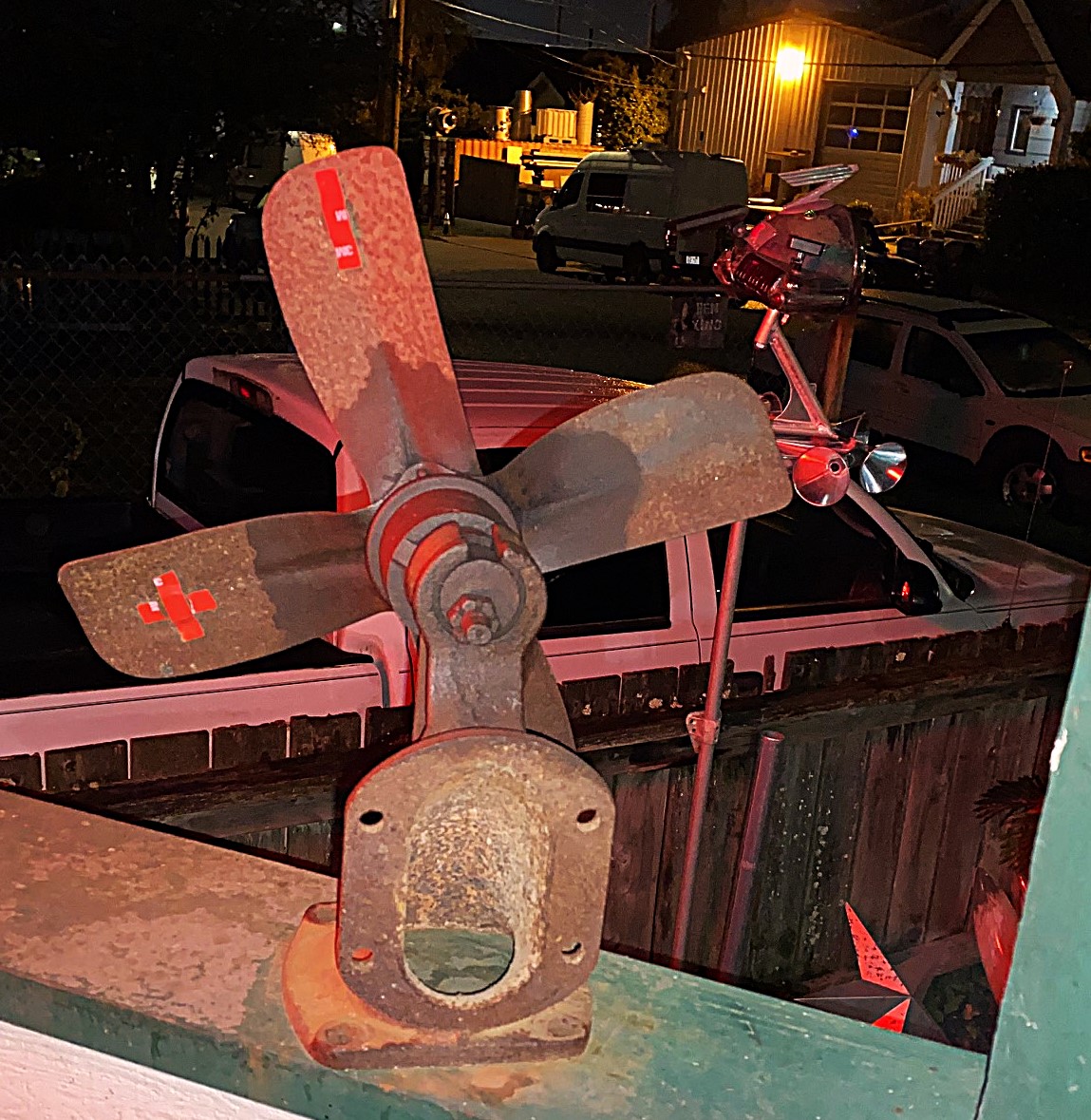

    I bought this ancient belt driven fan, that was part of a water p***age from some type of industrial engine, years ago at the Portland swap-meet.
    It has a bearing housing that is a oil reservoir. When I saw it at the swap-meet, it was just spinning freely in the wind.
    Paid $3.00 for it.
    It's just a cool unit that sits on my front porch, doing it's thing.
    The thickness of the metal on these blades, is testament to how well the old stuff was made, built to last a lifetime.
    Everyone's results may vary greatly!
