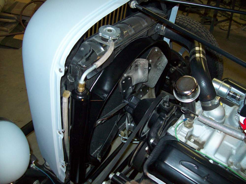

    IMG_5623.JPG I used a "fragrance" container that was gifted to me from an old Army Buddy. His wife made soap and had lots of different aluminum containers. Simple and it works.

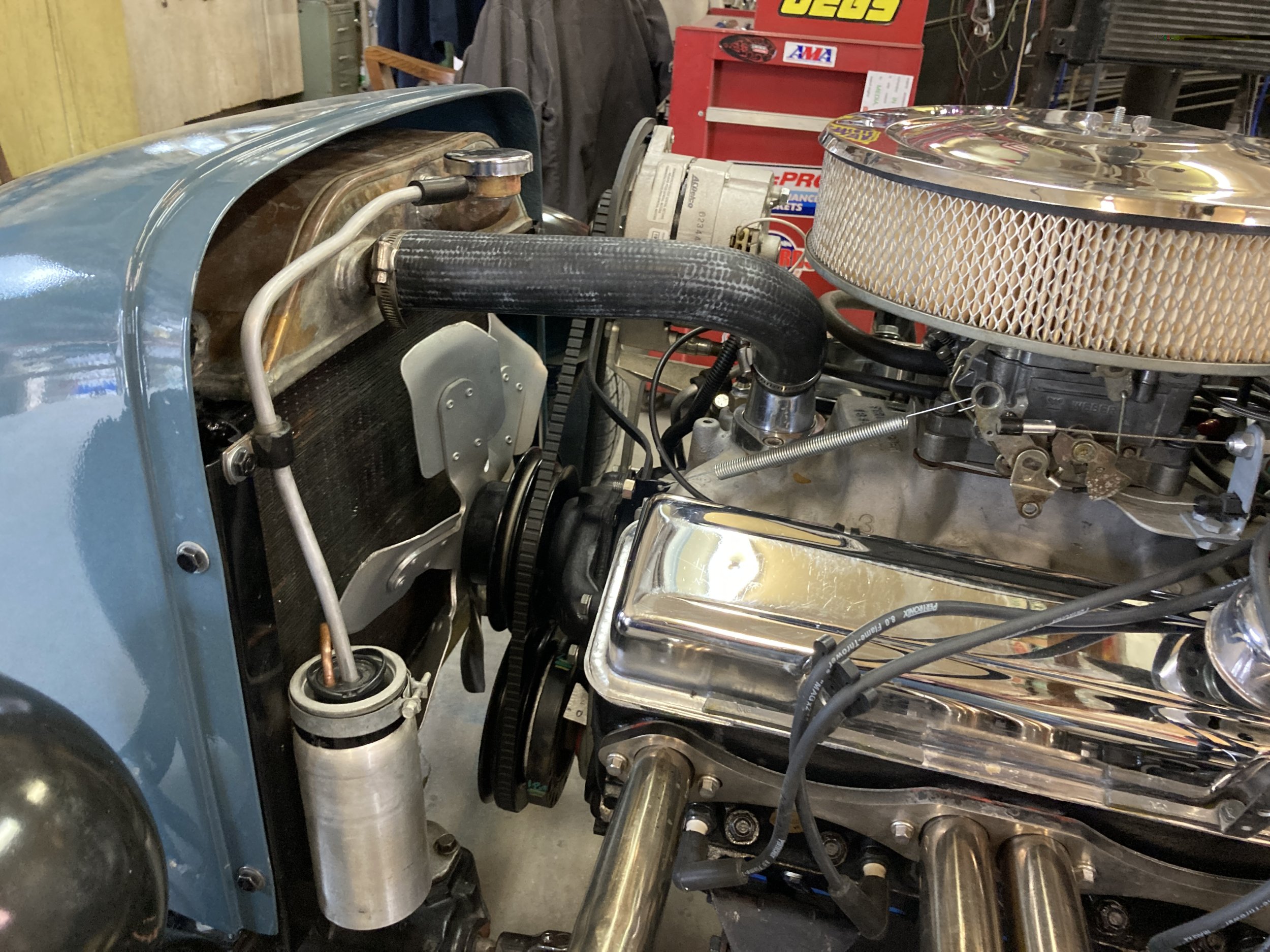

    Digging around in my stuff,I found my lunch box canteen,it's stainless steel an I thought ,just the size I like. 008.JPG

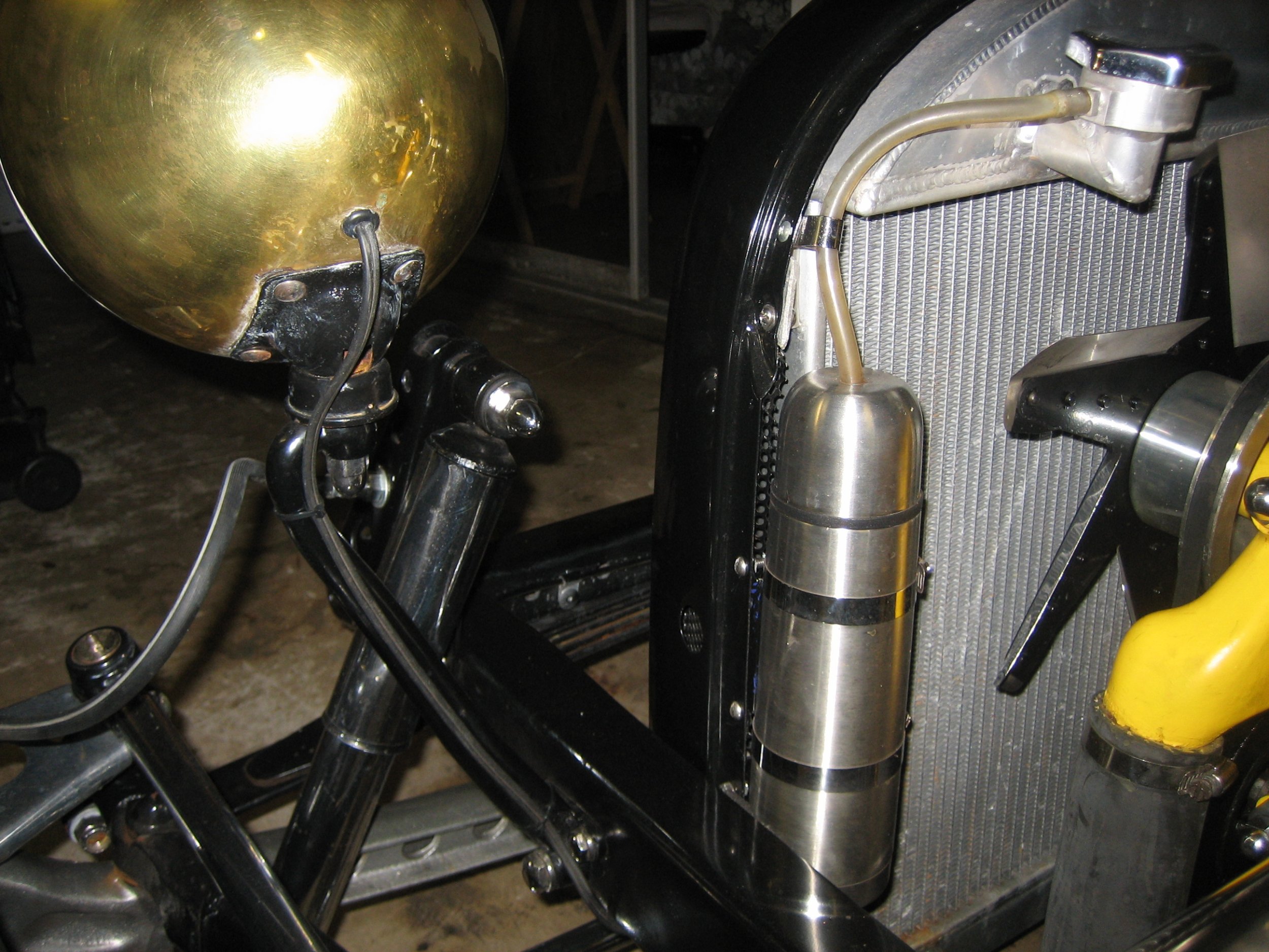

    Mine is just a boring piece of aluminum conduit with ends welded on, then turned in a lathe. Inlet tube goes to the bottom for recovery. Has a petcock on the bottom for draining. My Henry J has one also but with a raw aluminum finish.
