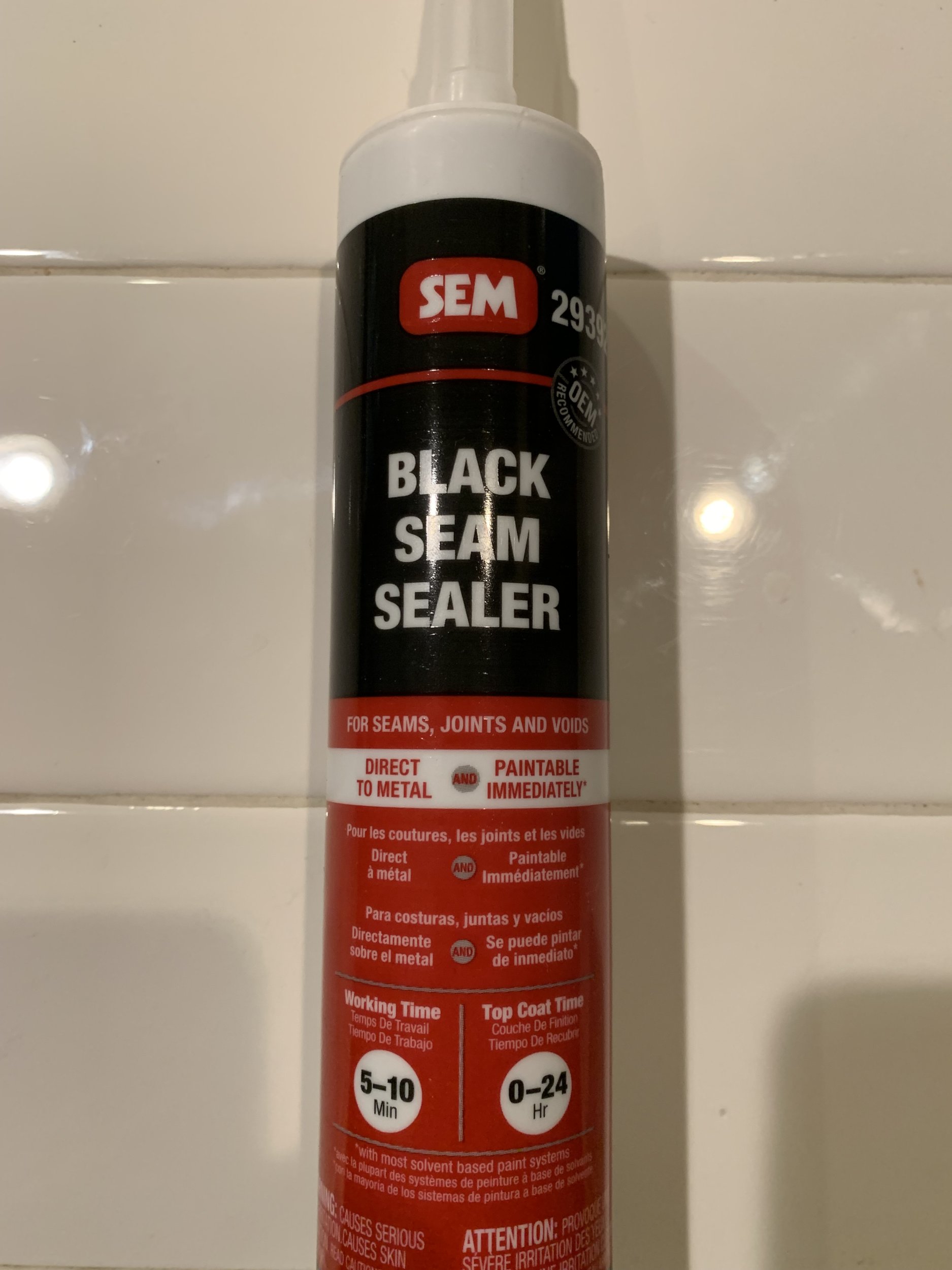

    I use this a lot. About $20 at my paint supplier. I use the acetone trick to smooth it out and I prefer the black over the grey or white unless I was spraying light gray or white paint over it.
    However the color of the sealer probably makes no difference on the top coat.
    Another tip is I try to remove most of the old caulking, both the flaking parts and the parts that aren’t before I use the new sealer. The old sealer that isn’t loose might become loose in the future

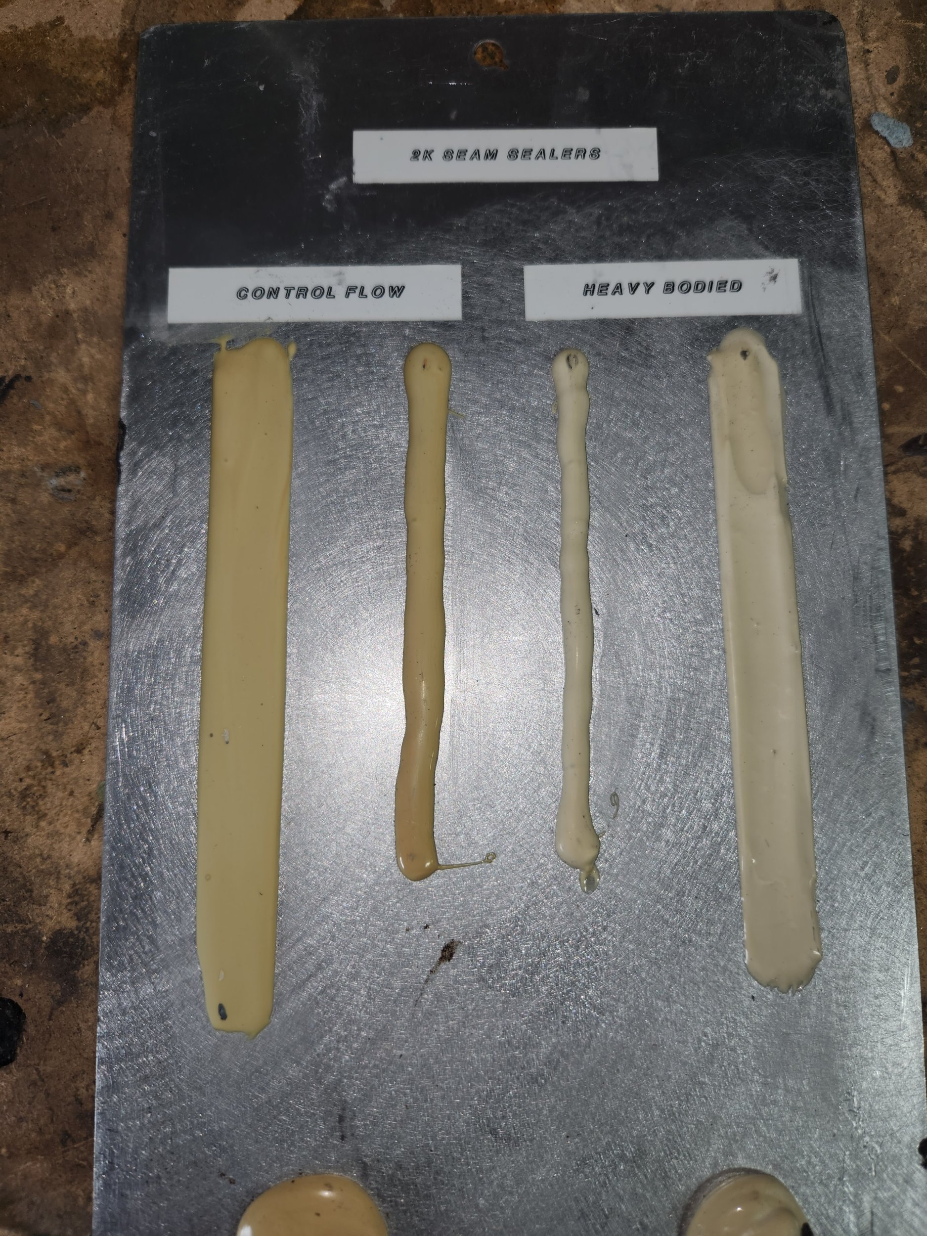

    If you are doing the roof or anywhere it will be seen spend the extra money and get a good quality 2k Epoxy control flow seam sealer. Forget about the Por 15 just get it cleaned up really well gun it out give it a super quick wipe with your finger and leave it it will flow out to perfectly smooth. If its an area that needs an edge tape it and do the same thing. It will look like the sample on the far left every time regardless of how experienced you are.
    INVISIBLEKID, 1Nimrod and tb33anda3rd like this.
