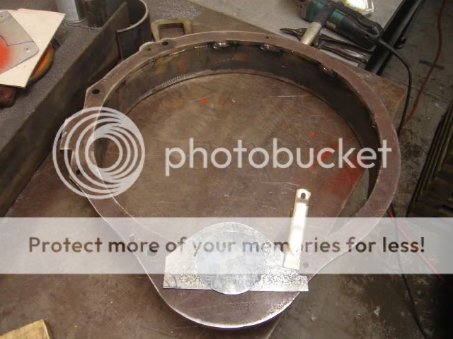

    The first part was making a template for the tranny.
    The circle was about 4 3/4 " and this was perfect.
    I've found galvanized sheetmetal is one of the best template makers.
    a pick hammer found the holes...
    and a little trimming an almost perfect template.
    Since we have alot of scrap at the shop, decided 3/8" piece for the ends.
    and some really rough torch work.
    I didn't want to over cut it...
    After a couple minutes of grinding...
    kept on using the template to spray the area to be ground out.
    would use the "rub the paint off" method to find the parts out of round.
    Than when the hole fit the tranny,
    eyeballed the center punch to the bolt-holes...
    and drilled a small guide hole.
    Than cleaned up the outside with the circle sander.

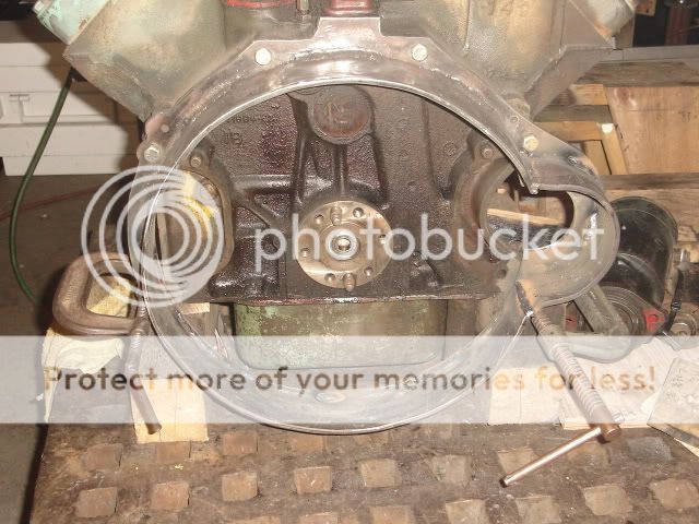

    The engine side was more difficult.
    Here's what we got to start with.
    It is an octagonal engine, with a round flywheel.
    I hadn't really looked as much at the rear, so any ideas I'd been sleeping on were kinda useless.
    The flywheel goes outside of the block.
    The STOCK bellhousing is a TOP HALF bellhousing.
    using a large bottom pan to cover up the flywheel.
    At first the idea was to copy that,
    but it just didn't as rigid, especially since the engine is so heavy,
    engine to tranny sag is an issue.
    Another issue is the starter takes up a huge section of the passenger side.
    For some reason there are no bottom threaded bolts either,
    so the whole thing rests on those 4 top bolts!
    The other thing I didn't realize is the saginaw has no tranny mounts.
    The bellhousing will also need to double as the rear eng/tranny mount.
    (The stock caddy has a rear mount though)
    So decided as obvious by the multiple templates needed,
    to make a full circle bellhousing.
    The templates were only half used though.
    After alot of blank stares,
    figured out the smartest way was to make a circle as big as the flywheel, about 16",
    than another circle 1 1/4" bigger,
    And use the templates to mark the areas that went outside of this minimum circle,
    and add enough flab for the starter.
    After some much better torchwork, whittled it out...
    Once the ring was ground a little closer to fit,
    did the center punch trick again and popped some holes...

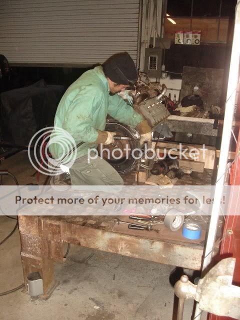

    using the circle cut out,
    made a jig to make an extension.
    I had imagined using flat plate, and bending it in wide strips,
    but the circular problem mentioned before changed that.
    So me and no-glove friend Pigpen (luke) started the torch-work.
    if you notice his gloves are on that burnt piece of paper on the left...
    Fortunately no burns though.
    After alot of heavy duty heat and dolly work,
    got the ring into a resemblence of a circle...
    It actually sprung in a little, not out.
    and tacked it on to the mounted base.

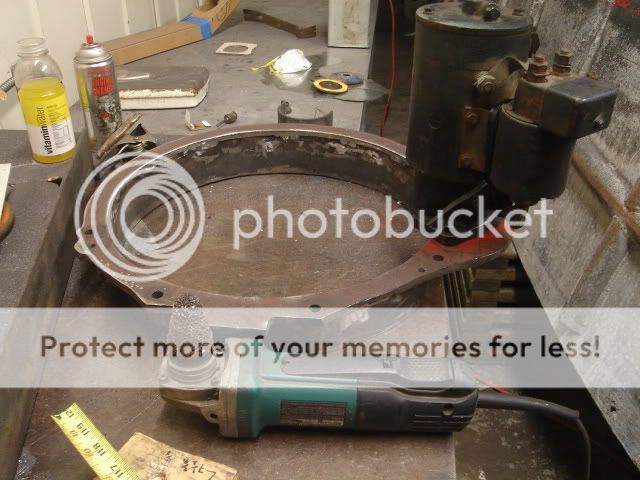

    OK so the starter.
    First figured i'd better attach the flywheel a little better.
    The flywheel is weird,
    it is a solid steel flywheel, attached to a flex-plate like thing made of copper,
    that is sandwiched between two pieces of steel.
    It wasn't on securely as it was removed to weld the inside of the new bell.
    This is serious caveman here.
    If you look back at the block picture,
    there is a big cutout where the starter should go.
    The starter sits somewhere in that arc.
    So first made a template of the arc,
    and then made a template of the circle on the starters base, that goes into the plate.
    Then moved them around til they looked like they'd be right ;)
    of course ran out of white paint so used the worst possible color, the color of fire...
    so of course the hole was too small, but better small than too big...
    This is called a 'donkey dick' a well used one anyway...
    after a little grinding the hole looked round,
    and using the same paint and rub method,
    the starter plopped in as perfect as a grinder could get, like magic.

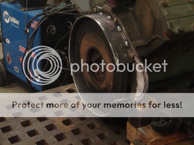

    anyway here's a lunchtime update...
    Attached the pressureplate, and threaded the new block holes, finishwelded the main ring.
    Also threaded the tranny base plate holes, exciting stuff I forgot to take pictures of...
    Started the mock up, this took a couple tries since I forgot the throwout bearing etc.
    But basically centered it with the flywheel bearing,
    then degree wheeled it to the flywheel and tranny plate, and side to side,
    and took as many measurements as possible to keep it as parallel to the full circle.
    The input shaft is about 5/8" shorter than the caddy,
    but there's just enough room for a couple variations of the clutch arm.
