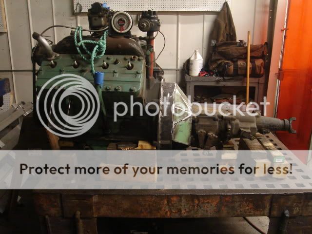

    While it woulda been nice to use less pieces and heat/brake-bend that plate,
    it easier to get it more precise with the template-cut-weld method,
    less grinding to fit this way.
    TP

    That's quite an undertaking. How are you keeping everything square and true?e
    Getting the trans mount plate square to the engine and having the input shaft on the trans exactly centered in the end of the crankshaft has to be a challange.
    I could visualize a few of the guys milling the plates out with their Bridgeports but that is unreal.

  8. I'd recommend attaching a dial indicator to the engine's crankshaft and check the runout of the pilot diameter and trans mounting surface... before, during, and after the welding.
    Maybe it is too late, but if I were in your shoes I would have made the trans mounting plate piece of the bellhousing a bit too small and then ground its diameter and face according to what the dial indicator told me.
    Too much runout will cause the clutch to chatter as well as problems with the pilot bearing, trans input bearing, and clutch disc. If the runout were really bad, it could break the trans input shaft or tear the hub out of the clutch disc.
    If you keep the runout down to acceptable levels (0.005" or less), your bellhousing will work perfectly fine. You can achieve that without going to a machine shop. I don't know if it will contain a clutch explosion, but that Cad engine won't buzz that high anyways. Excellent tech - who needs an adapter plate or kit???

    Thanks for the machinist tips!
    We do have a fake bridgeport to flycut? front and back, after everythings all welded up.
    That ****** hole is so tight that when the ****** is inserted it makes a popping sound.
    Its doesn't slide around even without the bolts.
    There is a bearing in the crankshaft,
    it aligns the input shaft.
    Some engines have a bronze bushing which get a little sloppy,
    but this one is an actual bearing.
    The input shaft alignment is based on the slop of this bearing,
    and in the line up "phase" I tried to shim the ****** up near the base plate
    using something like a dial indicator to measure,
    (basically had a magnetic pointer and feeler gauges)
    and it wouldn't budge in there enough to be significantly measurable, esp. not 005.
    Another thing I used was the throwout bearing and pressure plate arms to center everything.
    Yeah this is relying on the circularness of those old arms,
    but what i'd do is rotate the flywheel around and measure each arm (3) at different places.
    Yeah the throwout bearing slips on that input shaft cover,
    which has a little slop, but its very little,
    and my thinking was if it was designed in the system then that was my allowable error.
    even then there's no way its close to oo5 inbetween the bearing and the shaft cover.
    Nothing was rushed really.
    The main concern after all that was really the angles of the block/flywheel/******.
    So when welding it will go in little inch sections symmetrical to the piece.
    Hopefully it'll all work!
    Thanks guys...
    TP

  16. If you're using the input shaft of the transmission to do all the aligning, I was thinking that it might be a good idea to put a dial indicator out near the end of the input shaft and turn the shaft and see if it turns true. It would be a shame to get it all aligned right and then find out that the input shaft of that transmission got bent somehow by someone dropping it off a forklift or something.
  17. toddc
    Joined: Nov 25, 2007
    Posts: 976
    toddc
    You don't need a mill to get the bell housing square and true. The way you have set it up so far will provide a really good start to aligning it ( the hard way );)
    If you setup a dial indicator to turn with the input shaft, and measure against the flywheel face ( at the largest diameter you can swing ) you will be able to check for parallel as you turn the shaft. Just use a grinder to remove the excess metal from the gearbox mounting face, a feeler gauge will give you a good idea of how much. Do this before you check for centre position. The centre position will change when you adjust parallel.
    If you then setup a dial indicator on the end of the crankshaft to measure against the input shaft or the slide for the throwout bearing as you turn the crank, you can measure the offset and correct it by filing holes or offset dowels.
    Its slow and fiddly, but it works as well as any other method.

    I had to dial indicate the bell housing on my Studebaker. It's not difficult.
    Once you get the hole aligned with the crank center line then you drill a hole in the flange and block for alignment pins. I drilled the hole slightly smaller than the pin and used a precision reamer to size it. After the pins are installed you can remove and replace the bell housing without having to realign it every time.
    I had trouble with clutch chatter when I bought the truck. The Stude guys said that not having the bell housing aligned properly could cause this. It doesn't chatter any more with the new bell housing using the same clutch.
    Keep up the good work.

    Someone else stated this is a job that should be done by a machinist. I disagree. Not everything needs to be taken out to the third decimal point.
    When I worked for a Mopar magazine, the editor at one of the competing magazines was known for harping about dialing in the bellhousing, and ran a tech article on it seemingly twice a year. When you hear that enough, you start to think "well damn, I can't just stab the input shaft in the hole! I've got to get a set of dial indicators, a magnetic base, machined shims and washers, and I have to blueprint this ****er!"
    Except for this one fact: they weren't blueprinting the bellhousing on LS6 Chevelles and Hemi 'Cudas as they went down the ***embly line. They stabbed the trans through the hole on the bellhousing and ran the four bolts up snug. And those transmissions survived just fine in the hands of average enthusiasts beating on their cars at the stop-lights on Friday and Saturday night, and every now and again at the drag strip. They don't break out the gauges in the service bays at the local dealership either.
    Now obviously you need to be fairly close, but you don't need it dead-nuts on unless you're racing. From the way it looks to me, I'd say you're doing a pretty damn good job, and once you're done, if it needs ANYTHING at all, a little can be shaved off the mounting face to make it all perfectly square...but I don't think you're going to need it. Hell, take it to an engine shop and have them put it in the decking machine. All you need is for it to be square on the block and square on the trans face.
    If it were me, I'd go with a bronze bushing rather than the roller. I think the bronze will be a tad more forgiving if there is very slight misalignment. I've had two bad experiences with roller pilot bearings, so I'm biased.
    Nice job, and I'll be watching this one! It's giving me some GREAT ideas for making a safer bellhousing for behind the 322 Nailhead if I build a PanAm car. Wouldn't p*** NHRA tech, but it'd keep shrapnel contained a helluva lot better than the stock cast piece or an aluminum adapter.

    Tommy that is a great picture of the dial indicator measurement rig.
    When its all together and double welded,
    That will help set the dowel position,
    probably will use a sturdy bendable pointer though instead to keep the caveman theme;)
    Thanks!
    Ray-we've got a tight mill but don't have one of those rotating tables!
    My brother is the machine-tool junkie.
    I'm happy with a grinder! (and some dave clark ear protectors)
    And Brad i'm with ya on the bronze bushing vs roller bearing.
    The flathead/OD ****** in my RPU has a bronze bushing,
    and since there's so much sag in the stock stamped steel bellhousing,
    there's no way a bearing would last.
    And as to stock bellhousings not being perfect,
    this is the one that was in the RPU that I replaced!
    There is seriously a 3/16" bow in it,
    thats what the angle and bar thickness underneath!
    Yeah bolting it up straightens it out but still.
    Another thing...
    I had planned on needing the bellhousing to double as the rear engine/****** mount.
    (I thought it was a saginaw but guess its an early muncie?)
    The OD unit DID NOT have a rear ****** mount.
    After studying the frame area, it would be difficult to have bellhousing mounts,
    AND room for a sidemounted clutch arm, easily anyway.
    So the idea was to make a vertical plate to attach the rear of the ******.
    Well I pulled another one down to make a template,
    and lo and behold whats there...
    A ****** mount!
    I'm gathering the RICH version is for the 6 cylinders, (embossed in back)
    and the RICK version is for v8s.
    And here's the " do it yourself caveman bellhousing kit" templates!
    I'll update progress shots soon...
    Thanks alot guys!
    TP

    I was at a tech school that has a great motorsports program, and one of the tricks NASCAR teams do for bellhousing dowel alignment is to bore out the holes in the bell that slip over the dowels in the block, so they're way oversized. They they square everything up side-to-side/top-to-bottom with a dial indicator, lay a couple of washers over the dowels, on top of the bellhousing flange, and weld them to the flange. This positively and permanently locates the bellhousings on four of the six planes (side/side, up/down). The trans can sag or be raised too, which is another plane--that dimension is corrected with shims between the bellhousing and the block. I don't know how they figure that one.
    With the method I just described, the bellhousing is permanently matched to the engine block, until you cut the washers off.
    It's quick, and a lot easier than the offset dowels you can buy. And a whole lot cheaper, too.

    yeah on that stock ford one the flywheel is goes outside of the bottom of the bellhousing,
    like the sag was engineered into the design.
    This type really wears out the bushing quick.
    TP

    We nicknamed it the turtle...
    lotsa time between the welds, little 2" runs.
    This 1/4" plate welds so nice.
    The bigger gaps have a couple p***es...
    TP
