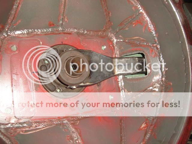

  20. zibo
    Joined: Mar 17, 2002
    Posts: 2,361
    zibo
    from dago ca
    Hi guys thanks for reminding me I need to finish this by the 15th!
    So I had to install the whole chelada to see where the arm should go,
    Fortunately used the rear ****** mounts (see previous pages),
    which cleared up the bellhousing...
    found a perfect spot for the hole.
    Then had to take it all apart,
    a real bummer cause the fenders etc made it look like a car.
    but was able to weld INSIDE the bellhousing finally...
    I figured doing symmetrical p***es would minimize warping,
    (like they would counteract each other)
    This took a while to do,
    cause i took a couple breaks so it wouldn't tweak from the heat.
    Its pretty strong now!
    And just to make sure,
    figured i'd throw it on this mill I never use...
    I'm glad its a big one cause it hit the base right at the end of the last p***!
    Not sure if this was the right cutter but its the only one I had.
    Now the surprising part is it was about .015 " off!
    It looks like alot in the picture but the bit was chipped and it would leave a burr.
    Needless to say if this mill wasn't immediately available,
    I wouldn't have surfaced it.
    Yeah I'm sure you guys noticed I jonesed out and grinded and painted it
    (the flash makes it look turquioise but its really "detroit diesel" almost like the caddy)
    I always liked the prepainted-then machined look,
    plus its easier to see where the surfacing starts...
    I had machined the 2 side "reveals" but one side had blended in during the surfacing,
    so of course I had to redo it...
    and also cut out the hole.
    Now the fun part is figuring the clutch/throwout arm...6 days...(actually nights!)
    chow...
    TP

  21. Kevin Lee
    Joined: Nov 12, 2001
    Posts: 7,675
    Kevin Lee
    Super Moderator
    Looks so great. Dig the color.
    BTW, you need a fly cutter. Easy thing for you to make. (and yeah, I would have just used the end mill too if it was what I had on hand at the time)
    Again, great post.

  24. zibo
    Posts: 2,361
    zibo
    from dago ca
    Kevin, that fly-cutter looks dangerous, but exactly what I needed...
    Ok,
    been real busy at work but had to squeeze this in by the 15th,
    so workin the night hours on it (and a little day today!)
    made a couple clutch-arm templates, and found one that worked, so cut it out...
    welded it up...
    not pretty but strong...
    looked like it'll work...
    now the pivot.
    TP
  25. zibo
    Posts: 2,361
    zibo
    from dago ca
    ok,
    ya know what,
    first I need to show you all this grinding table I had to make.
    There was so much grinding,
    and the other side of the shop had an aluminum project in it,
    so didn't want to contaminate it, so whipped this out really quick, out of s****...
    there is a "chispa-deflector"so most of it bounces down into here...
    don't have a vaccuum hole in it, and i've dropped some things like a drill bit in it,
    but its a work in progress!
    And man it really helps keep the area cleaner.
    Ok so where were we,
    here's the pivot...
    a stainless steel piece of flat-bar, welded with 309 rod.
    and here's the finished arm, with the pivot stopper and lock...
    this is it installed. it doesn't fall off when upside down, which is good.
    there is alot of travel. Real smooth too.
    Figured the smartest way was to take the input-shaft-snout off and place it in the hole,
    alot easier to work with flat on the table, than vertical on the engine.
    Will still need to drill some holes in the linkage end, but want to wait til its installed.
    Also need to drill'n'tap the starter holes,
    but supposedly there is a smaller starter that might work, so will wait just in case.
    So there you have it!
    TP

  27. Brad54
    Joined: Apr 15, 2004
    Posts: 6,022
    Brad54
    from Atl Ga
    Could you have the pivot and arm heat-treated to make them stronger? I'd be a little worried about the pivot wearing over time.
    (okay, probably A LOT of time, but still. The pivot ball in my '62 Suburban was worn down to a little cone. That had 40 years and untold miles on it, but the pivot is a wear point, regardless of type.)
    Great looking work. It's amazing what you can do when nobody tells you "You can't do that."
    -Brad
  28. zibo
    Posts: 2,361
    zibo
    from dago ca
    Hey Brad,
    I was thinking the same thing,
    so the 2 pegs the throwout bearing rests on are stainless,
    the pivot "bar" is stainless,
    and the pivot "cup" on the arm is stainless,
    all welded with 309 tig rod which can mix mild steel with stainless steel.
    Its not heat treated but it should wear less than mild steel.
    TP
    pir8darryl-it would be cool!
