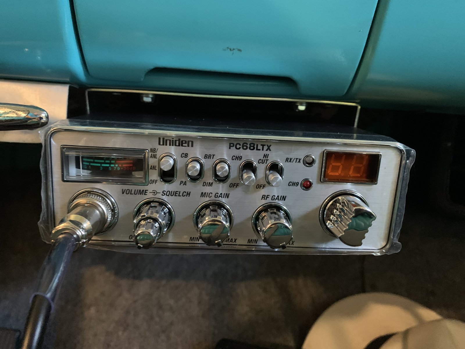

    The radio is a Uniden PC68LTX with a K40 antenna.
    We also tried my friend’s portable Maxon and it did the same thing.
    I addition to the CB problem my Cellphone and GoPro would stop charging at about the same time the radio would stop working. I had a power bank in the car so I charged my phone off of that it it wasn’t affected by the engine running when connected to the separate battery.
    I’m going to try powering the CB from my portable jump pack/tire inflator so that it is isolated from the car.

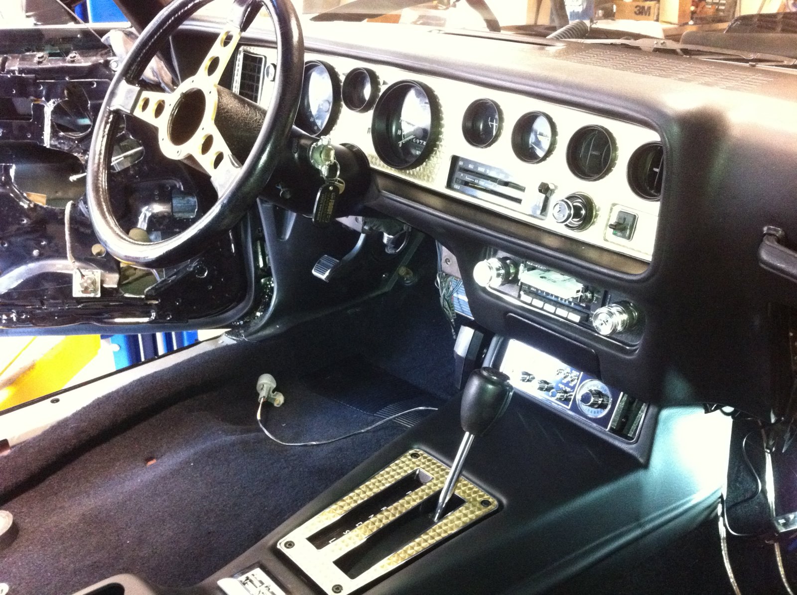

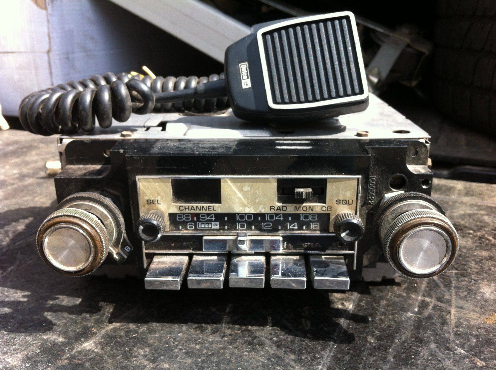

    They are a must for Bandit cars obviously. This one was in my 78 when I bought it.
    But I prefer this look in the 77's. None of that LED display or 40 channel nonsense. Just 23 channels, a VU meter and a PA speaker under the hood so you can chat with the beavers on the sidewalk. Pontiac actually had these as factory options and the face plate for the storage area is still knocked off.
    Breaker, Breaker, this here's the Bandit. Clevis, you got your ears on?
    I never drilled holes in the roofs, I stuck a magnetic mount up there for show and used a splitter on the radio antennae in the windshield. You aren't gonna talk to anyone unless they are within a mile or so. Never had a problem with radio reception but then again these units didn't have a lot of power.
