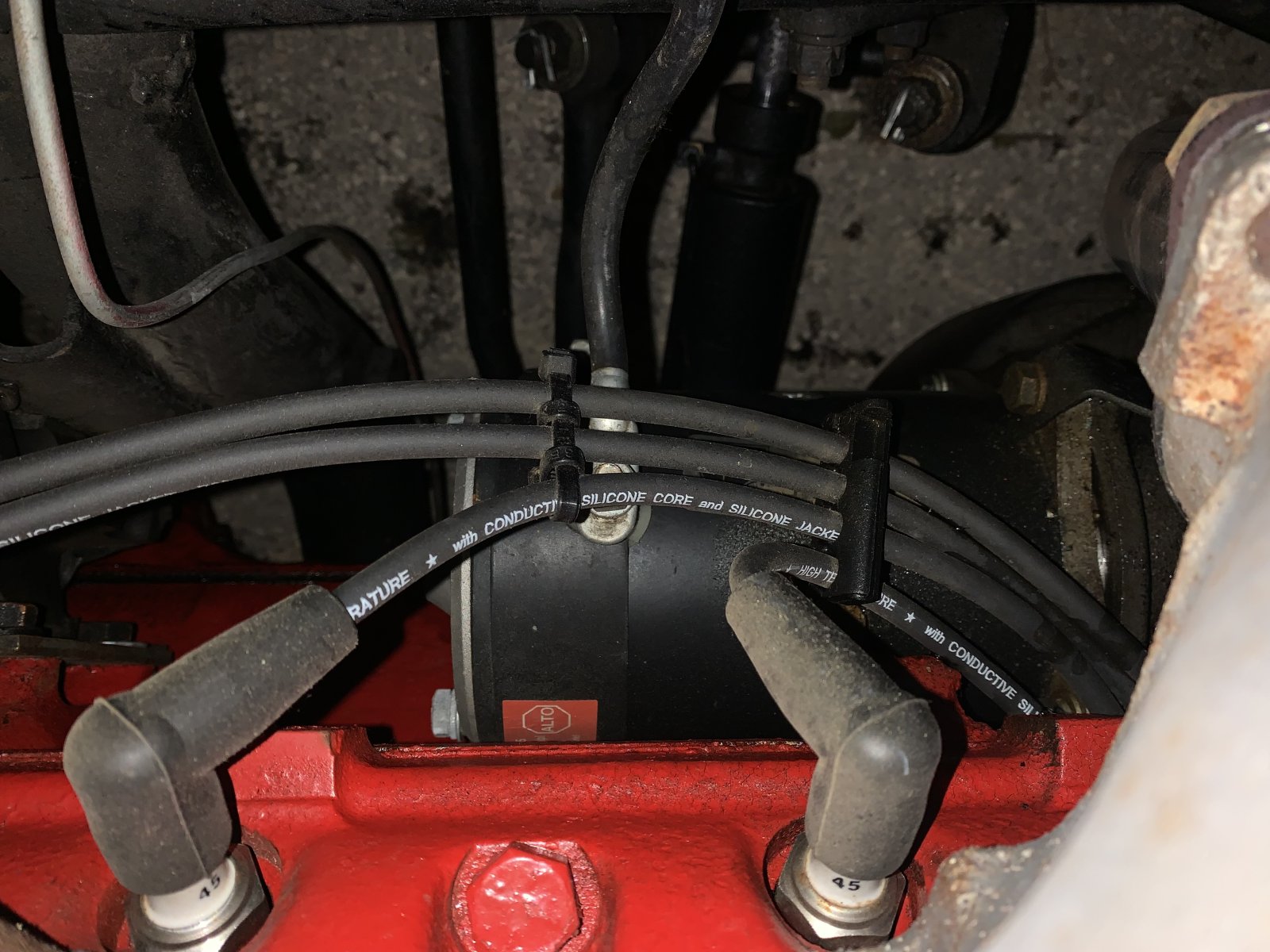

    I have no idea what plug wires are on the car.
    I’ll look to see if there are any markings on them.

    Or measure resistance. Solid metal should be just about zero, so anything meant to have resistance should be obviously different.

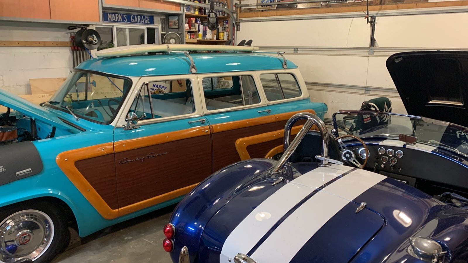

    The woody is fairly quiet,
