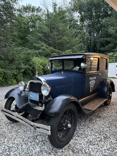

    It's been way WAY to long with this build on hold, but I'm back at it. I moved from Brooklyn to Connecticut and had my dream barn built to store my projects and claimed the house garage as my shop. I had parts ****tered in different locations during all of that an now everything is together in one place. Over this time I really fell in love with my stock coupe along with it's banger and I decided not to mess with it. After a lot of searching I found a local(ish) car that is perfect. It has issues but a good donor I think.
    My 1930 Coupe build has just turned into a 1928 Tudor build.

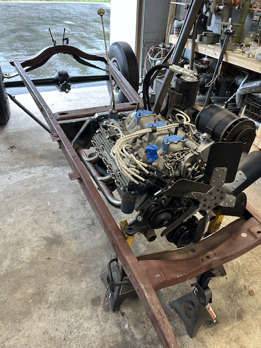

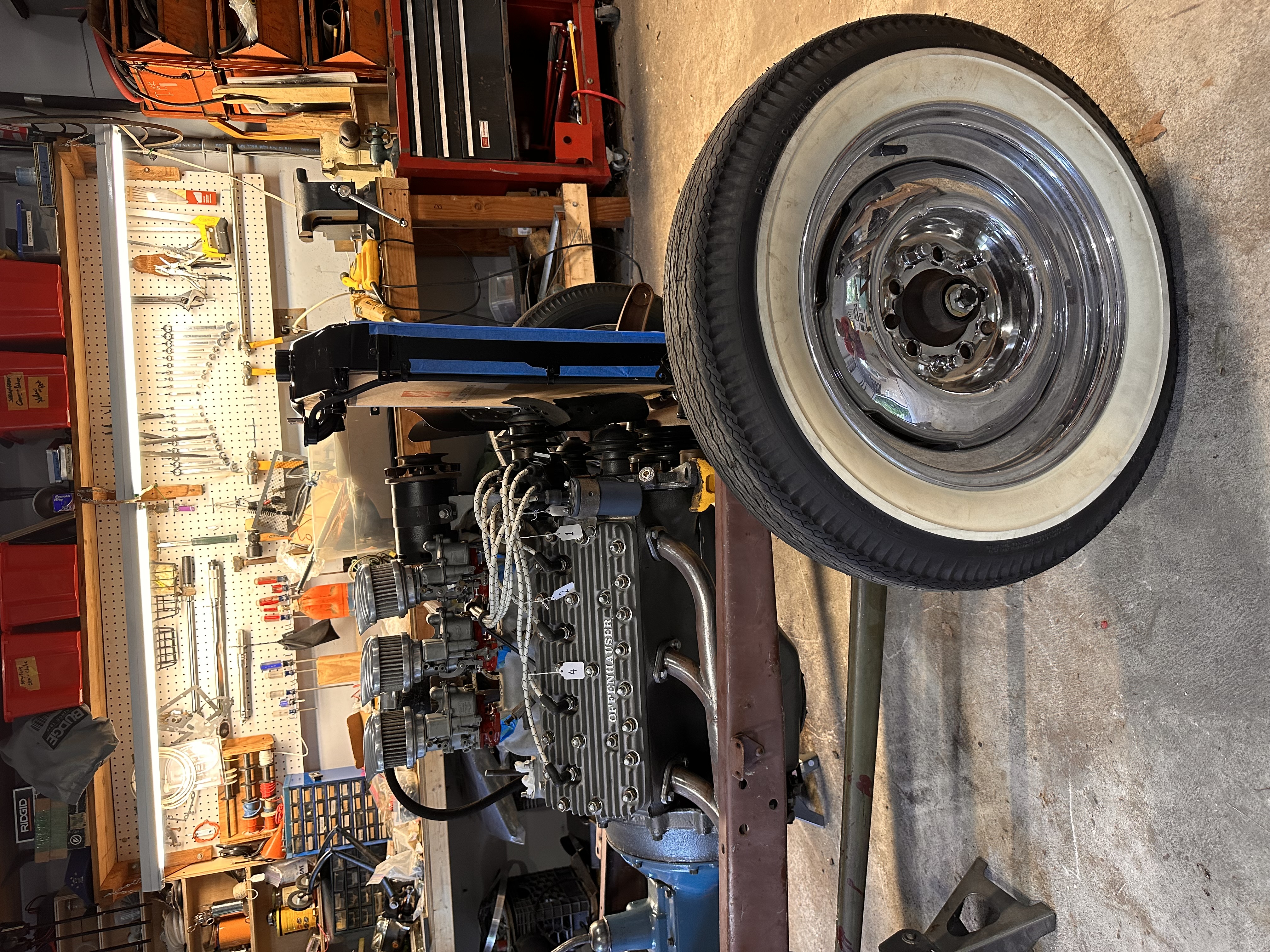

    A few more photos and more important - progress! First test fit of the motor.

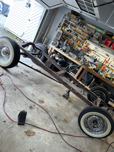

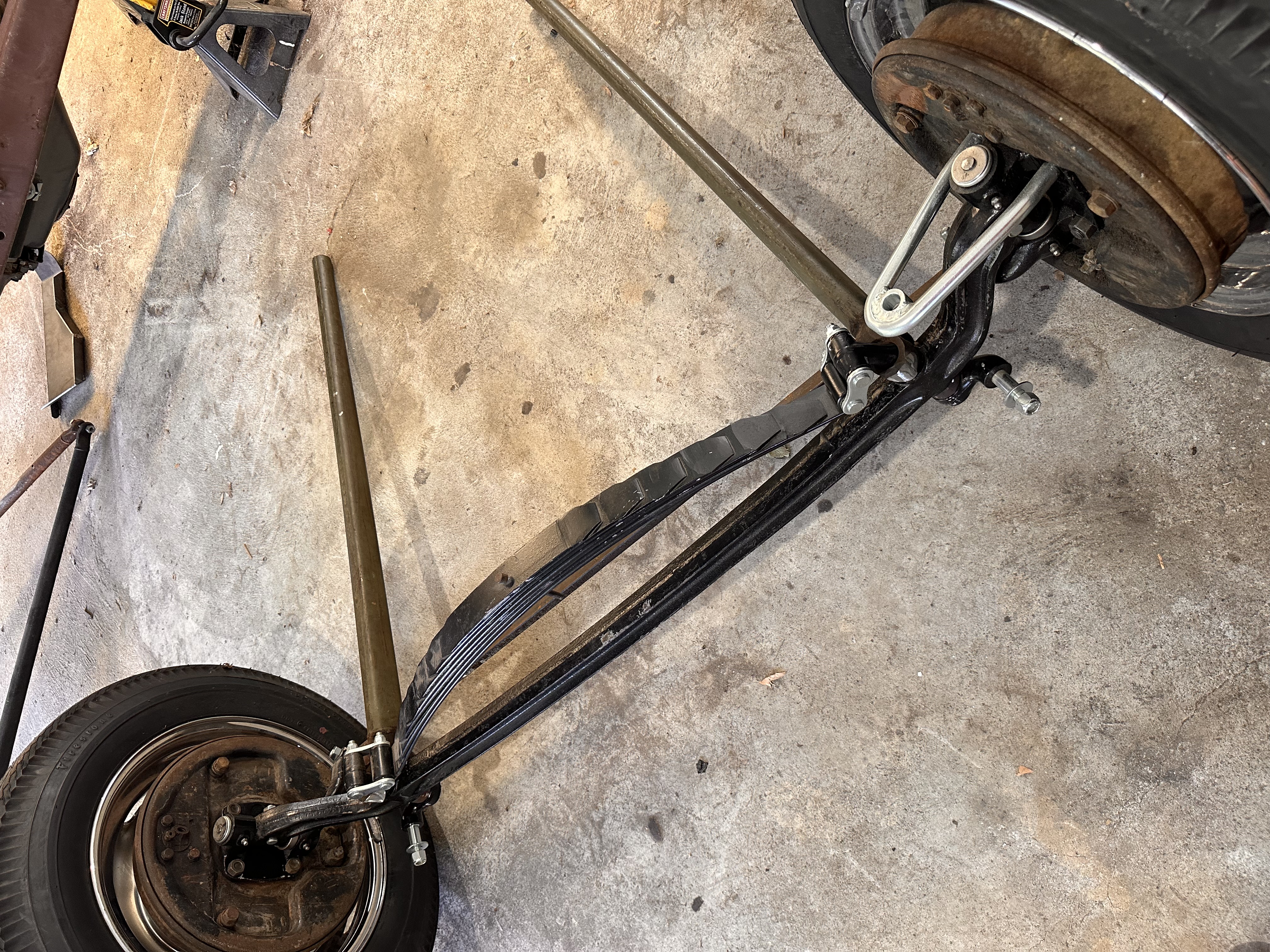

    More progress. Split my bones and I’m mocking up the front end. I’m rethinking my three carbs as it makes routing the drivers-side cooling hose a messy plumbing job. I’m also curious about opinions on the engine placement before I weld the engine mounts in. My choice of truck fan has pushed the motor back further than others I’ve seen. I don’t mind modifying the firewall if that’s all the trouble I might encounter.
    Thoughts welcome.
