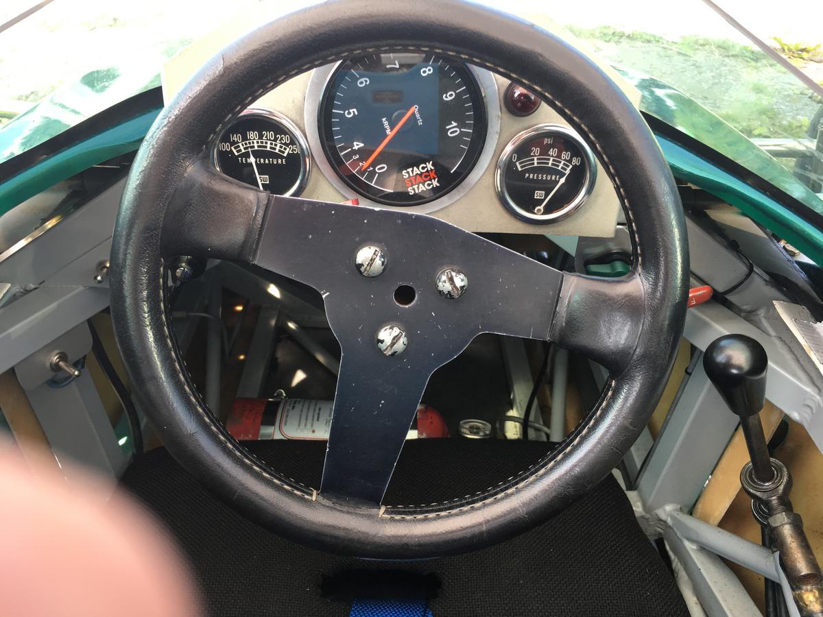

  3. jimmy six
    Joined: Mar 21, 2006
    Posts: 16,691
    jimmy six

  5. THE FRENCHTOWN FLYER
    Joined: Jun 6, 2007
    Posts: 5,980
    from FRENCHTOWN
    Way back when I used a vertical gate between my legs in my altered.
    My latest build uses this auto trans mounted shifter.
