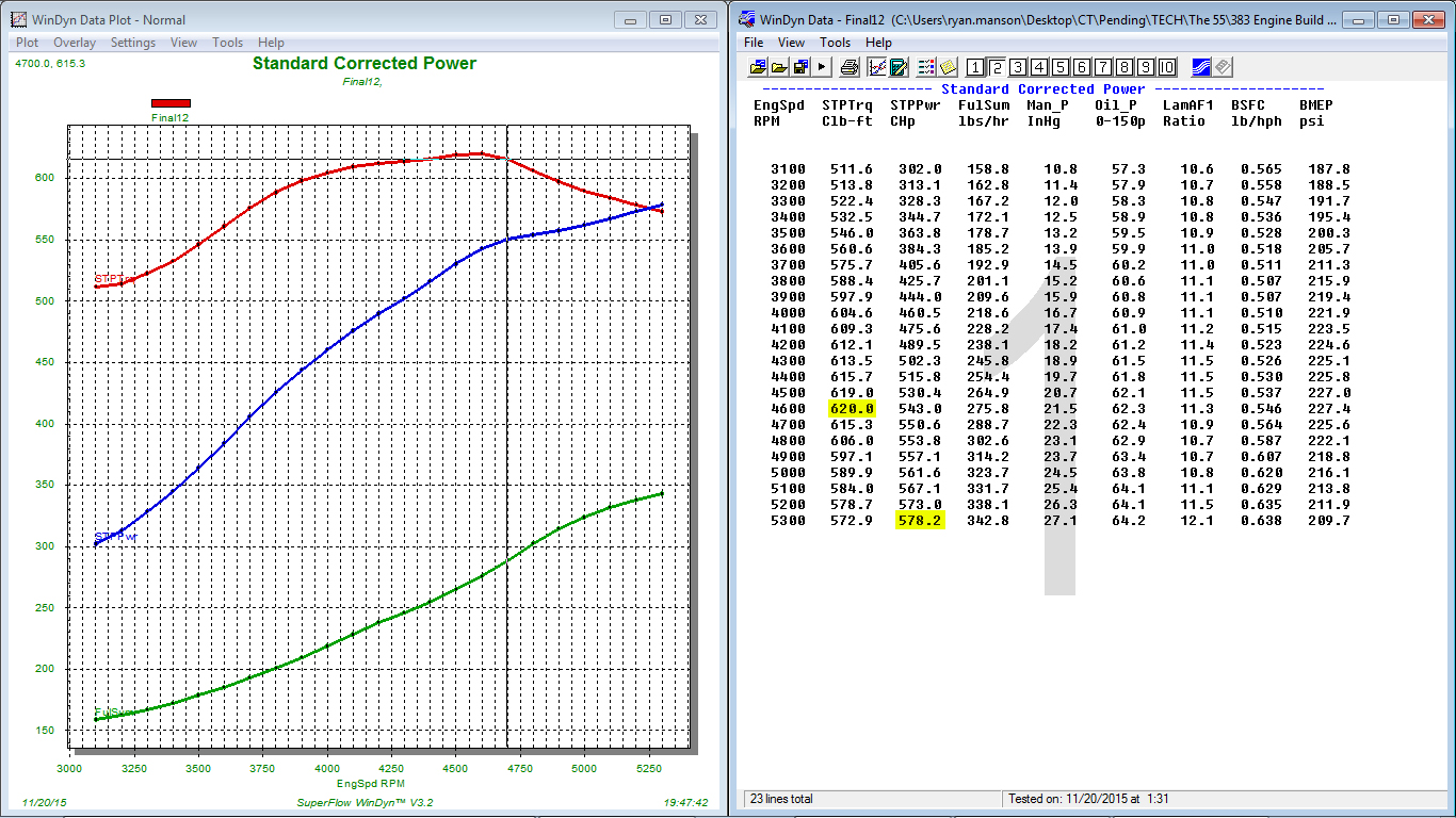

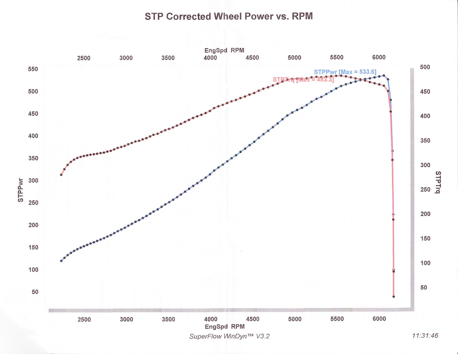

  5. PotvinV8
    Joined: Mar 30, 2009
    Posts: 549
    PotvinV8
    What are the engine specs?
    Some of the things you've stated don't make sense. Keeping things "pump gas friendly" but it only has 8.5:1 compression, for example. That's plenty low for pump gas. On blown motors, that's typically where we start, with a final compression ratio of roughly 10-11:1 with 6-8 pounds of boost.
    Here are dyno pulls on two engines we've built using Torq Storm blowers. Very satisfied with the results. The first was a crate LS327 in a '68 C10 at the wheels and the second, a SBC 383ci on the engine dyno. The cars drive like stock until you push them into the revs. Very user friendly. The '68 we ran through an air-to-air intercooler while the 383 went directly into the throttle body, so it suffers from higher intake temps but doesn't seem to care.
    LS327 final dyno sheet.jpg 33-383 Chevy Engine Build, Part 5.jpg .
