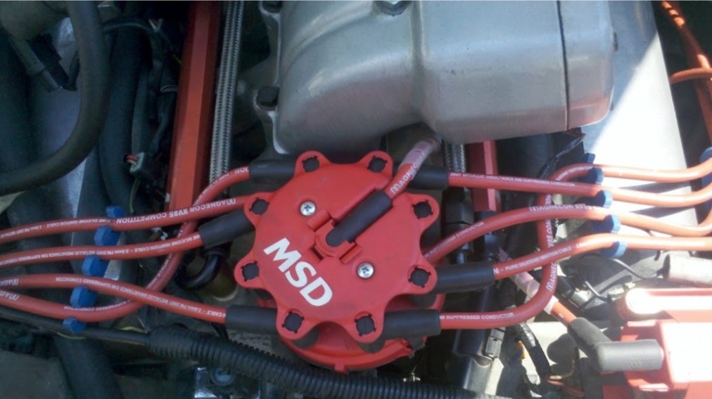

    @blazedogs ,
    On my SBC I have the left side wires in order: 5-1-3-7 (left to right in photo) to prevent 5 & 7 from cross firing.
    On the right side, plug wire order 8-6-2-4. The idea is to keep 4 and 8 as far apart as practical to keep them from cross firing.
