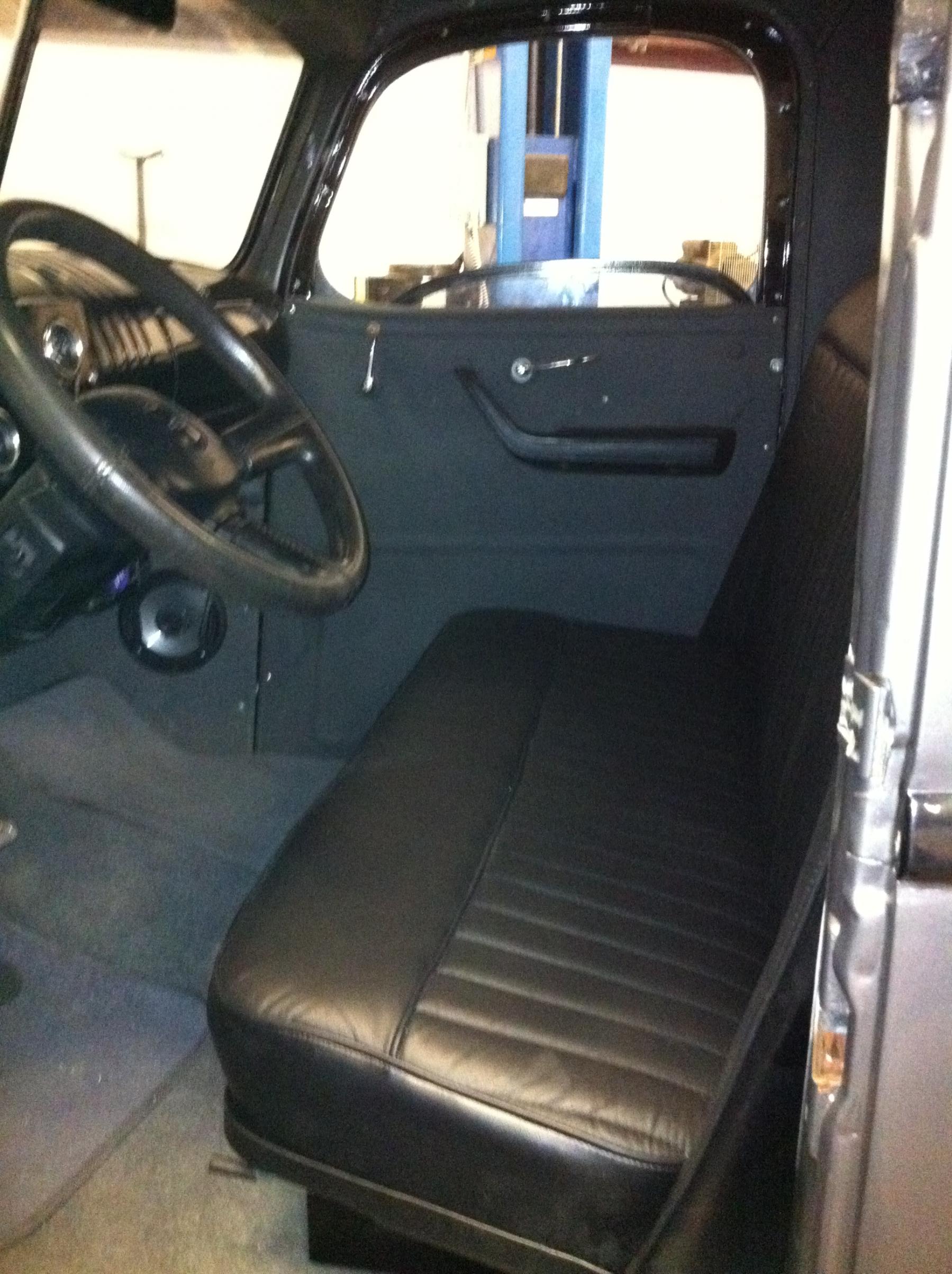

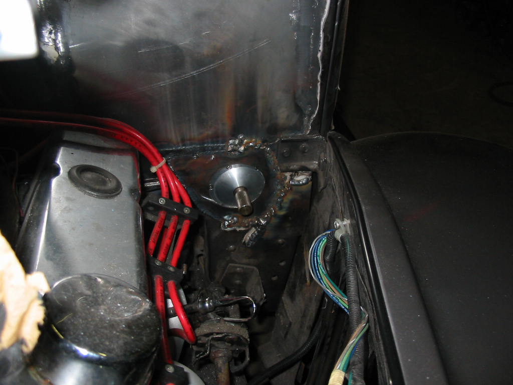

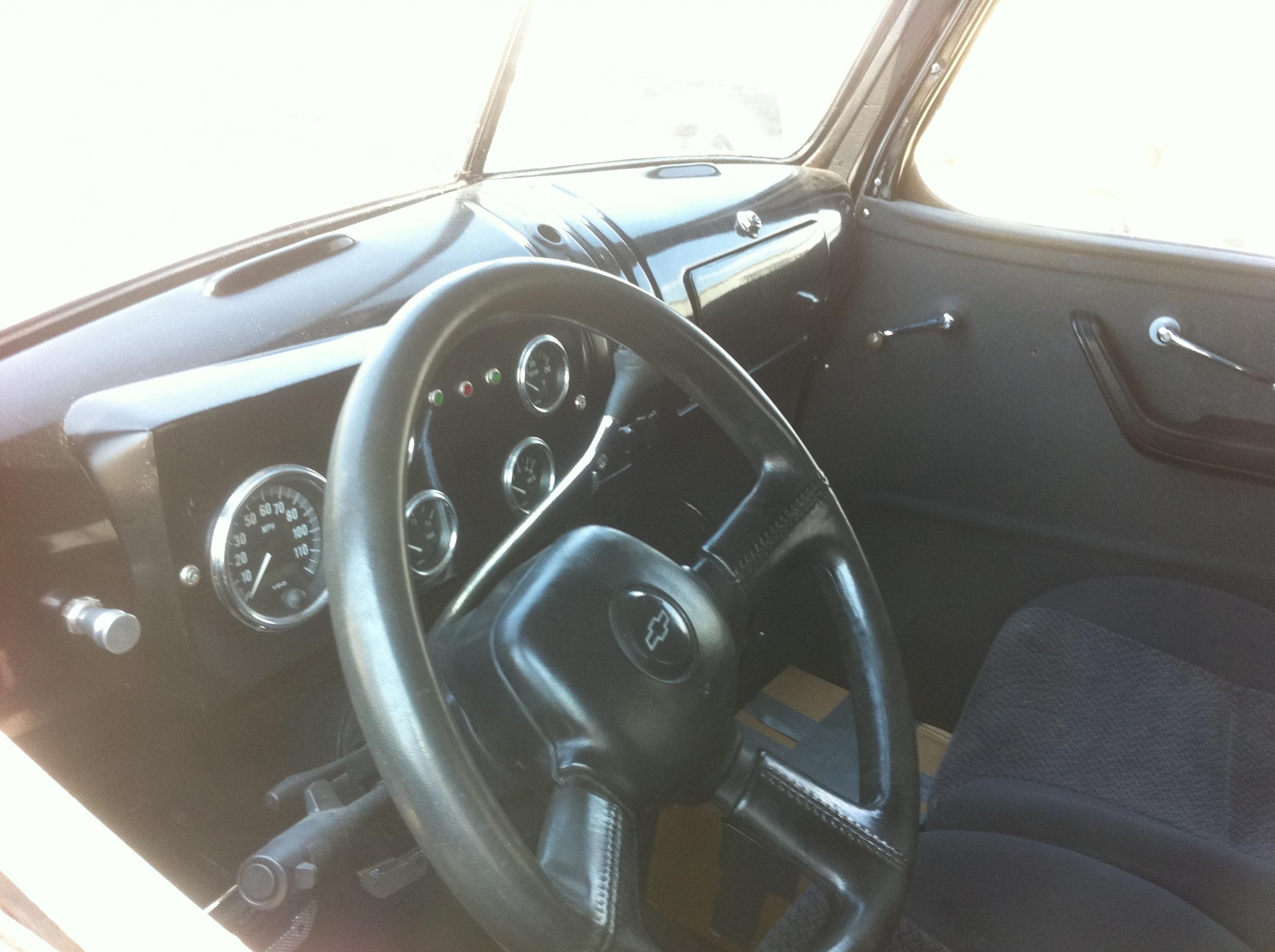

    I am a big guy over 300 pounds. So my little 47 Chevy truck was a tight fit. My builder Paul Kilcrease fixed that with a chain drive on my steering. It has a shorty Ididit column straight to the dash. So the dash got ripped out and a new one is being built. Paul does nice work. The chain drive was purchased from Speedway Motors. I could not find one on Jegs or Summit Racing.

    Here are the pics from before.

    The engine compartment is small. So to bypass the headers and raise the steering column the chain drive was necessary. I measured it and now I have as much room as my Yukon. Not as much leg room though. It looks really safe and solid to me.
    The old column was out of a S10. It was worn out and poorly installed. This seems a lot better. I can't wait to drive it.
    BY the way I think these are smaller than the 52s. The column comes pretty much straight up. Now it is more horizontal like a modern truck.
