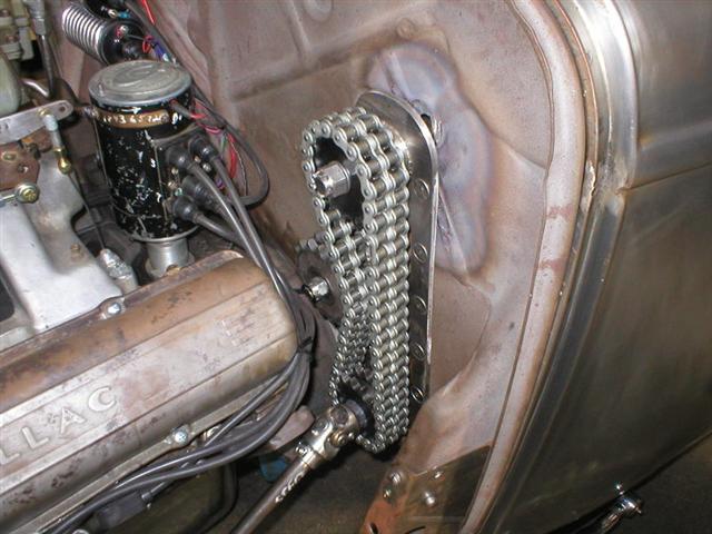

    I saved this pic from somewhere:

  5. kduke54
    Joined: Aug 4, 2011
    Posts: 29
    kduke54
    from Plano, TX
    This chain drive works perfect or a little better. Gives me twice as much room. Looks great. They need to approve this it is a much more natural driving position. The extra comfort and the quality of the product makes this truck much safer than before.
    I love it.

    That's been on the market for quite a few years, and I never heard any complaints. I'd guess the "chain" is one made somewhat like a timing chain. And those can take quite a beating, considering the constantly changing load on it.
    GM used a similar style chain drive between engine and trans, for the front drive Eldo and Toronado models. Think "Timing chain on steroids".

    People that owned these trucks when new must have been "MIDGETS"! If i wasn't using a "quick release" on my steering wheel i would use this system. One thing to consider is the force to make it fail would most likely be fatal to any occupants of the vehicle

    The Steer Clear product is very well made. I think it would take a big hit and still be functional. It is completely sealed.

    hell big trucks were driven by a chain, hell you could even do a set up for steering with a gilmer style belt and it would be just as strong!
  22. Yes, chain steering has been around a long time. I was at a Steam Tractor threshing bee a couple of weeks ago. I think most of the steam tractors were built the teens and twenties. They are really big pieces of machinery.Some of the other tractors were huge and the had reciprocating engines. They are about 20 feet high. Avery was one of the manufactures.
    They all had chain steering. The front axle could pivot horizontally and vertically. The steering chains were connected to the ends of the axles. The chain ends were connected to a large shaft. when the shaft turned one chain pulled and the other chain unwind-ed. This steering principle was also used on old Soap Box Derby cars except they used rope and a wood dowel.

    My coupe shares space in the body shop with another 34 five window. It has a big block chevy and the owner uses one of those steering chain drives. His appears to be a shop-made unit and I've spent some quality time investigating his installation. It moves smoothly and solves a plethora of space and steering shaft-angle problems. After reading this thread, I'd feel totally safe using one in my car and if I run into space problems [Pontiac engine] I just may buy one. I could build one but doing so would be kinda like re-inventing the wheel IMHO...

    Speaking from my 30 + years as a mechanical engineer I see absolutely no problem using a chain. The only requirements I would want are 1) that there are outer semicircular and side guards to prevent the chain from coming off of the sprockets,2) that there be a spring loaded chain tensioner, and 3) that it be a double roller chain of the correct size to handle the torque.

    As an engineer, surely you understand that the side with the spring-loaded tensioner would slacken and allow the tensioner to move within its range of travel when the rotation of the steering shaft/sprocket causes the chain to "tighten" on that side. Thus you'd have the slack to take up before the steering would actually take effect at the rest of the steering mechanism (box or R&P, steering arms, etc)
    Reactions at the steering wheel when a tire hits a bump or car movement inducing a feedback motion would also be unequal; one direction would feel like a conventional setup, the opposite would be quite different; taking out the slack first and then the steering wheel moving.
    An adjustable, but "fixed" tensioner would remedy that situation; allowing slight adjustment for wear.
    A fixed shaft centerline based on the chain/sprocket combination would be the preferred method. Shaft centerlines for specific chain/sprockets can be found in major mfg's books.

    My 32 has a chain drop box built by a machinist who owned the car years ago it has no slop as it has an adjustable tensioner shoe on one side. the sides of the machined aluminum box are fit so the chain cannot come off the gears for any reason and the chain and sprockets are large enough to handle the load, it drives perfectly and gives no troubles .
    It gives me plenty of leg room and clears the big engine real nice I wish I could take credit for it but it was that way when i bought it.
    Traditional is important to me but takes a back seat to function and safety
    chain drop steering boxes are sweet

    How about using the same style of case but eliminate the chain and use only gears? Use a series of meshing gears (also known as spur or straight-cut gears?). An odd number of gears (3,5,7) in series would give you the same direction of rotation at the column and at the steering box. The same size gears throughout would give you a 1:1 ratio. Slide a different sized gear in and you can change the ratio and the steering speed.
    I've never seen it done but I don't know why it would not work. It would give you the same result but without the fear of the chain stretching or breaking.
