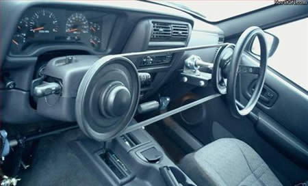

  29. metalshapes
    Joined: Nov 18, 2002
    Posts: 11,130
    metalshapes
    Yeah, Rube Goldberg engineering is better than messed up geometry..:)
    Maybe you guys should look at this nifty V-belt setup.
    Probably wont hurt your fingers as much as a chain, when you get them stuck in it... :)
