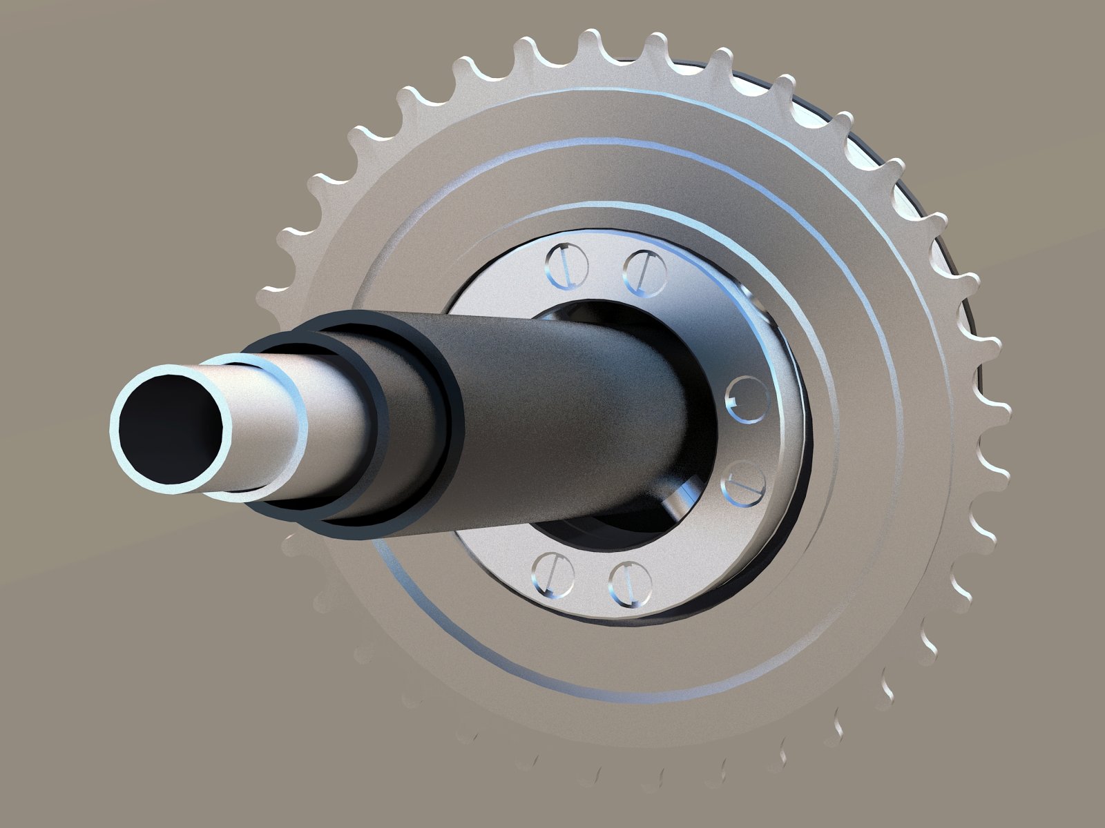

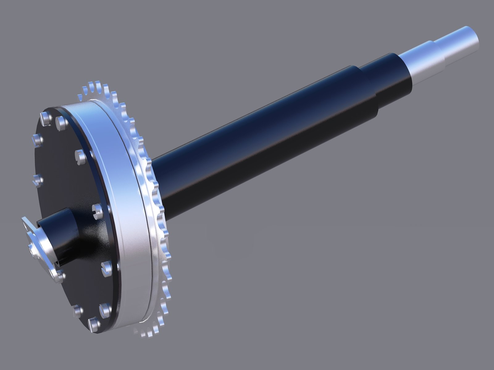

    I've been walking around with steering on my brain for almost a week. It took a branch into rack-and-pinion setups, which aren't really germane here, before coming back to designed-in chain-drive quickeners. I have a thing for controls on the steering wheel hub, and a steering column driving a camshaft sprocket could easily have all kinds of things running down the middle of it. Only thing is, that would require the chain to run perpendicular to the column, and if the column is to be, say, 15° from the horizontal I was going around in circles thinking chain vs. my feet; chain vs. firewall; chain vs. back of engine — though of course this is all hypothetical and meant to be adaptable to all kinds of different builds. The chain really wants to be parallel with, and just behind, the firewall.
    Perhaps I just couldn't think of the right search terms, but I couldn't find anything online like an annular Hooke joint, i.e. a U-joint with a constant hole that runs straight through the middle. It's surely possible: all it needs is for the spider or cross to be formed as a ring, and one of the two yokes as a bigger ring that goes around it. But surely it can be engineered, and quite probably far more simply and easily than what I ended up 3D-modelling:
    The last one was like a ten-hour render, for some reason. I didn't go crazy like on my epicyclic-geared wheel-reinventing exercise of two years ago: just levers for throttle and spark, and space for a wire to the horn switch down the middle.

    Why bother, just clock the rack so the pinion is horizontal , then use 2 x Toyota Hiace Van 90° steering boxes. to "Z" it up the firewall
    You can add a universal to the upper column for steering wheel angle.
    Already tested and approved by Toyota
    I would certainly trust this more than a funky chain drive steering

    Ned Ludd
    Why not?
    1. No opportunity for controls down the middle of the steering column
    2. No integral quickener
    3. No opportunity to reinvent the wheel :)

    What's the diameter of the input and output shafts? You're suggesting rifle-drilling a ±20mmØ hole down that and out through the cover plate?

    My above idea could be simplified by using a CV joint instead of a specially machined Hooke joint. Very many CV joints follow this pattern:
    Unfortunately, this is the kind of thing on which it's impossible to find a lot of hard information. Spline counts are common enough, but these are metric splines which don't have a standard ratio of spline count to shaft diameter. I was only able to find a handful of actual ID dimensions, enough to suggest that 28mm is a very common major diameter but little more. You'd have physically to measure dozens of CV joints individually.
    If it's 28mm I'd have to adjust my concentrics downwards, and the wheel hub controls might become a bit springy.
    Edit: I found a useful Australian site which turned up several possibilities, mostly VW, Toyota, and a few Mercedes-Benz, with a major diameter around 32mm, which would suit my original concentrics perfectly.

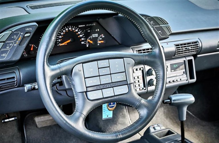

    What are you controlling that needs to be hard wired? How do the OEM's do it?
    Surely Pontiac had this figured out in the 90's.

    I've got a thing about no-code builds. I like to treat electricity as OEMs did pre-WWII, i.e. not necessarily there when you need it. I even spent a few weeks daydreaming about non-electric means of starting an engine.
