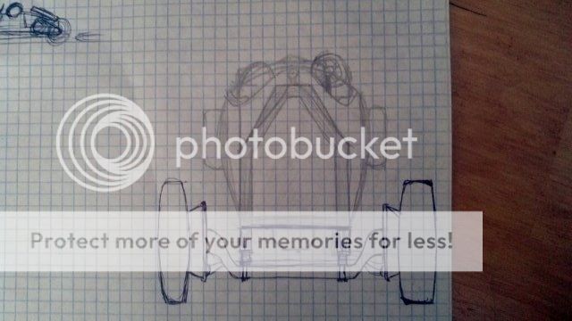

    Hey guys, I've been dreaming up plans to make my own hot rod from scratch. I wanted something different, though., so I thought, "What about chain drive?"
    So it's this: Engine to ******. ****** to driveshaft. Driveshaft to rear axle. HOWEVER. This axle, although totally normal, is bolted rigid to the frame at frame height. Where a tire would normally by would instead by a sprocket, mounted like a tire.
    From there is a chain on each sprocket to another sprocket. This sprocket is located around the drum. This axle is a trailer axle of sorts (or even a welded front axle). It has to be of some age too. In other words, the drum needs to stick out from the tire, like the old wood-spoke wheels, perhaps.
    The question everyone asks me is whether or not the differential will work. I say it shouldn't make a difference whether or not the tire is physically on the rear axle, instead there is a transaxle (normal rear) which leads to a trailer axle (which allows each wheel to spin independently of each other if there was no chains). I think when the wheel meets resistance trying to turn left for example, the differential will operate as planned. I'm also fairly certain that this is how the old American laFrances worked, too.
    I drew up some quick plans one day in some free time:

    It would probably work but I wouldn't want to run a lot of power through it. Maybe a small four banger.
    The easy way to do it would be to run the brakes on the differential that is bolted to the frame and then bolt a drive sprocket to the drum there. Then have the driven sprocket attached to the hub for the wheel. The whole thing is going to have to look 1910 when you are done though.
    On this kind of deal farm equipment supply houses are your friend as they have the sprockets and chain you would need along with all sorts of hubs and axles. A s**** yard for farm equipment might even produce the axle you need with the sprockets already on the hubs.

    It appears the purple bucket has a irs/swing axle setup and that is something to consider. A chain drive to the outside of a of a straight axle will want to toss, wear, break chains and sprockets as the axle articulates and the chain stays straight, especially in a short run of chain. You'll need tensioners and guides to keep it all together and you'll still want to carry extra sprockets/chain and master links with you.

    If the front mounting point of the rear axle is close to the mounting of the driving sprockets than the motion of the rear axle will be close to the same as the chain. Chains should be run slack anyway. And the bigger the links the better to handle the difference in angles when the suspension articulates.
    This was done for years and years on big trucks. And br*** era cars. Put the brakes on the rear axle so when a chain leaves, you still have brakes. and the braking force doesn't go thru the chain.
    The Thomas Flyer was chain drive and went around the world.
    And you got a built in quick change, too.
    A modern version might use blower belts. They run slack also. Or with a spring tensioner to keep the right tension.

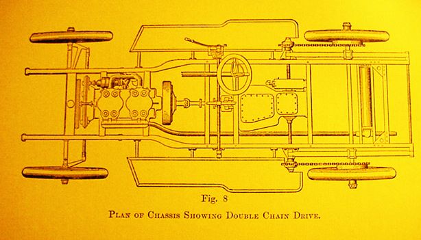

    Really "Old School" here is an illustration from a 1909 textbook. Bob

    This is great. I love old diagrams, and I love the fact it is RHD with the shifter on the right. I would love to do that on my own build too someday, but that seems very difficult to accommodate on today's transmissions.
