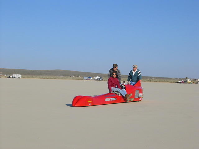

    Car shown is it's cl*** record holder at 352.525 mph. It is chain driven. Chain life is very short. But when it works, it works good.

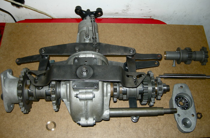

  4. CutawayAl
    Joined: Aug 3, 2009
    Posts: 2,144
    CutawayAl
    from MI
    Honda addressed that problem by having independent trailing arms that only pivoted vertically.

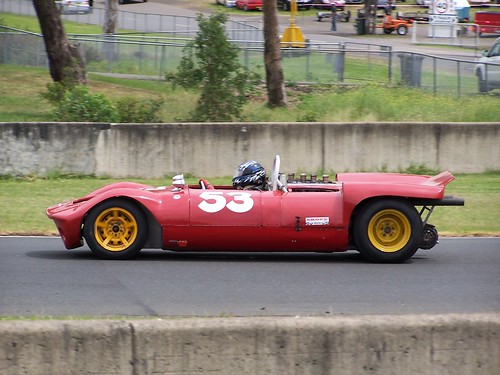

  6. 97
    Joined: May 18, 2005
    Posts: 1,983
    97
    The Stanton Corvette has been racing in New Zealand since the 50s. It is a space frame with a flathead diff and chain drive behind a corvette engine. It's fast and reliable.It was a winning car in it's day and is still compe***ive in vintage/cl***ic/nostalgia racing in New Zealand and Australia.
    Stanton Corvette by racin jason, on Flickr

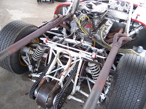

    Chains probably work fine on clean race tracks when they are replaced often. The chains would get destroyed on city streets pretty quick. I'd also like to see what the car look like after they lube the chain and run it for a little while.

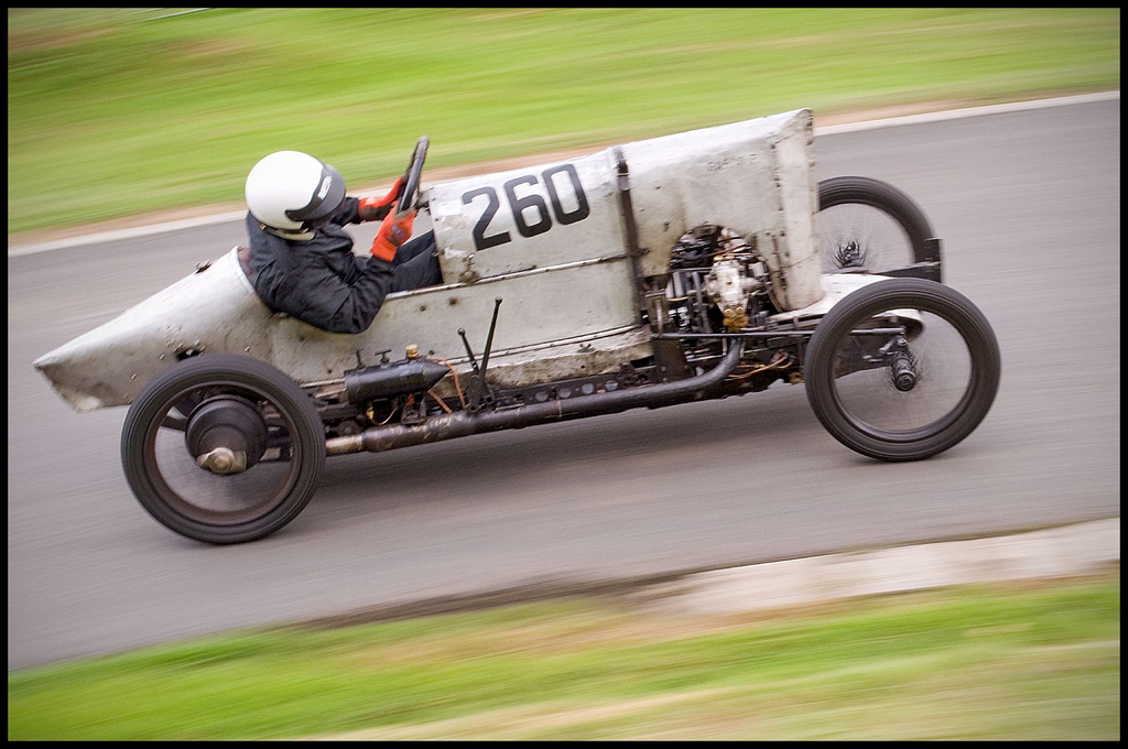

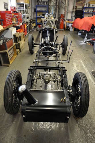

    Anybody ever see the movie "Kelly's Heroes" with Clint Eastwood and a**** many others...Donald Sutherland? i like how Sutherland's character is always countering the naysayers by saying something like "enough of the negative vibes baby".

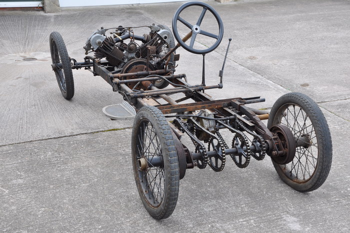

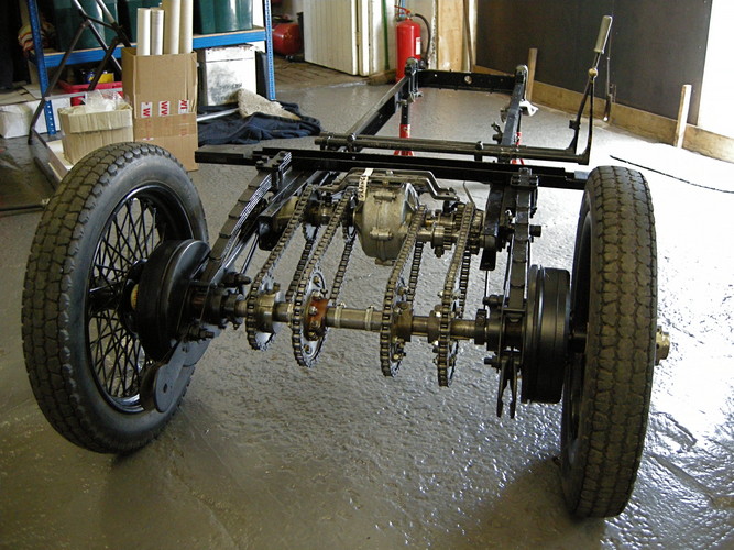

    Here are some GN and Frazer Nash images thanks to Hary Hall restorations.
    Oh yeah....enough of the negative vibes babies!

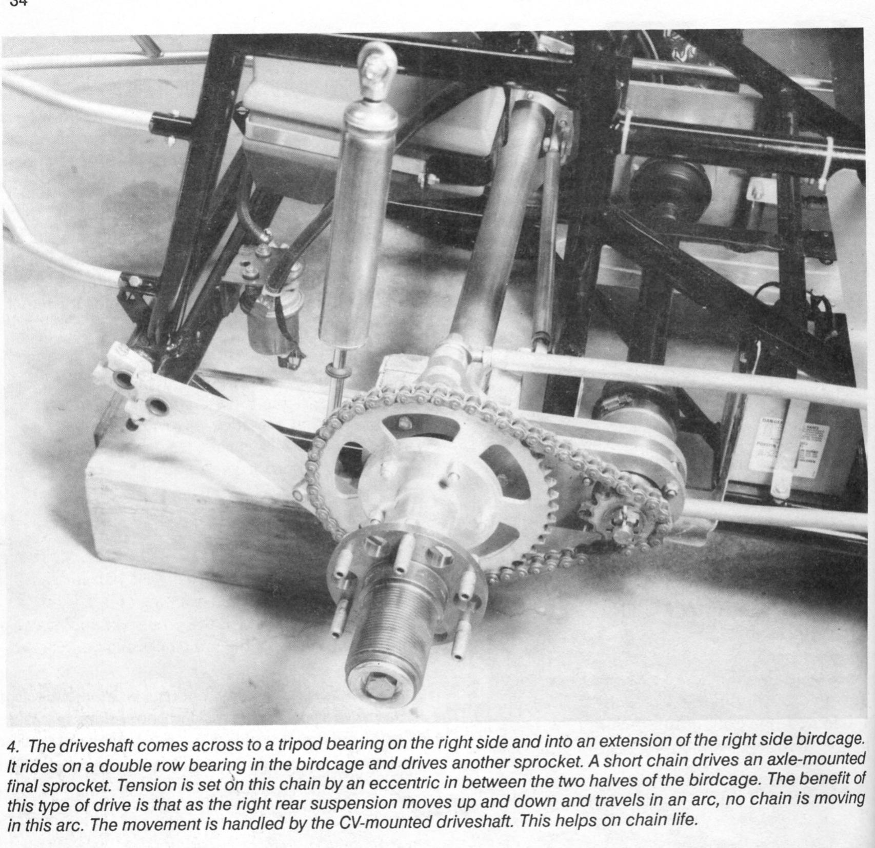

    Additional info in posts #24 and #34.

    That takes care of the articulation problem.
